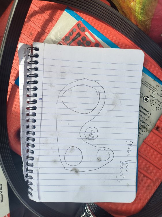

  8. I answered my own question guys. I wrongly re routed the drive belt like an idiot. So those two part numbers I've referenced are interchageable. Please see my crude drawing below - hope this helps anyone stuck in a similar pickle in future! Regards,
  9. Hi all, Has anyone come into an issue when replacing the drive (serpentine) belt? I have a 2015 Fabia and the belt itself is 6pk1078 though everywhere is selling 6pk1080. I have tried using the latter today, and it's squealing terribly. Just wanted to get other people's thoughts on this predicament? As I wouldn't have thought 2mm would make such a difference.
