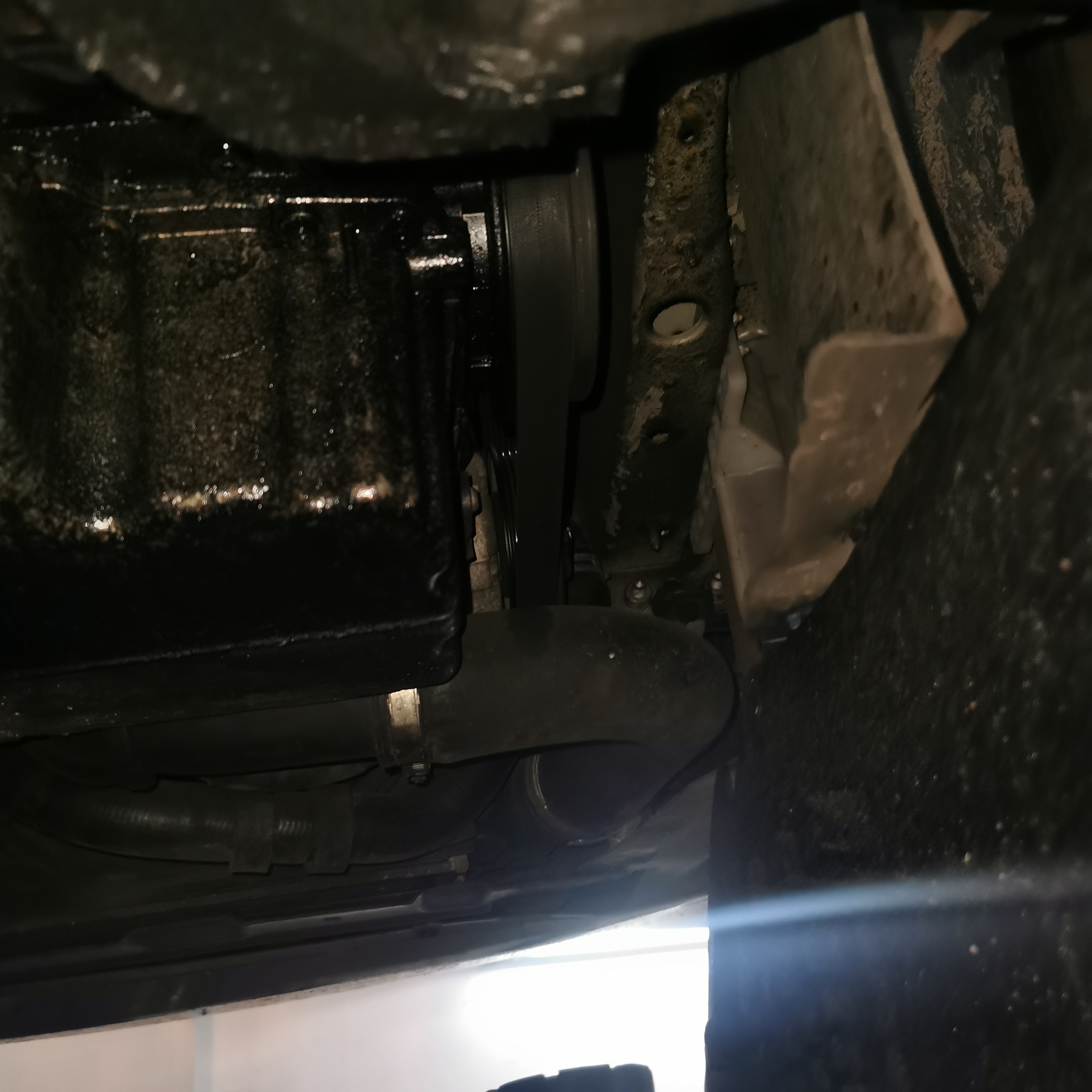

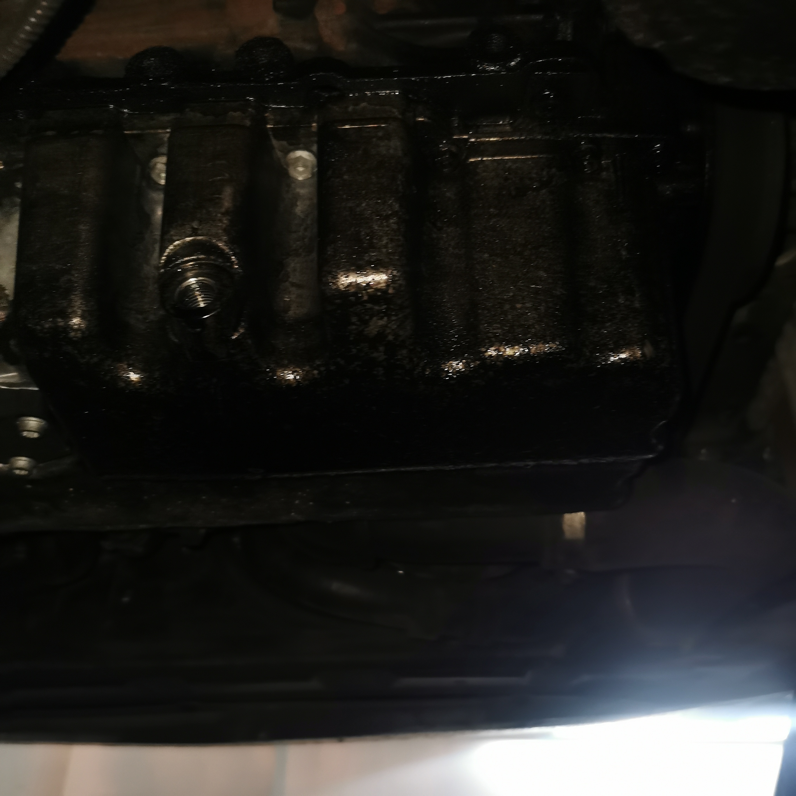

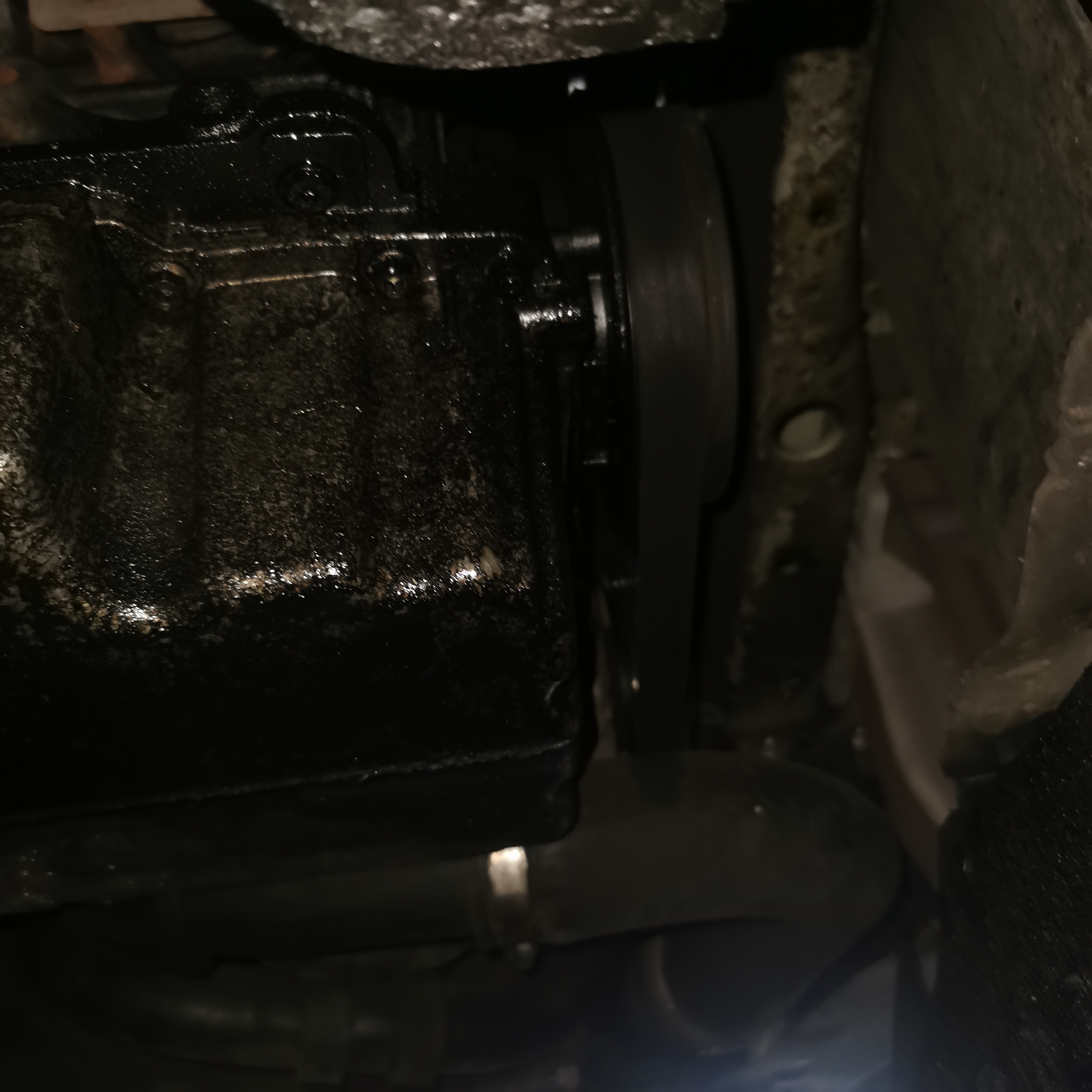

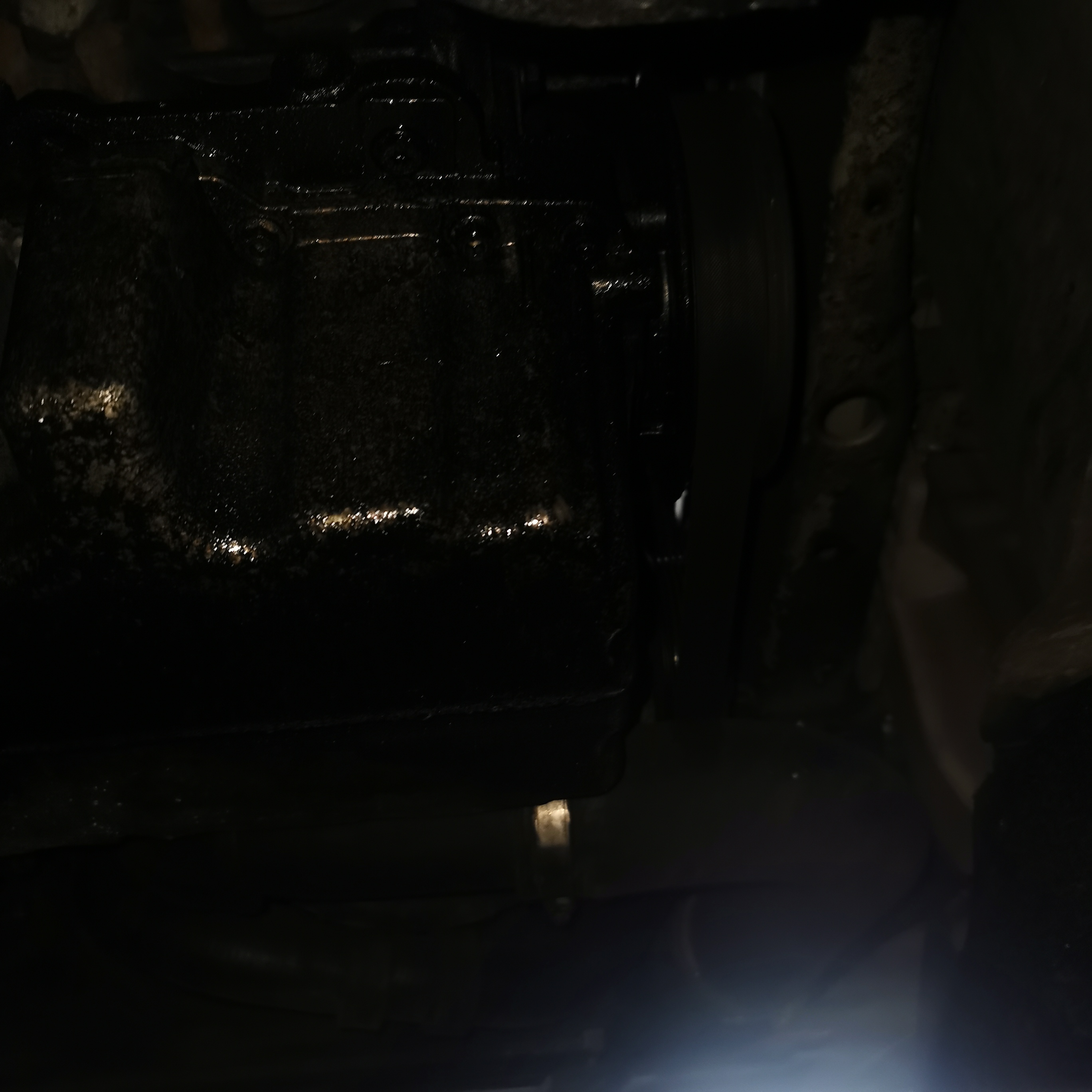

  1. Thanks I've spoken to mechanic. He said he will steam clean the whole top and bottom of engine which comes at a hefty £50 charge but will check after a couple of days after cleaning to see where it's coming from. I'm dreading it's the crankshaft oil seal or something more sinister.
  2. Oil level is not dropping. Belts are dry. It's an automatic gearbox dsg. Thank you
  3. Really unsure to be honest. The belts are not wet but it's in that direction. I don't think it's the sump as I looked at it and didn't seem like the sump is cracked or leaking.
  4. I just done my MOT and it was advisory minor oil leak. I went to garage to replace anti roll bar link and garage spotted major leak. Any idea what it could be. It's a 2015 dsg Skoda superb
