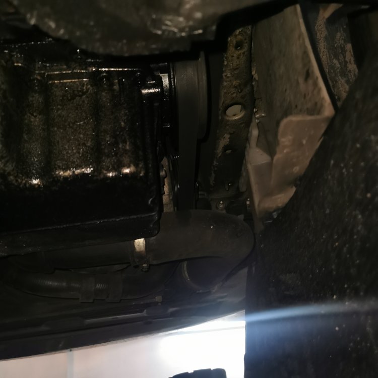

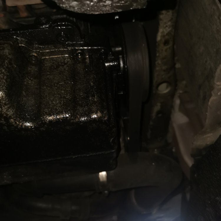

I just done my MOT and it was advisory minor oil leak. I went to garage to replace anti roll bar link and garage spotted major leak. Any idea what it could be. It's a 2015 dsg Skoda superb

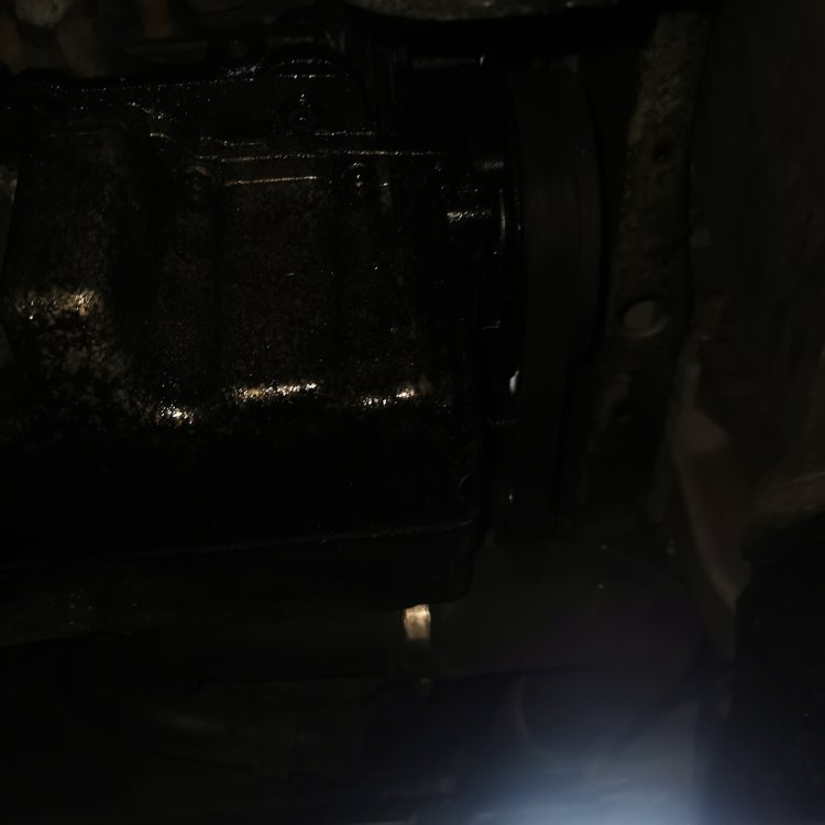

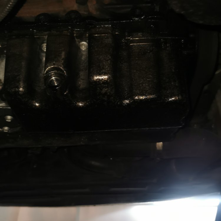

Hello Shasha, not enough light on those images - that looks like the engine sump - or is it the gearbox casing?
Really unsure to be honest. The belts are not wet but it's in that direction. I don't think it's the sump as I looked at it and didn't seem like the sump is cracked or leaking.

The position of the drive belt would suggest engine sump rather than gearbox casing to me, but difficult to tell with those images. Is the engine oil level dropping? What gearbox do you have?
As @andrehj suggests, get the area cleaned up and have a close look around everything.
Oil level is not dropping. Belts are dry. It's an automatic gearbox dsg. Thank you

Thanks I've spoken to mechanic. He said he will steam clean the whole top and bottom of engine which comes at a hefty £50 charge but will check after a couple of days after cleaning to see where it's coming from. I'm dreading it's the crankshaft oil seal or something more sinister.
Depending on which model DSG gearbox you have, if the oil is coming from there, rather than the engine, you could have a major problem very quickly.
