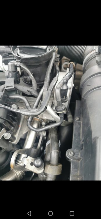

Hi I found one of the thin pipes of the turbo was twisted, I untwisted it and it never had a problem ever again. All mechanics and specialist etc etc saying replace the turbo I proved them all wrong. It's the part in the pic which is lightly marked. Just make sure there is no twists or turns in the pipes and they all look they sat the way they should and not forced they should all look relaxed the way they should be.
