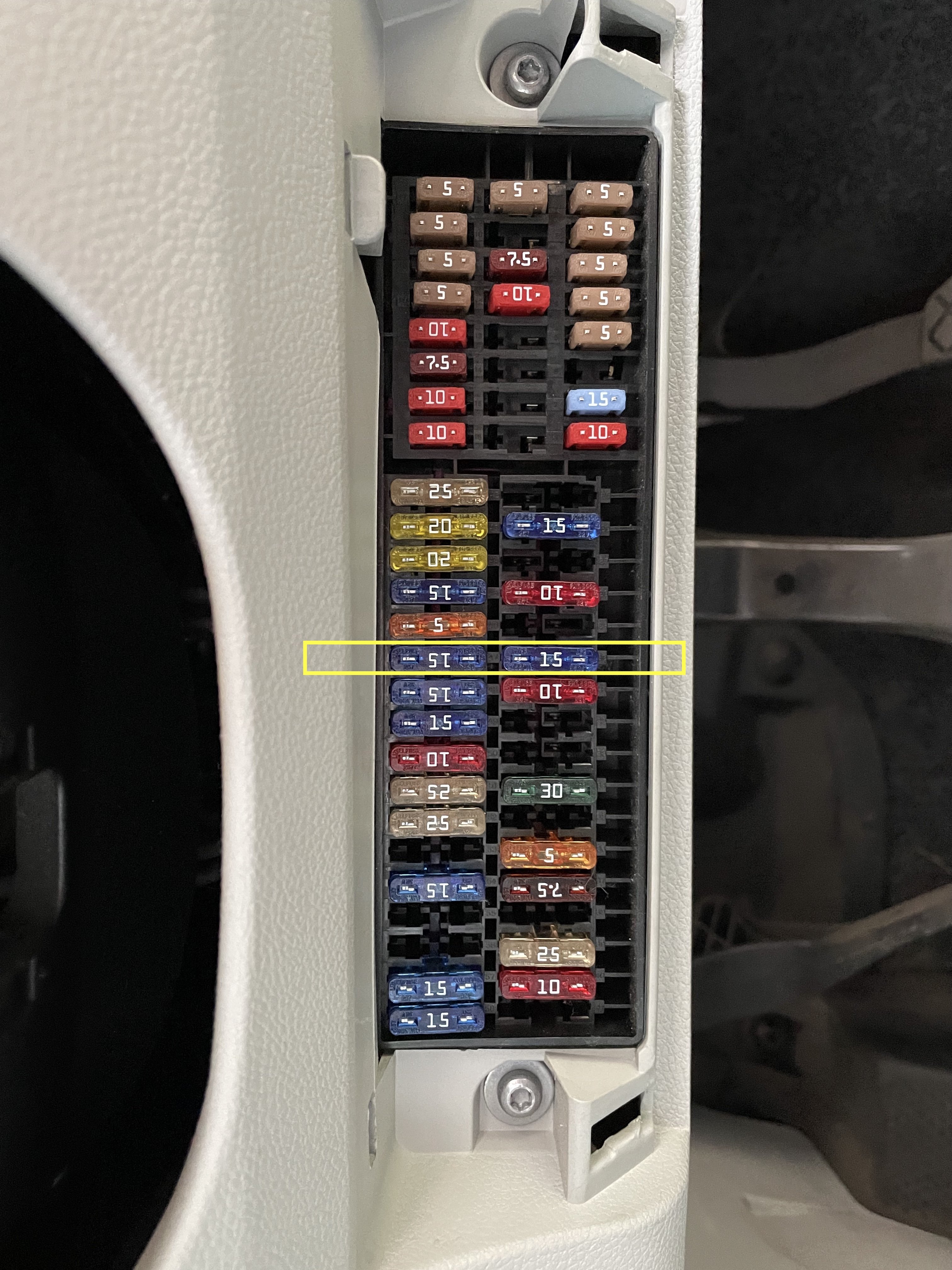

  4. Yeah I did think, in general I can see why it's this way around. I'll have a look at this and get a photo of the fuses posted, I was hoping that there might be a simple solution like this tho.. shifting a fuse in to a different route or something.

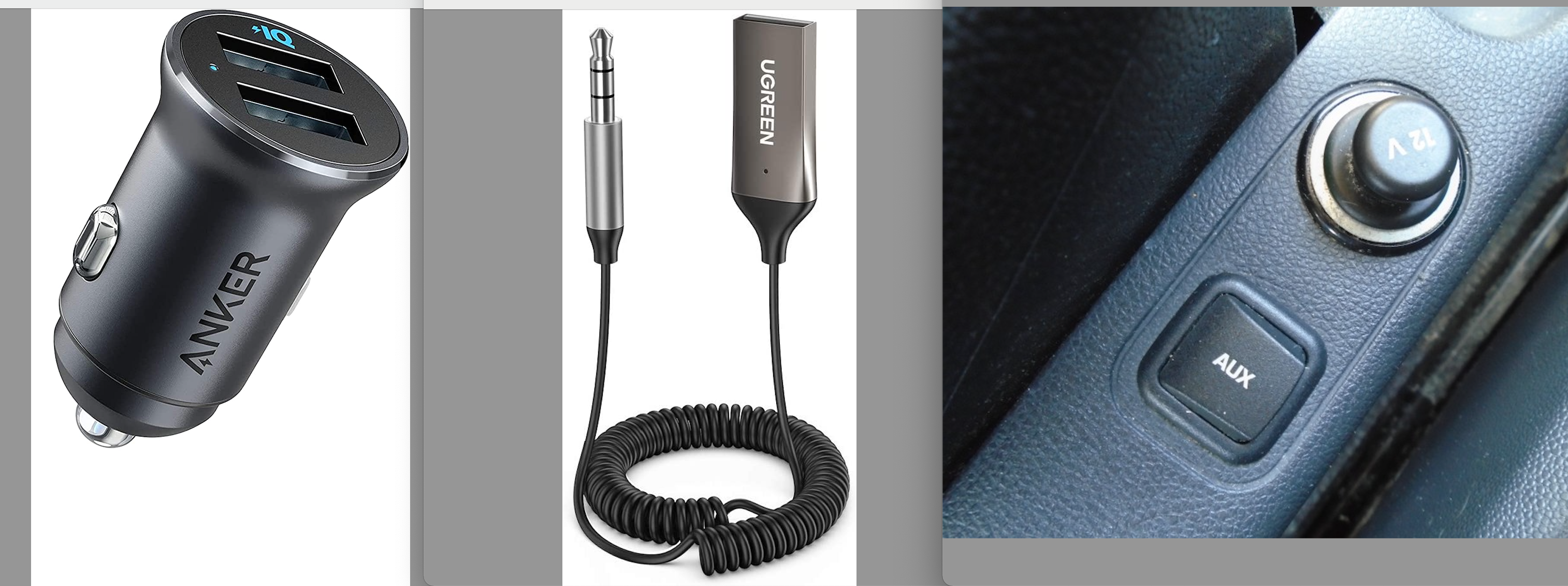

  7. We have a Fabia mk2 1.4 2007. We recently plugged in a basic 2 port Anker USB car charger for charging phones and the like. Also to enable some basic music playback via bluetooth we added a UGREEN Bluetooth aux adapter which uses one of the usb ports and plugs directly in to the audio aux next to it. This setup is working great, really pleased with it, the quibble I have is: The auxiliary power port seems to be always on. Im not hugely concerned about this from a power consumption point of view. Because the bluetooth adapter is always on it seems to have connection issues with our phones if we leave the car and come back to it. We often pull the usb adapter out and plug it back in to power cycle the bluetooth adapter which forces it to reconnect to our devices. The ideal scenario here would be that the auxiliary power port was linked to the ignition. To that end I return you to the original question in the title of this thread. Can I switch the auxiliary power port to only come on when there is ignition?

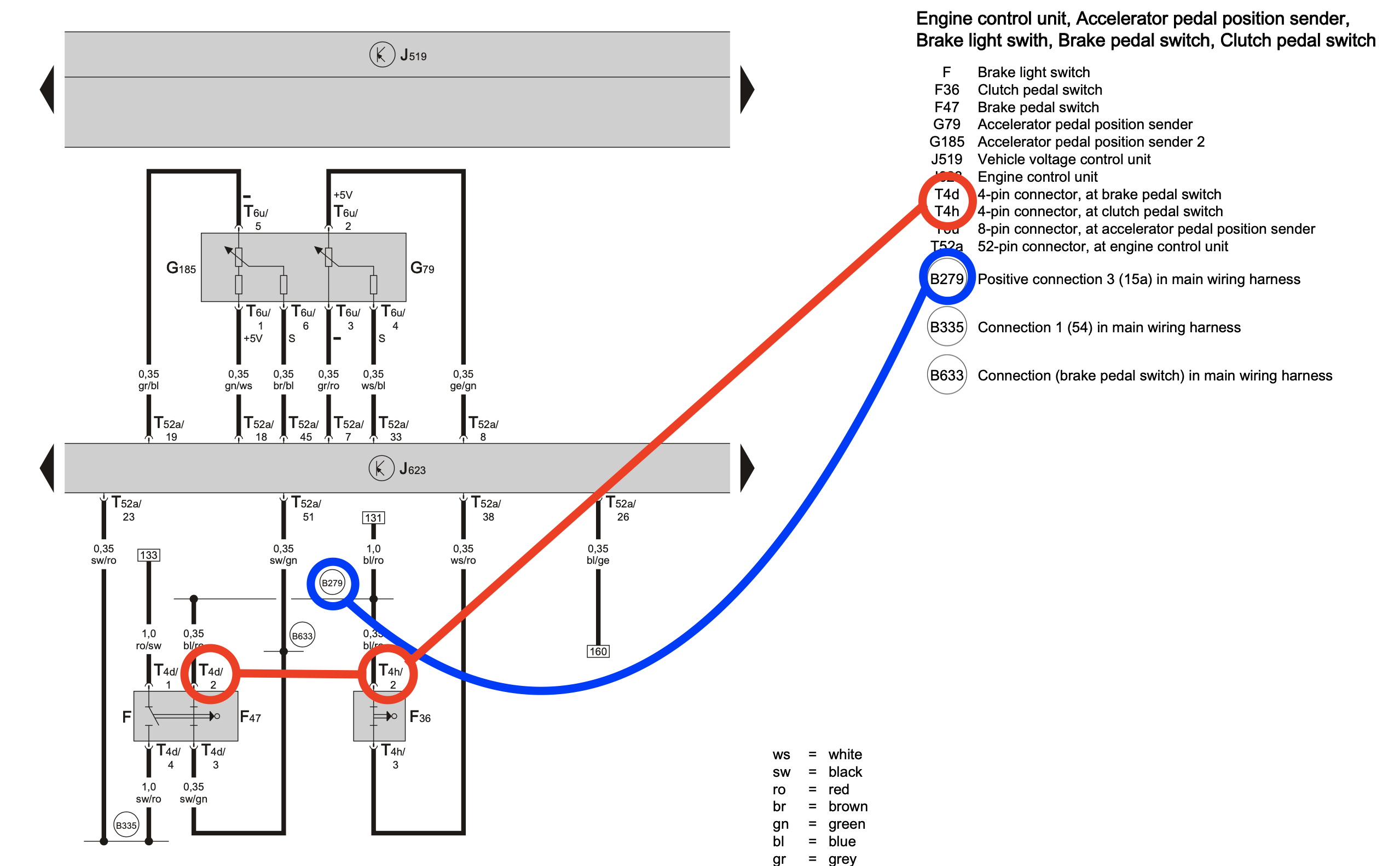

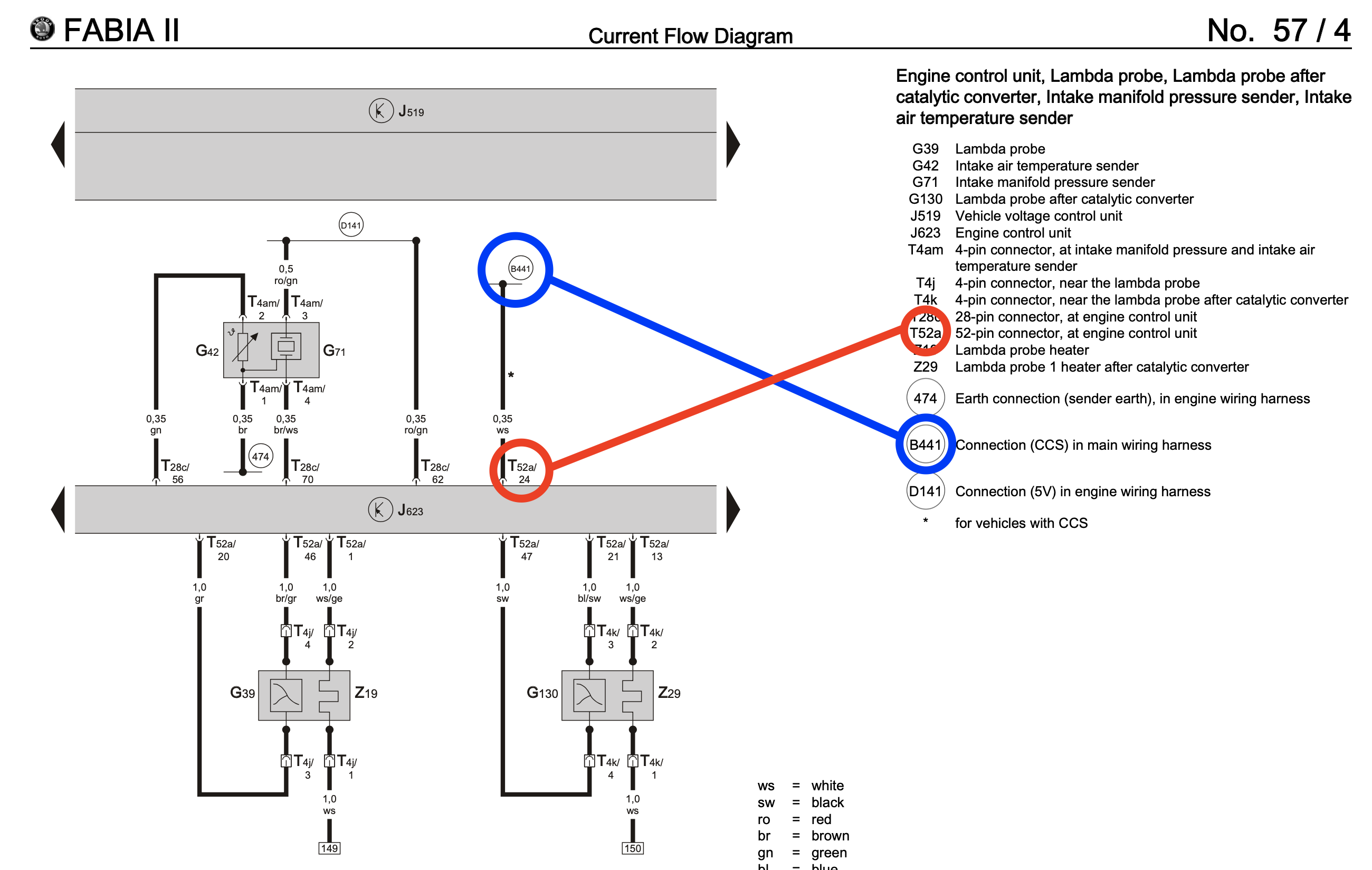

  9. Think I've traced where these can be connected at the ECU & Brake/Clutch pedal. B441 -> T52a/24 (52-pin connector, at engine control unit) B279 -> T4d/2 & T4h/2 (4-pin connector, at brake & clutch pedal switch) The B279 node is a little confusing tho, Would make sense if it's just a shared power rail? Maybe thats why it's "Positive connection 3 (15a) in main wiring harness" Are these nodes easy to find under the bonnet, or would it be easier to make the connections at the pin connectors i've traced?

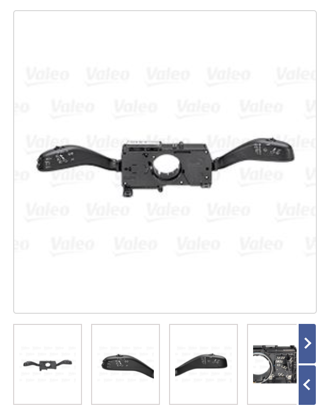

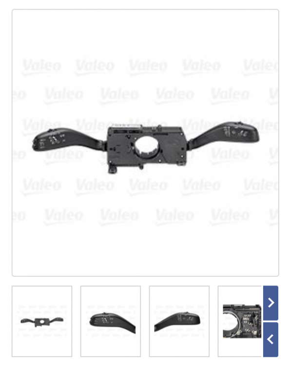

  10. Thanks for all the pointers, this is really helpful ๐Ÿ™Œ I have found some more switches that look like the ticket for your approval: https://www.autopartspro.co.uk/valeo-9382437 I've only found a loom for a mk1 so far, if it's similar I may be able to mod it tho it might be simple enough to just make one anyway. Does that mean it needs to be spliced in to the loom? Do you have a link to any guides you know of or exact splicing locations? Any tips for where to look for looms to buy? Thanks again.

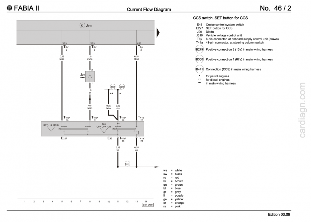

  11. Looks like there are a few connections i need from the 41-pin connector at the steering column switch to the main wiring harness: T41a/28 -> B279 (For Petrol Engines) (blue/red) T41a/26 -> B441 (white) T41a/29 -> B441 (white) Then there are three back to the 6-pin connector at the onboard supply control unit, one with a diode. T41a/27 -> T6y/2 (blue/white) T41a/30 -> T6y/6 (blue/yellow) T41a/31 (blue/green) -> J29 Diode -> T6y/5 (black/red) Questions: Is this the correct diagram for my vehicle? and am I reading it correctly? Where do the three connections heading for the main wiring harness (B279 & B441) connect to?, I can't see any pin designations. At T41a/31 the diagram doesn't indicate what diode I need but should I just assume anything that can handle 12v? @Tech1e having done this before, is this accurate? Anything I'm missing?

  13. WezFab replied to WezFab's topic in Hellos and Goodbyes

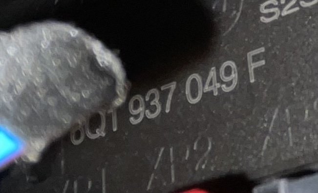

  14. Looks like i've got a 6Q1. So next steps are.. - Get some new switches and wiring for the ECU? - Find someone with VCDS to switch on cruise?

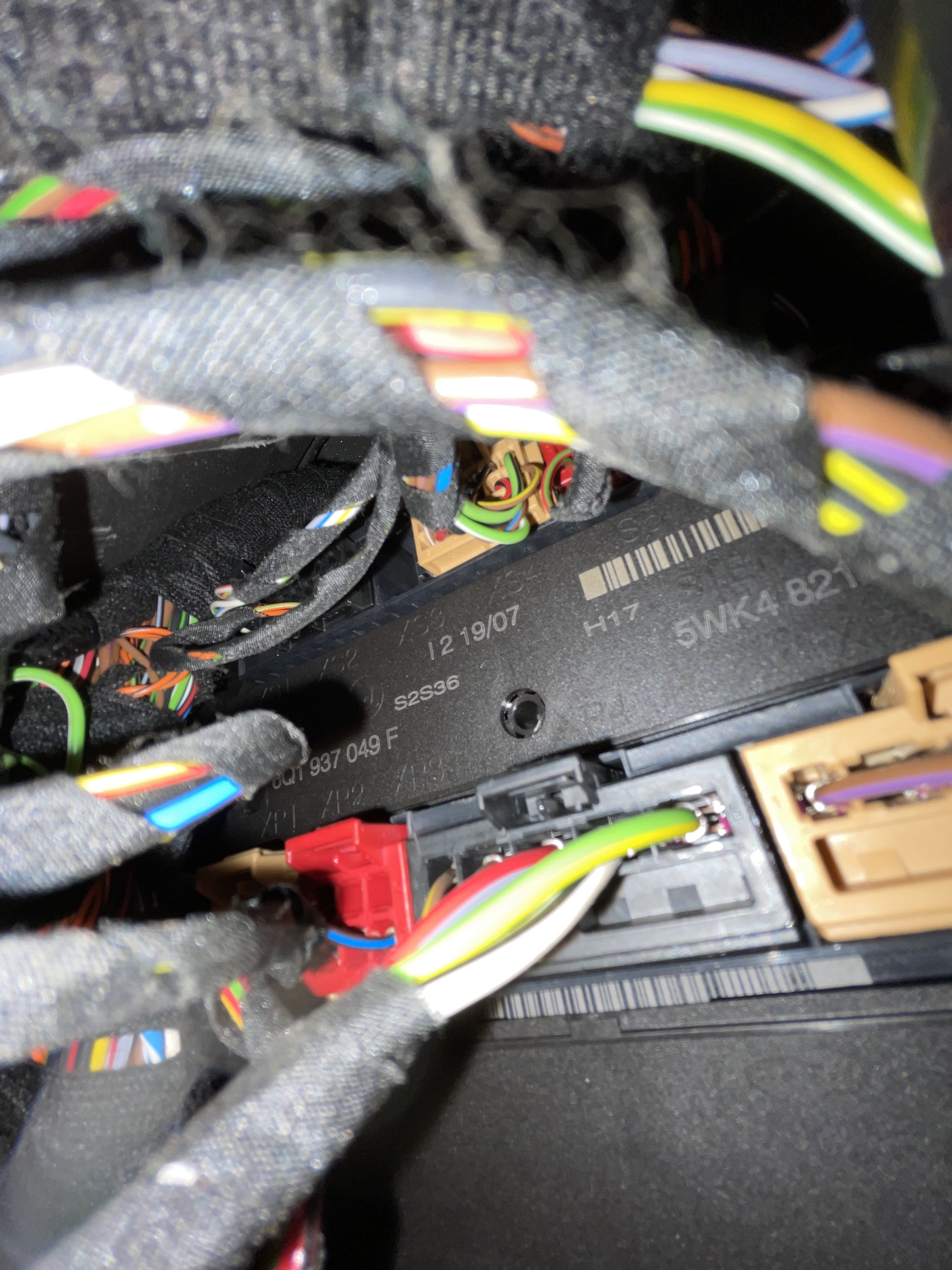

  15. Thanks for the pics, the one with wiper stalk attached deffo looks like the one in our car. I think i'd seen another thread somewhere that suggested this new style only came in on later models 2012 or 2015+ more incorrect info ๐Ÿ˜ซ I'll have a rummage under the dash soon to see what I can find on the control unit and let you know ๐Ÿ‘Œ
