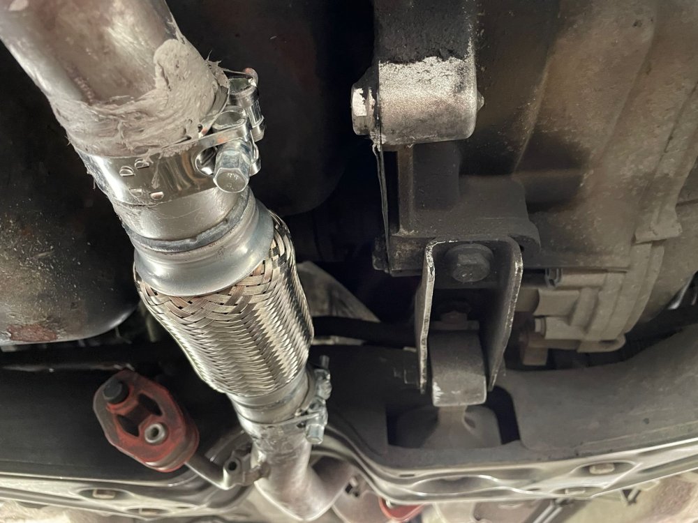

  2. Can't stress this enough, Just finished the job on our mk2 there was lots of cleanup/sanding/filing required to get the fit needed without any gaps left by the cutouts on the new flanges. I opted to leave everything in place and just cut the old one out - if anyone else does this, make sure you have access to a reciprocating saw as there is not enough room for much else to complete the front side cut. If i did it again i'd preferably have something to make the cleanup simpler too, perhaps a wire brush attachment for drill/grinder. Anyway.. managed to get a good seal with the Norma clamps and sealant for good measure, no leaks yet! 🙏 Cheers'n

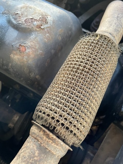

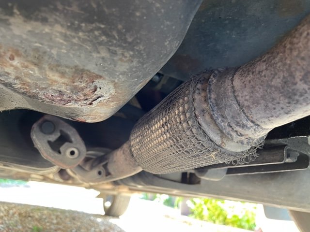

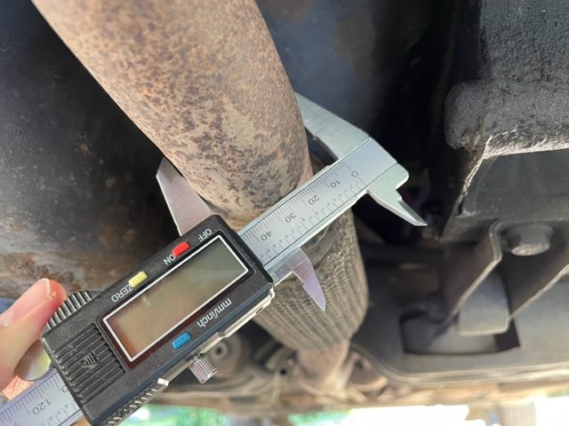

  4. Little update, decided to spray a little water on my flex joint and take a look.. does appear to be blowing a bit to the rear (aren’t we all). Got some video and pics for your enjoyment 😆 Measured up for appropriate Mikalor clamps too. Time to get busy. Video:
