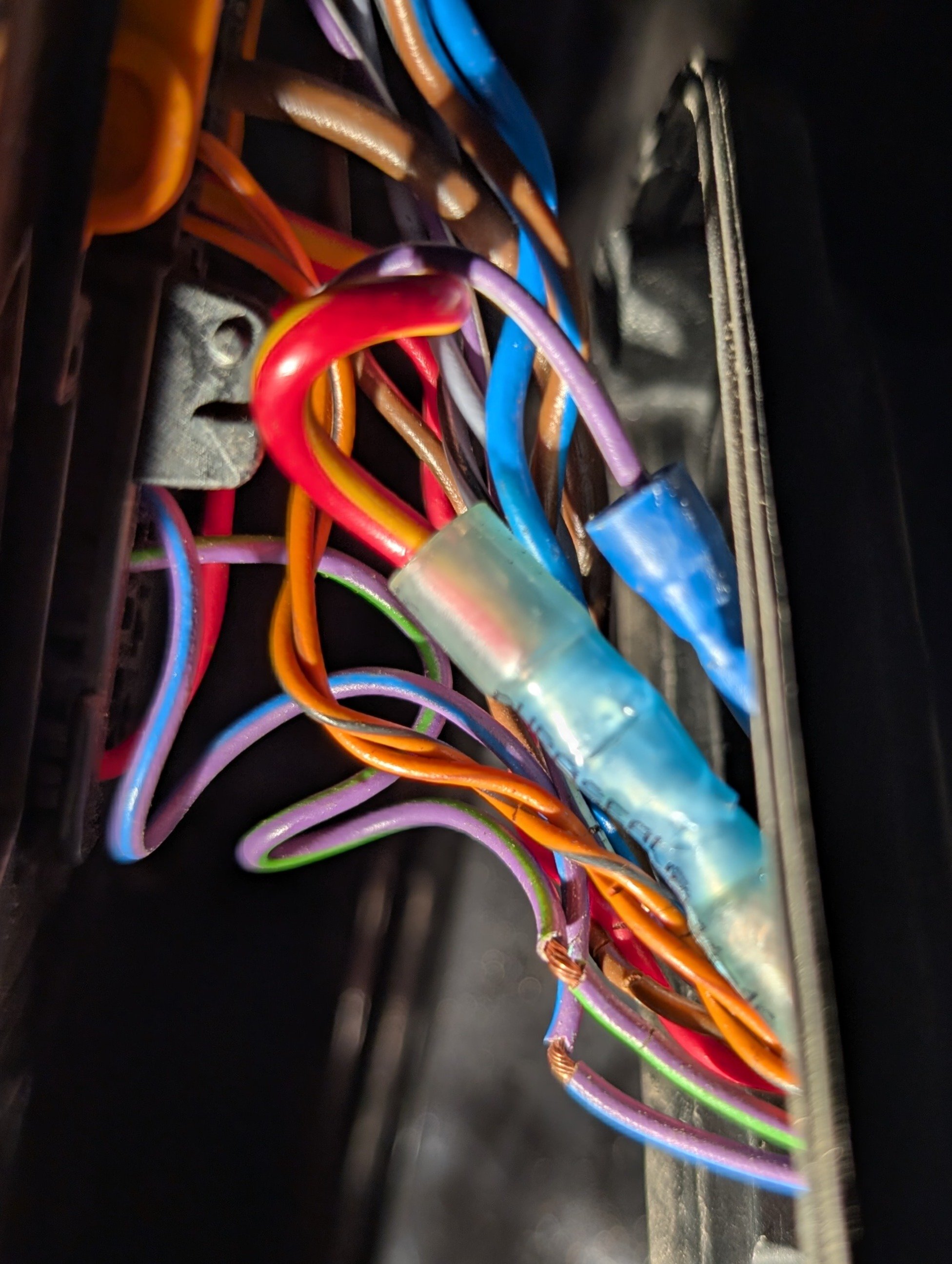

  1. So I have replaced the wiring loom for the passenger side front door, but I still have the same issue. This mostly happens when I'm close to the passenger side doors. Today when I approached the passenger side rear door it started to lock continually.
  2. Wiring loom going to the passenger door is probably the cause. I will have them replaced. 😀
  3. Thanks. I have already replaced the wiring harness on the drivers door. I will check the passenger door wiring.
  4. Kessy has started acting up on me. Sometimes the key fob doesn't work right away (but lock and unlock), and espacially for locking function I need to be out of kessy range. It has also happened several times that when I get out of the car and close the tour, is will start unlocking (I believe) continuously (with hazard lights blinking). This seems to be ongoing until I'm out of kessy range? Would a faulty door handle switch cause this issues? What else could it be? I have replaced battery in key fob, and also tried the spare key fob.
