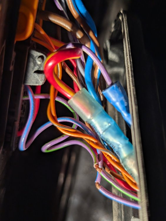

Hi, Interesting thread, for a couple of years my car has done this occasionally. Get out the car and close the door and the locking goes a bit wild, locking and unlocking maybe 4 - 5 times. Holding the unlock button on the fob seems to get it under control. It can be fine for a while then plays up again. It's been doing it a lot more recently and last weekend I repaired the wiring at the drivers door which were found with the usual broken insulation, chewed wires etc...couple of cables replaced, others heat shrink applied. Been fine all week until today and its started up again. Either my repair is failing or I'm suspicious the drivers door mechanism is faulty. I can close the door almost fully with no problems, but as soon as I click the door shut it then plays up. Suggests this is to do with the microswitches in the latch mechanism ? I'll be checking the wiring again and will also check the other doors but I'm suspicious of the latch.

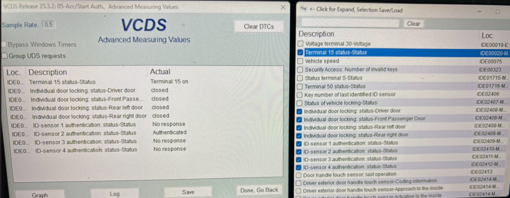

Checked again with VCDS and all doors are signalling correct when are open, closed, locked and unlocked.
Strange finding: In VCDS there are several ID-sensor (1,2,3 and 4) authentication statuses, but i have information only on number 2. Is this normal?
Here is what we monitor when i get out of the car and close the door.
In the car
Out of the car
1 second later
What i can monitor to see which actuator is wrong. Or how to read the trigger information? What triggered the lock? In the last screen the trigger code is 01 and i do not know what is this?
