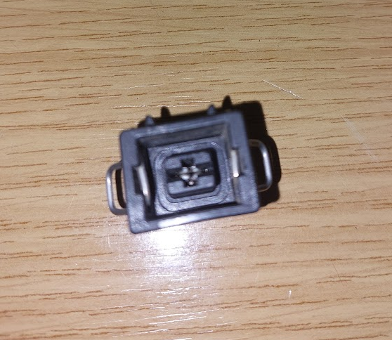

My son's 2005 Fabia 1.2 HTP developed an intermittent starting problem (no crank, no error lights). I found the wire on the starter solenoid had broken inside the insulation (apparently a common problem). On inspection the wire was very stiff and corroded near the plug. I cut it back and extended with new wire and fitted a spade terminal which cured the problem for now at least. However, I am concerned that this will vibrate loose over time as there is no locking mechanism. The OE plug had a spring clip and rubber seals to prevent water ingress. pictured below Can anyone tell me where I can buy a new plug, or how I can remove the metal crimp from the plug to rewire it?

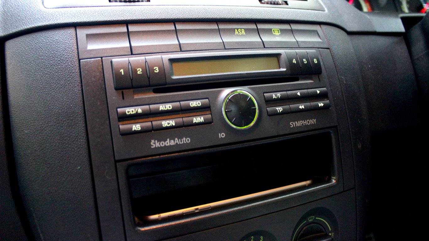

Sorry for replying to myself, but can't seem to edit posts (maybe because I'm a newbie). Not my picture but this it what the dash looks like (attached) - with the cubby below the stereo:

I'm trying to install a single DIN radio in to my son's 2005 Fabia Classic. It is a MK1 with the "facelift" rear lights which AFAIK makes it the 2004-2007 model, which fits with the reg date. The car was fitted with the Skoda Symphony radio with a pocket underneath. I have removed the radio and the plastic pocket and two small vertical trim pieces each side of the aperture. I bought this fitting kit: https://www.ebay.co.uk/itm/171596146244 It does not fit. It is the right shape for the aperture, but the clips do not line up with the holes. The clips on the left side of the new facia do line up with the clips for the small trim pieces, but the ones on the right are different and will not fit. If I refit the plastic pocket, I am left with what looks like a single DIN aperture and I just need a small trim to go above the radio to finish it. It therefore looks like this kit will work instead: https://www.ebay.co.uk/itm/171993602531 , however the listing says that this is for the pre-2004 model (pre-facelift). Before I try to argue with the vendor to get the right facia panel, or waste more money buying another one, I want to ask a couple of questions to the community - Has anyone else had this issue? Do I perhaps have to remove more of the dash? (It looks like the RHS part where the clips go in are part of the main dash panel, so I think not) Is it possible I have some sort of "changeover" model with some pre facelift parts? Is it possible that the issue is because it is the basic no frills Classic model? Many of the pictures I have seen of the MK1 dash have a sort of door below the stereo. Also, one of the front door speakers is rattling - what size are the speakers so I can look at replacements?
