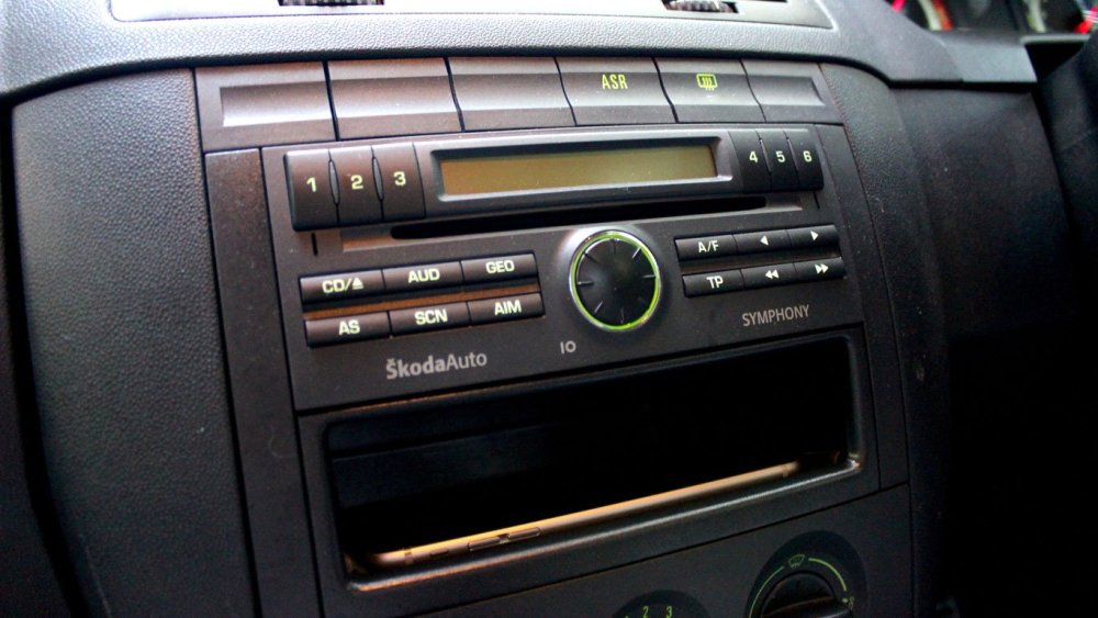

Sorry for replying to myself, but can't seem to edit posts (maybe because I'm a newbie).
Not my picture but this it what the dash looks like (attached) - with the cubby below the stereo:

1 hour ago, Orlinon said:
however the listing says that this is for the pre-2004 model (pre-facelift).
This section of the dash is the same IIRC. My single DIN adapter went in with my Kenwood KDC-BT640U (see my project thread), it was designated for Fabias between '99 and '07. You should be alright I think. :)

Thanks - I've had a look at your thread and your adaptor looks like what I need. I'm still puzzled by the fact I seem to have a Mk1.1 Fabia with a Mk1 dash.
It's the same dash for all the Mark 1s, the only difference was the steering wheel, dash cluster, and airbag badge on the passenger side. Mine is a 2006 Ambiente, so it's post-facelift.
