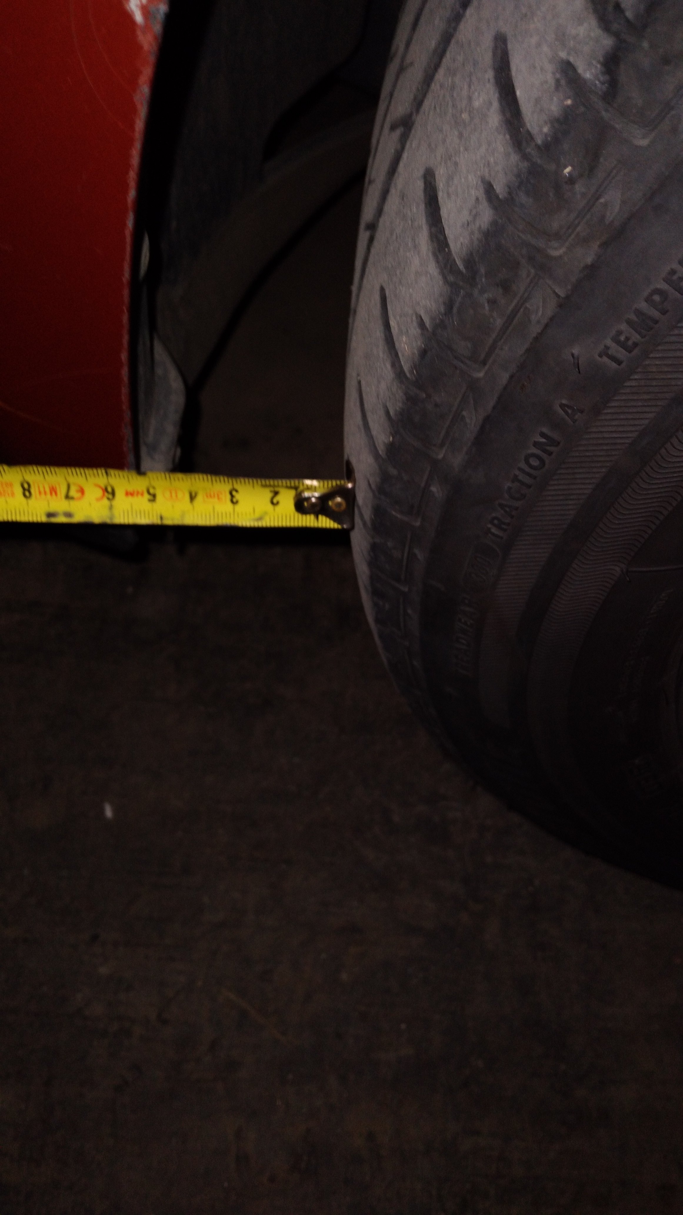

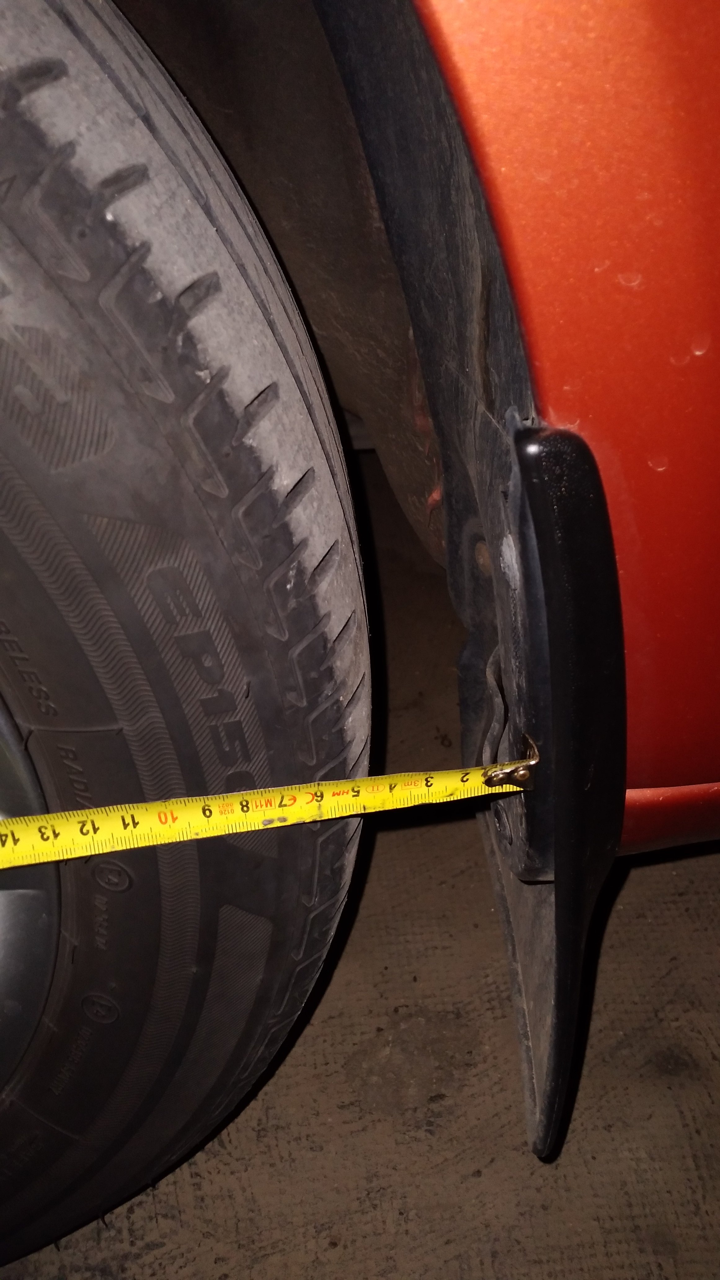

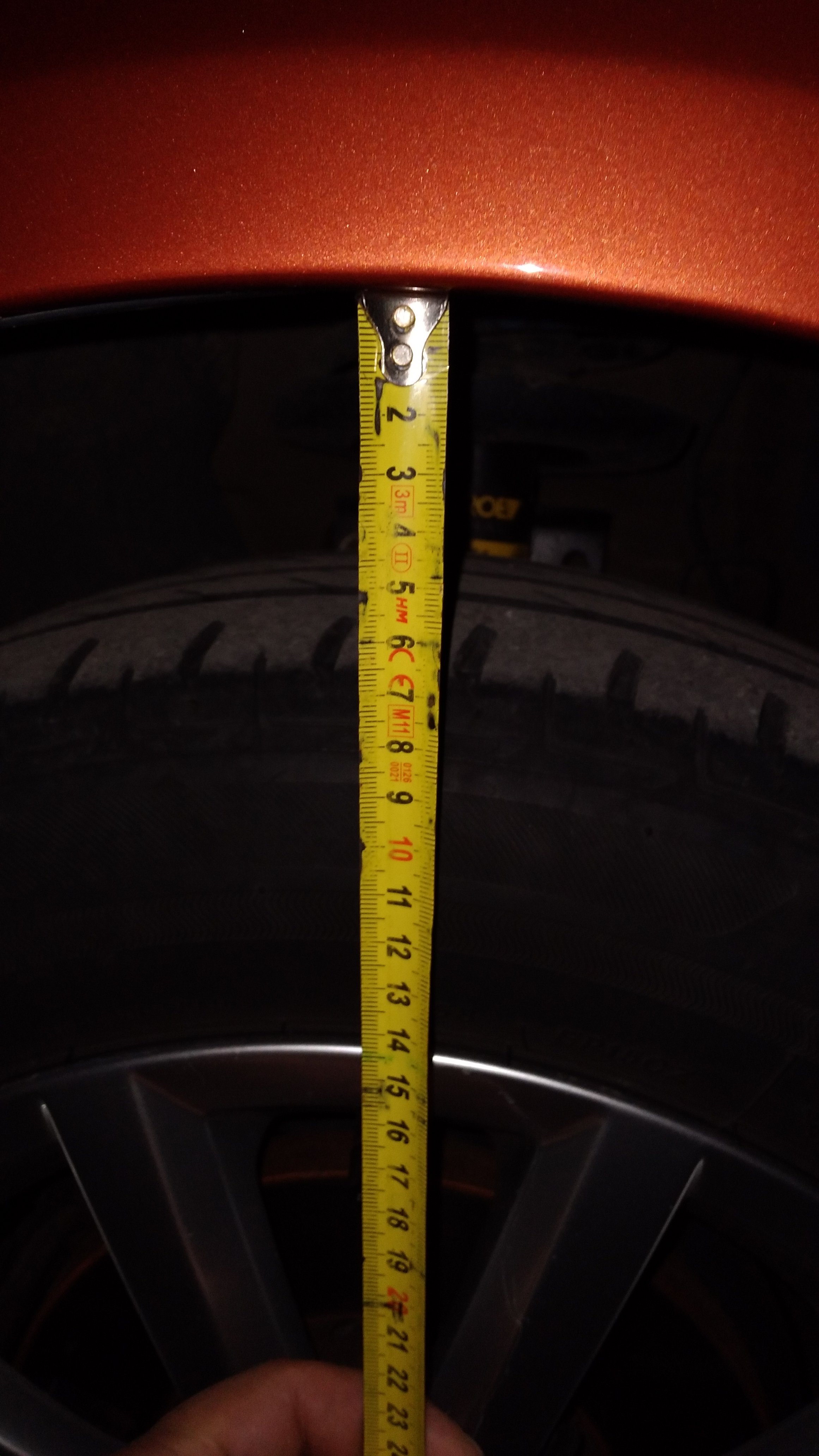

  6. Ok, so this is actual situation from the field 😄, this is my Fabia fitted with 185/60R15 wheels. Measurements are in centimeters between wheel and body. Take note that if you add some 1.5cm onto my tire spec you get 195/65R15..

  8. I agree but I still think that 195/65R15 can fit. Why? Because I fitted 185/60R15 on my Fabia and there's still room for more tire. Difference between these two is some 3,15cm in overall diameter, divide that in 2 you get some 1,5cm to fit all around. So in theory they will fit, but its really on the edge.
  9. I think you can fit these tires on your car with no issues of rubbing, but you could run into problem when passing MOT check. General rule is that difference between oem spec and retrofit must be in the range +3 or -3% in size. That way you're minimizing possibility of big difference between speed that shows the speedometer and actual speed you're traveling.
