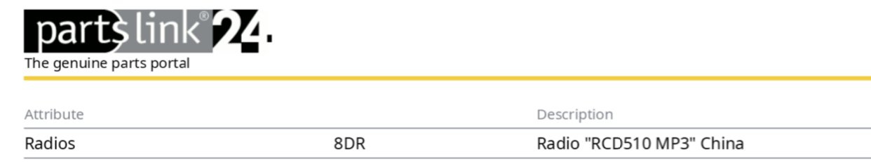

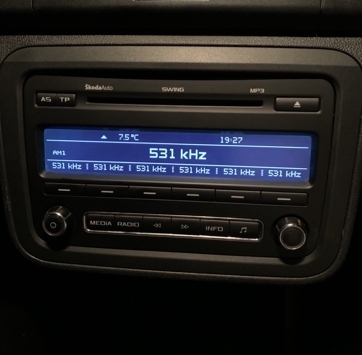

Hey guys, Bit of an interesting one. The HU in my car (mk2 20212 fabia estate) has no audio, no matter the source, radio/cd/aux. No crackle from speakers or anything. I got a VCDS scan and i got the vin decoded and here is what i found. The radio model on the VIN (photo below) does not match the one i have in the car (photo below). The RCD510 MP3 looks like some touchscreen thing. and the one i have is a basic model 310?? Upon removing the trim around the radio i noticed that the 4 screws were missing and actually in the glovebox so someone has been there already. Do i assume the original radio has been swapped out? If so could this be the issue to no sound? From this forum here it looks like it could potentially but not sure https://www.vwvortex.com/threads/help-no-sound-from-speakers.7175596/ Also here is part of the VCDS scan that brought up the radio.... Thanks in advance guys!! ------------------------------------------------------------------------------- Address 56: Radio (J503) Labels:. 5M0-035-1xx-56.clb Part No SW: 5J0 035 161 D HW: 5J0 035 161 D Component: Radio-SWING 001 0003 Revision: -----04S Serial number: SKZ4Z2M1109541 Coding: 050004000006 Shop #: WSC 13765 790 00053 VCID: 23063C45222C37917C-8076 5 Faults Found: 00856 - Radio Antenna 011 - Open Circuit - Intermittent Freeze Frame: Fault Status: 00101011 Fault Priority: 5 Fault Frequency: 1 Reset counter: 14 Time Indication: 0 00821 - Antenna 2 for Radio (R93) 011 - Open Circuit - Intermittent Freeze Frame: Fault Status: 00101011 Fault Priority: 5 Fault Frequency: 1 Reset counter: 14 Time Indication: 0
