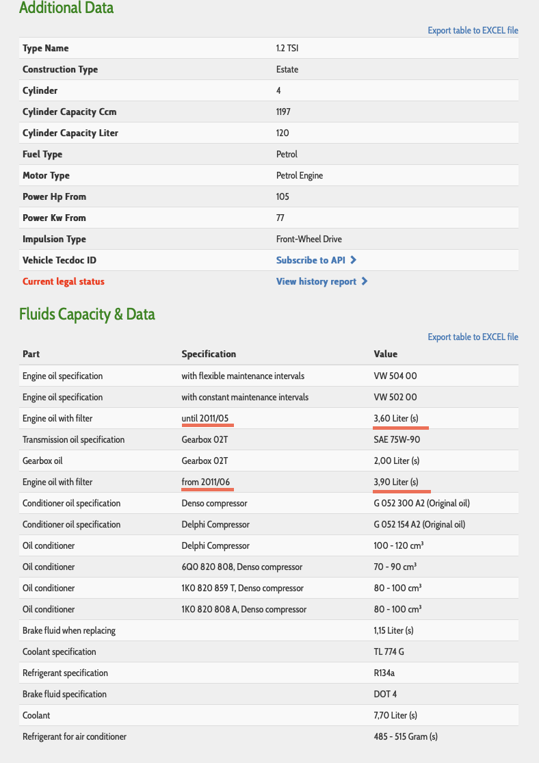

  2. Now here is a head banger @nta16 look at the image below. I put my vin into a vin decoder site and i noticed this... the oil capacity goes up based on when exactly in 2011 the car was made? haha. Interesting that June 2011 is when VAG started rolling out the upgraded timing chain kits i believe? @roottoot @xman I thought you may find this interesting ?? My car is 2012 but 61 Reg, so not sure when engine was built exactly ☹️ How do i find out for certain??

  8. @nta16 here's a shocker, I just measured the old engine oil that was drained from the service...2.6L 😳😳😳 a litre under. And I know why.... If you put the reg into euro car parts, it says "your engine needs 2.8L of oil. I bet the last garage just went off that. I wonder if that was contributing to the noises. Either way, I still think this Tesco E10 fuel has something to do with it. When idling cold on a morning, feels a bit......lumpy. I feel these tiny tremors every so often in the morning.

  13. haha ohhhh to be back in a resilient merc. One day ey! for the 44kw engine its 2.8L.
  14. Yes, and that's saying the same thing (no surprise as it's the same engine) I.e. 3.6l
