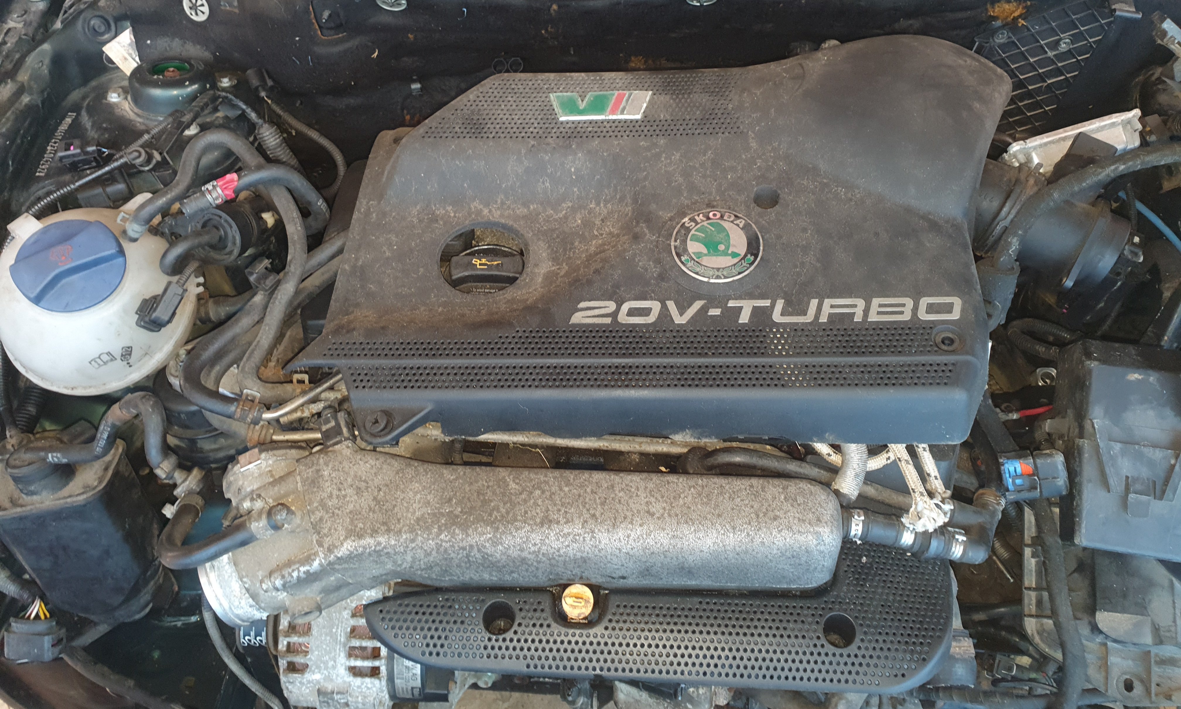

Hey guys! I have some problem with my project.. I tested my Fabia with auq 1.8t, and everything seemed okay. But i noticed, the turbo gauge says its boosting with 1.3 bar. So i turn back to go home, but after i stop, the car stalls. Started the car, and only 3 cylinder working out of three.. I have new bosch tfsi coils and ngk pfr7s(same to pfr7q i think) plugs. The overboost problem was caused by a missing earth from the n75(maybe), but now i got a Camshaft Timing Adjustment -Short to Ground fault code.. And the car starts only for 2 sec. Anybody can help me? I'm really sad, because i can't use my car about half a year..

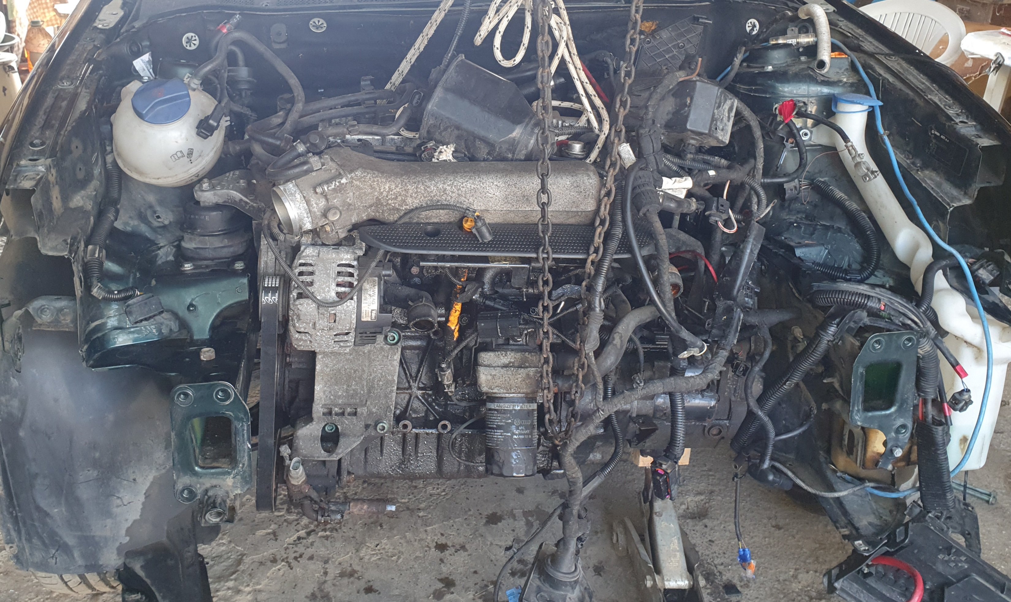

I have ecu and wiring loom from the octavia, but i don't really know what i have to use in my car. Becausw i have some relays too, but in my car i have relays, for the petrol pump, and idk.
Fabia 1.4 mpi (68hp) to 1.8t auq

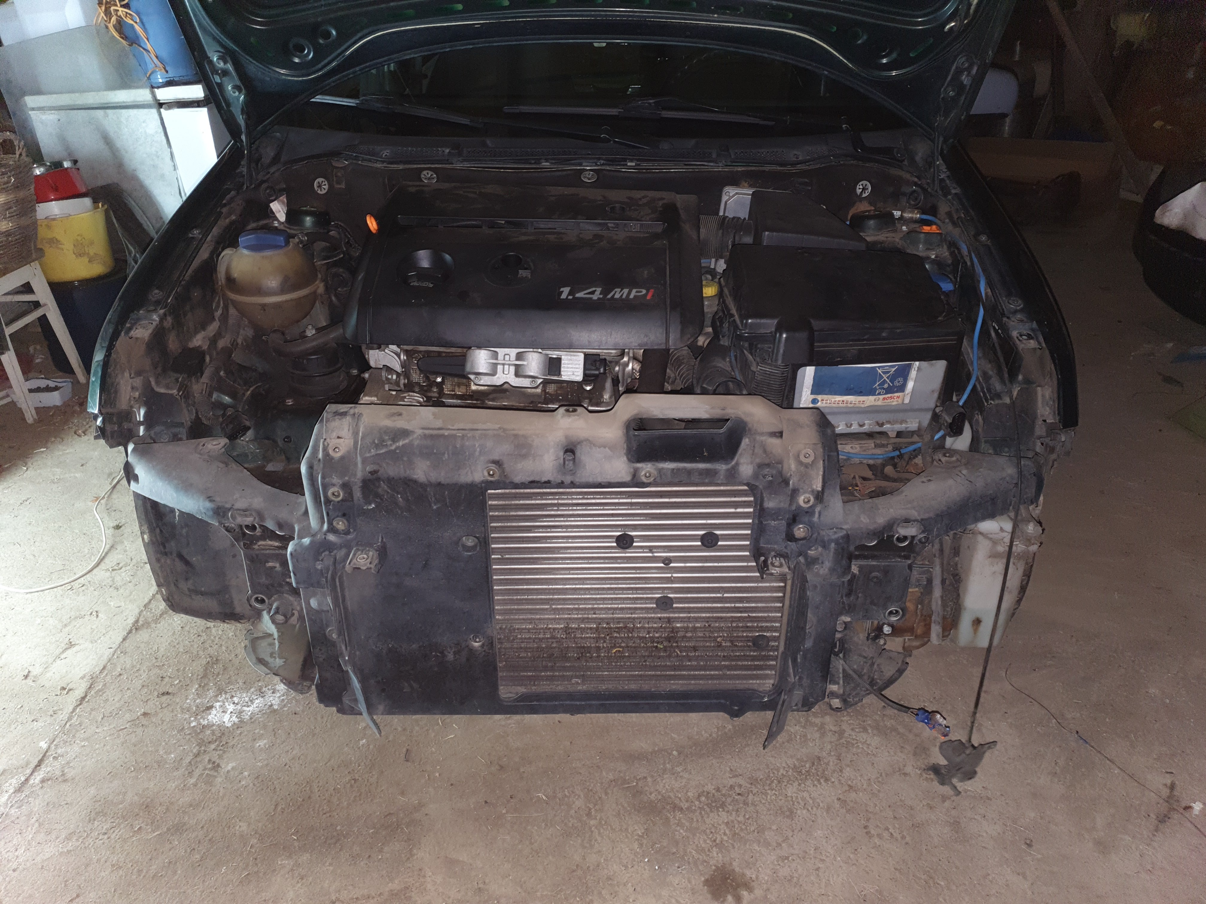

I replaced the timing, i have to reolace rhe oil, oil filter, sparks. The buggest job is i think the electronical job...somebody know, i have to replace the dashboard? Because the immobilizer?

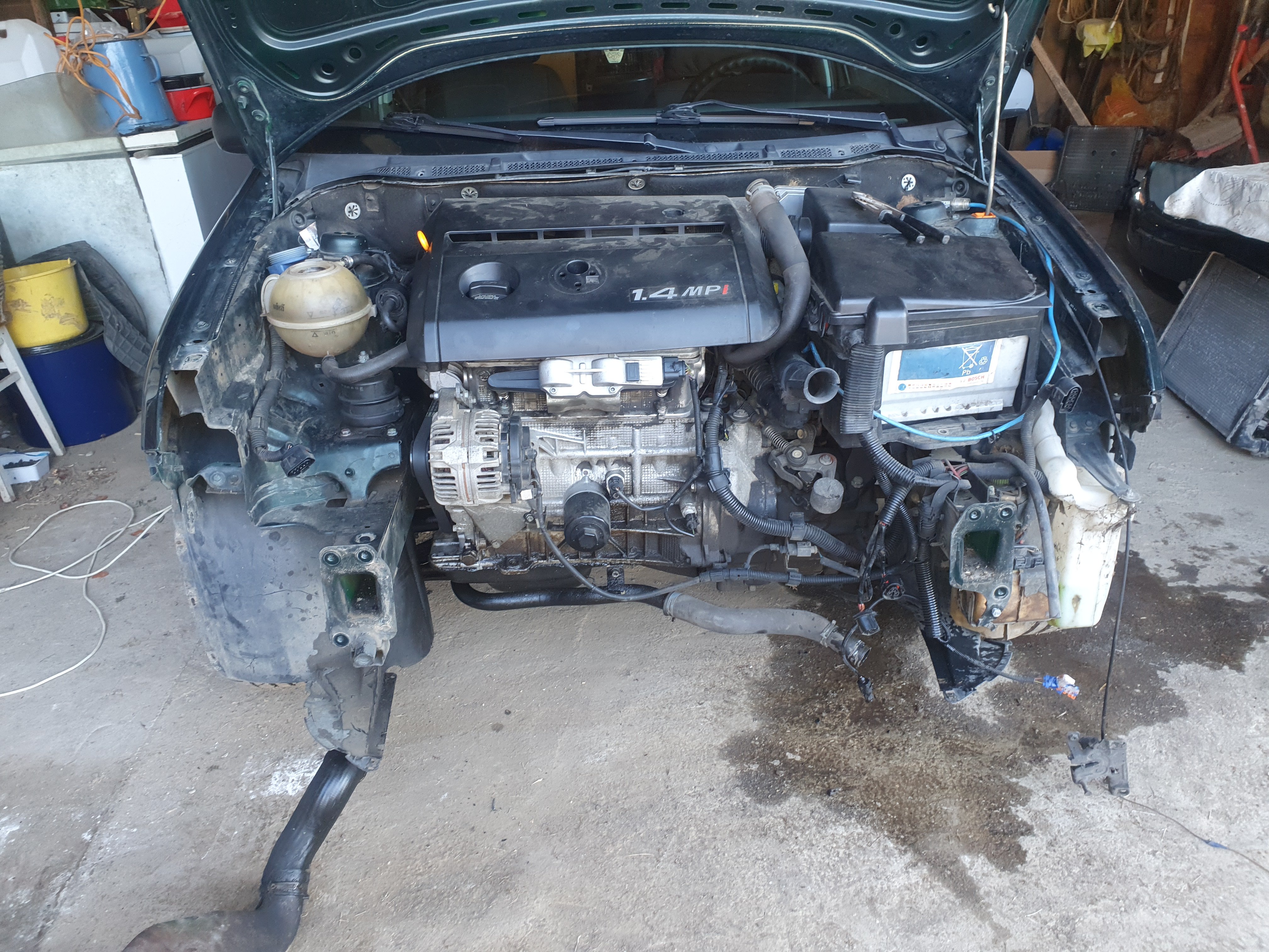

Engine is in the car, but the gearbox holder not avaliable yet.

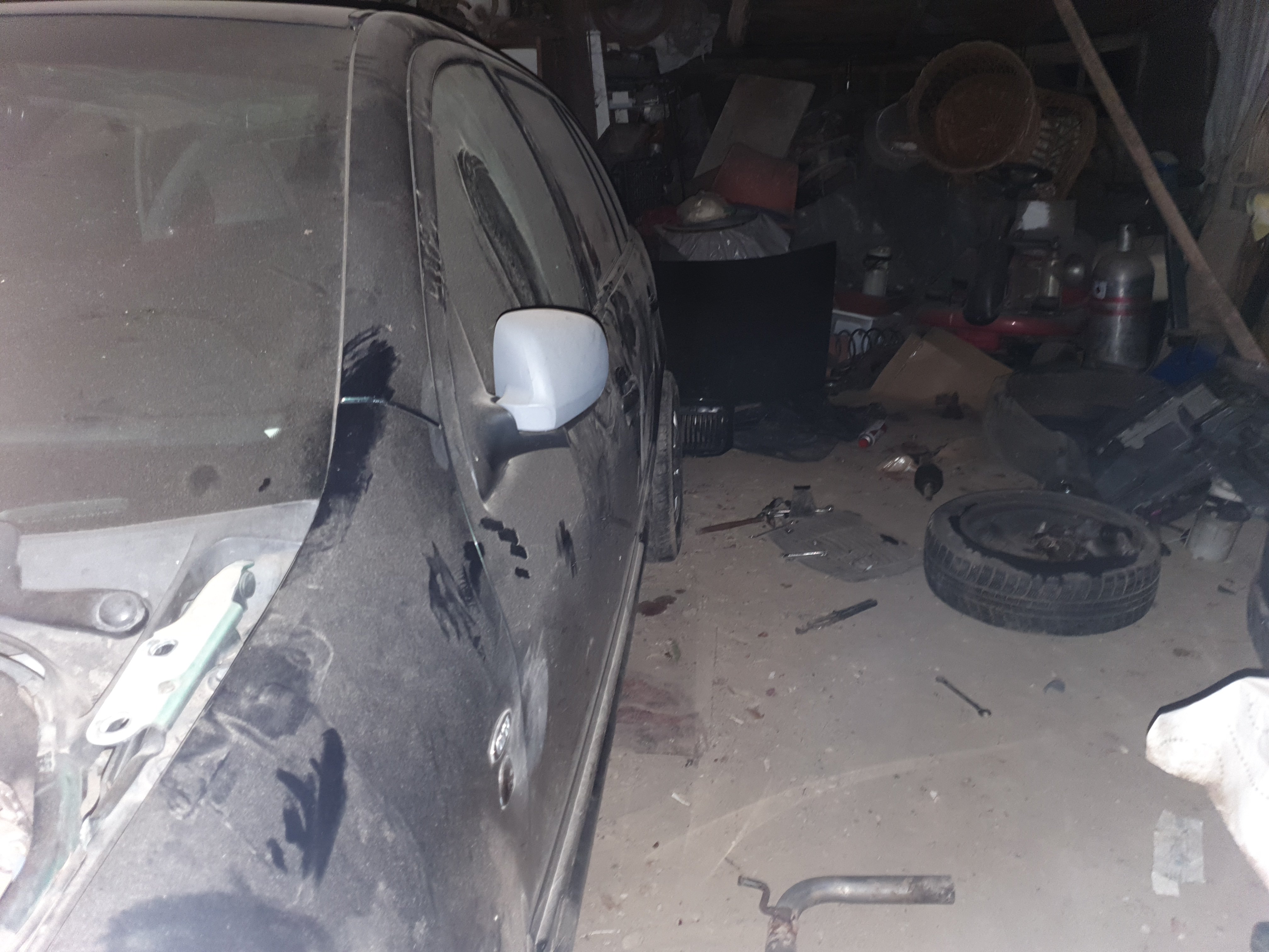

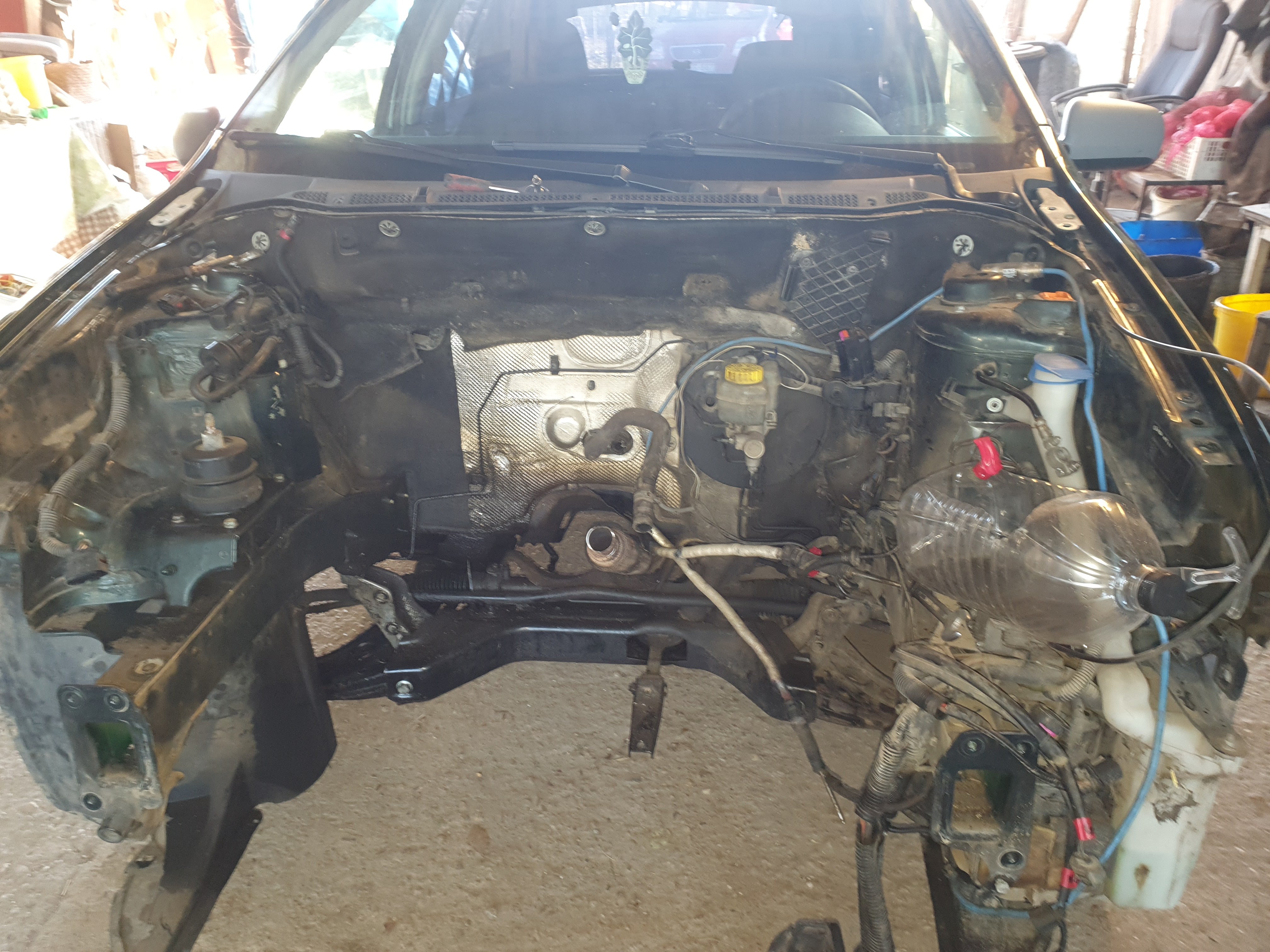

I replaced the rear bridge, feom the vrs, but its wider with 3cm🤣 I have to make a wide body on the back Its a bit dusty, but i don't have better place- Fabia 1.4 mpi (68hp) to 1.8t auq

Thanks for help! I post pics from the project, if there is a demand of it Jesus, beautiful!!😲😲- Fabia 1.4 mpi (68hp) to 1.8t auq
And what you recommend for the halfshaft? Or i need a longer swingarm?- Fabia 1.4 mpi (68hp) to 1.8t auq
This is the octavia console, i think i have to a make a new console, maybe the 6l1 ibiza (1.4pdtdi maybe) console not good for me? 20211102_175131_1.mp4- Fabia 1.4 mpi (68hp) to 1.8t auq
And somehow i can use the auq gearbox? Maybe if i create a new console for the fabia holder? - Fabia 1.4 mpi (68hp) to 1.8t auq
