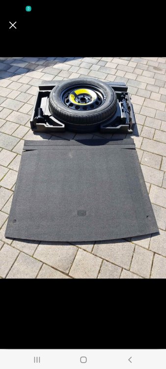

  12. Afternoon all, A local seller on FB market place is offering a Karoq spare wheel, full polystyrene surround with tools, and additional carpet for £120. The seller tells me the spare's size is 215/60 16". The size of my SE 5 spoke alloy is 215/55 17". Therefore the overall diameter difference is 3mm. Apparently the wheel lifts the height of the boot floor to more or less level with the opening. Two questions: 1. Suitable size? 2. Good value? Thanks, James
