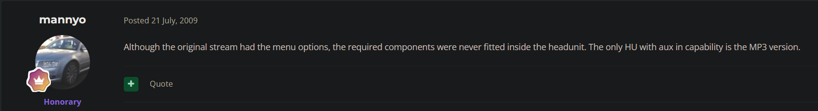

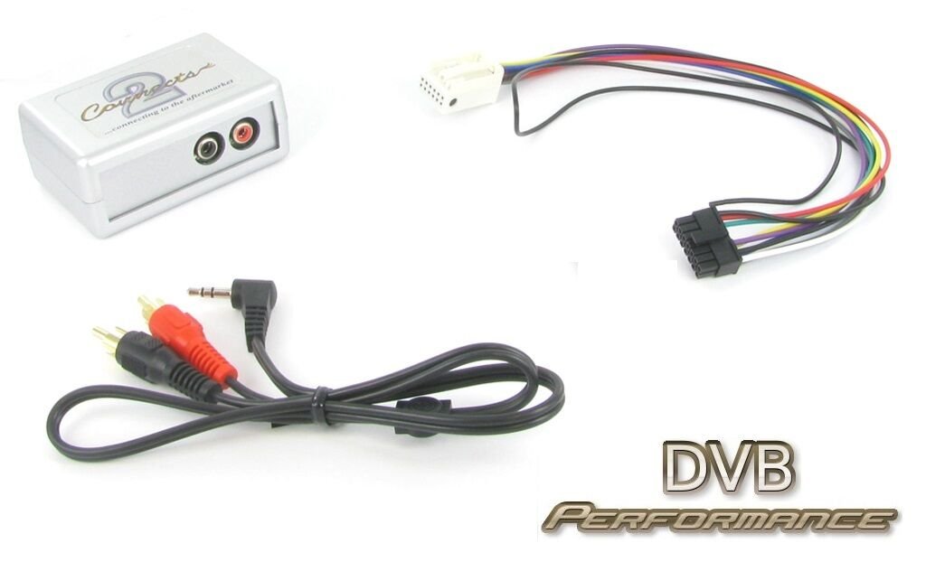

  8. Installing a basic aux socket to 12 pin cable didn't work unfortunately. I turned the AUX on in the radio settings but it just said 'NO CD'. I'm guessing the stream non-mp3 just doesn't support it. Do I have to get an Stream MP3 (since that's what comes in the 2007+ cars with aux ports) or do I need a different type of 12 pin cable with an adapter like this one? Also found someone saying this

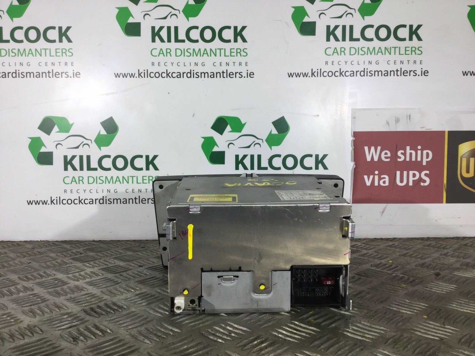

  9. Just figured out why the Bluetooth to FM transmitter I have sounds so bad. With the bass turned up I get a distorted sound from the right woofer. Even when it's not distorting it sounds crap in general. This distortion disappears when the speaker balance is turned to the left side of the car fully. I believe the right woofer may be blown. The sound quality using the transmitter is actually half decent with the balance turned to +2 or +3 to the left, but obviously I'd rather have sound coming at me equally from both sides. Is there anyway I can further diagnose the problem to verify the speaker's blown? Thanks
