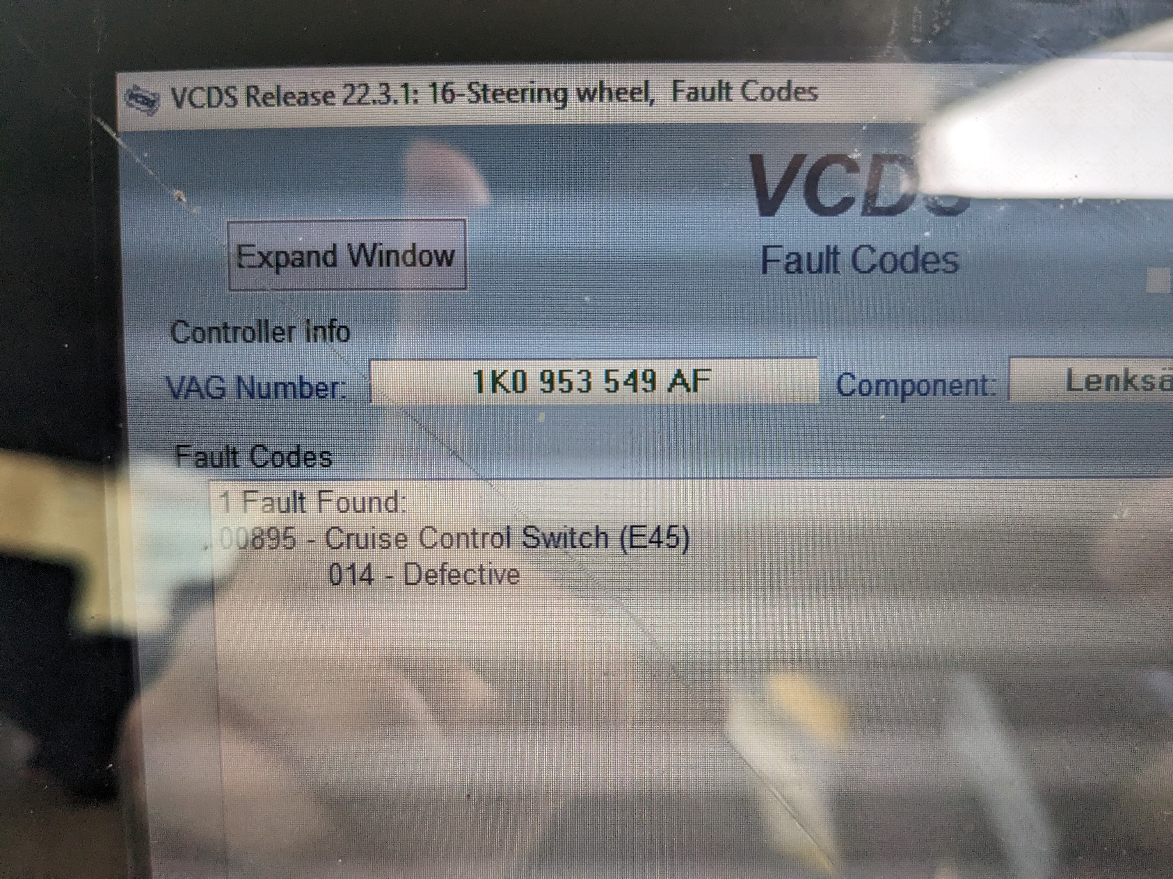

I'm actually able to enable Cruise Control via Coding -> Long Coding -> 06, then selecting Bit 1. The coding is accepted, but then I get an error code in Engine talking about DTC Memory.
I looked up the 005699 code on Ross-Tech's site and it has a special note regarding my engine, 'When found in 2.0l TFSI (AXX/BPY/BWA etc.), check Steering Wheel Electronics for Cruise Control related Fault Codes and general Cruise Control Functionality' which led me to the code in the Steering module in the photo below, 00895.
I now believe the TOPRAN branded cruise control stalk I bought is faulty. I'll try get a less-crappy brand one and see if that works.
