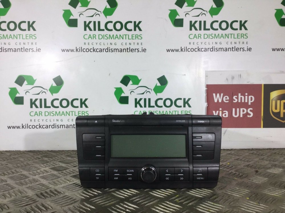

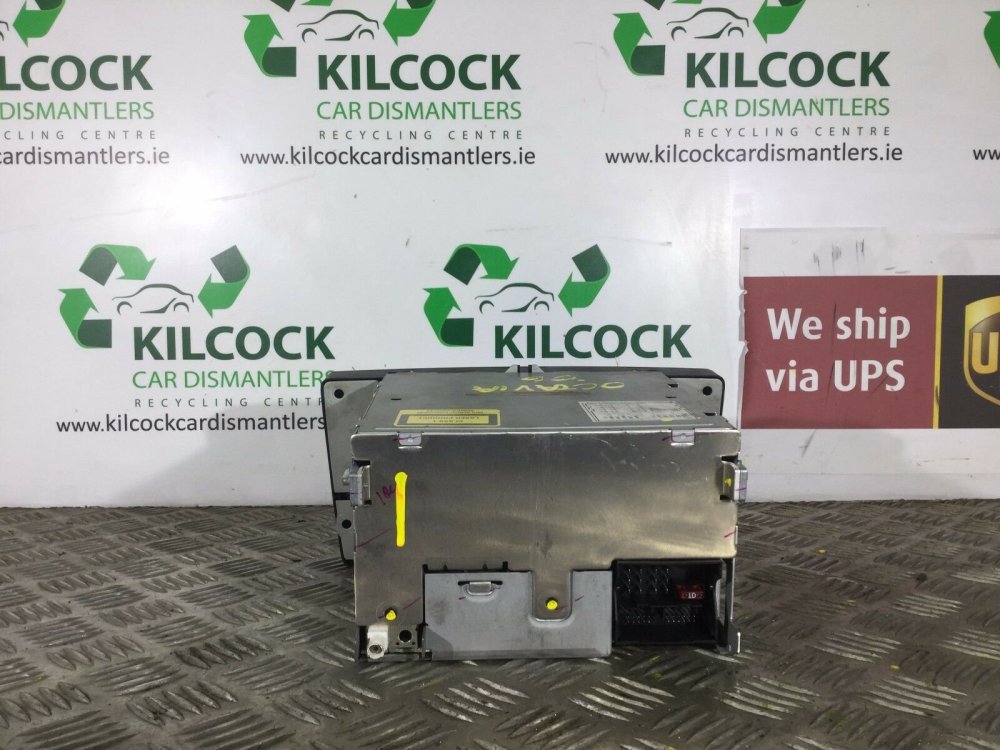

Not my pics, but my Headunit looks the same as this:

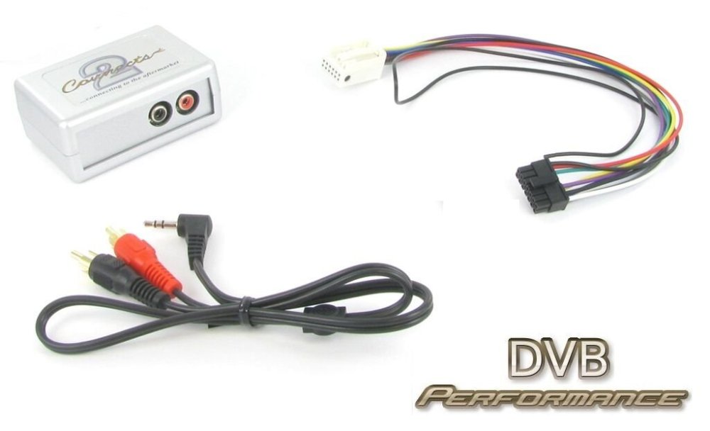

Do I have to get an Stream MP3 (since that's what comes in the 2007+ cars with aux ports) or do I need a different type of 12 pin cable with an adapter like this one?

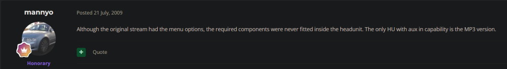

Also found someone saying this
A used MP3 headunit would be roughly the same cost as the connects2 aux adapter, ~€45

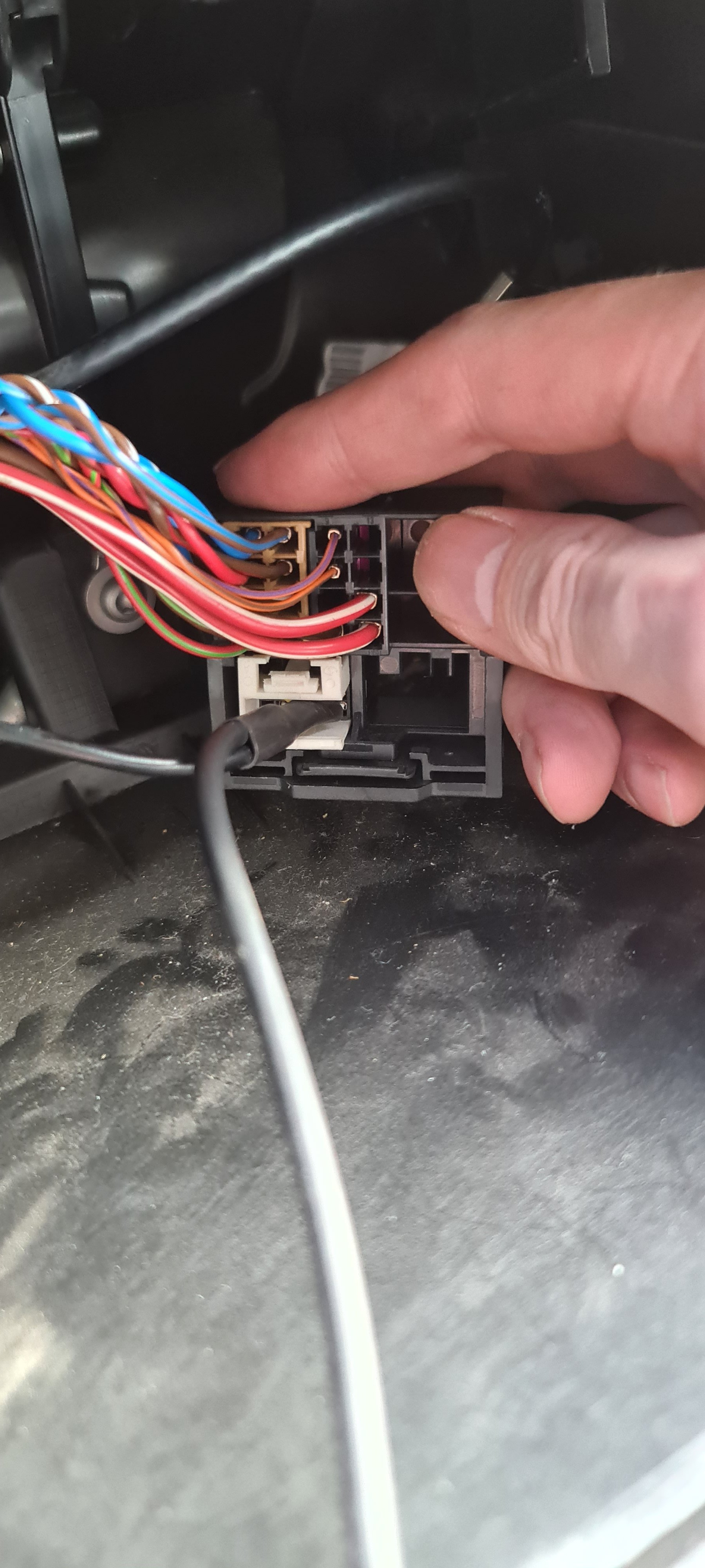

Ran into this post. I installed an Aux adapter on my Stream radio, which is non-mp3 and it works great. When I connect the radio, I just pushed the white connector abit further in. Then I went into the settings and put AUX on, then I had to make sure no cd was in the radio, and select cd1 and that's the AUX working.
