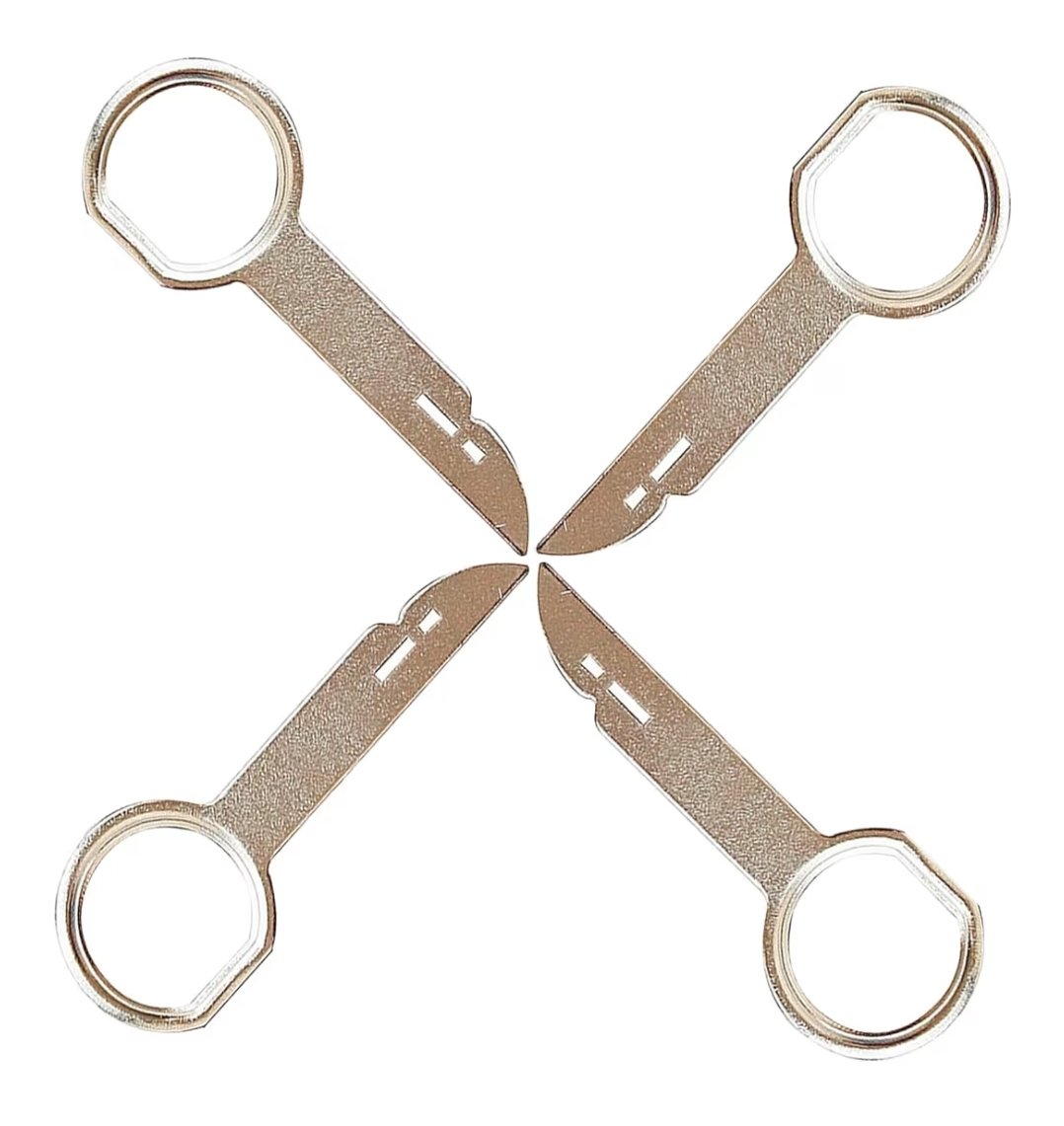

  2. You need to insert a radio removal tool, like the attached ones, in each hole that you see on the front of the unit

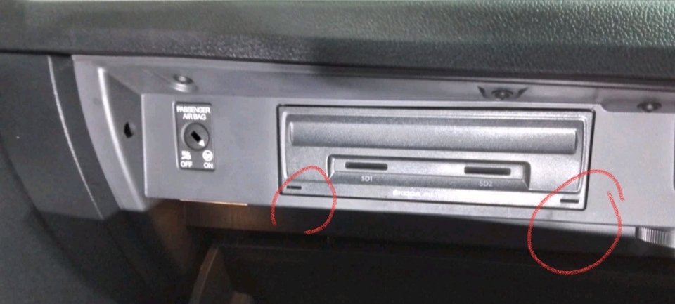

  4. I got mine stuck also with the Skoda logo on bootloop, but nothing else was working. I got it fixed by someone, but I had to send the unit in the glovebox. If you are in the UK I can pass you his details

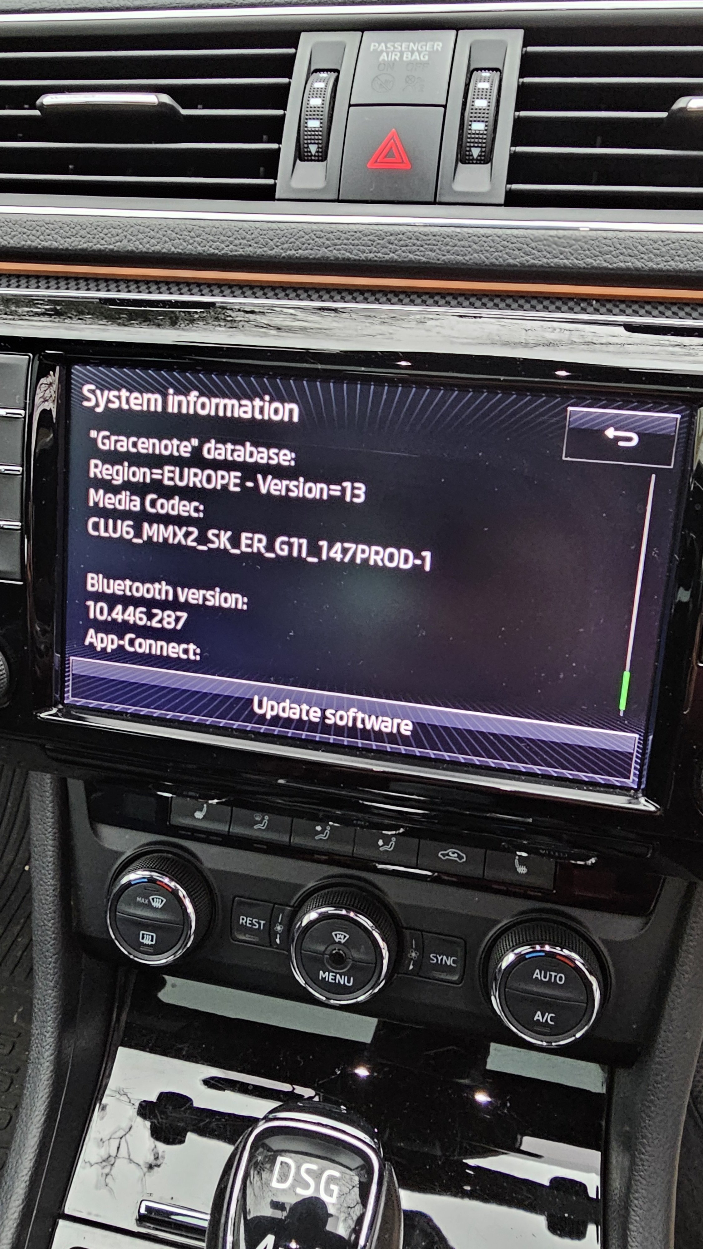

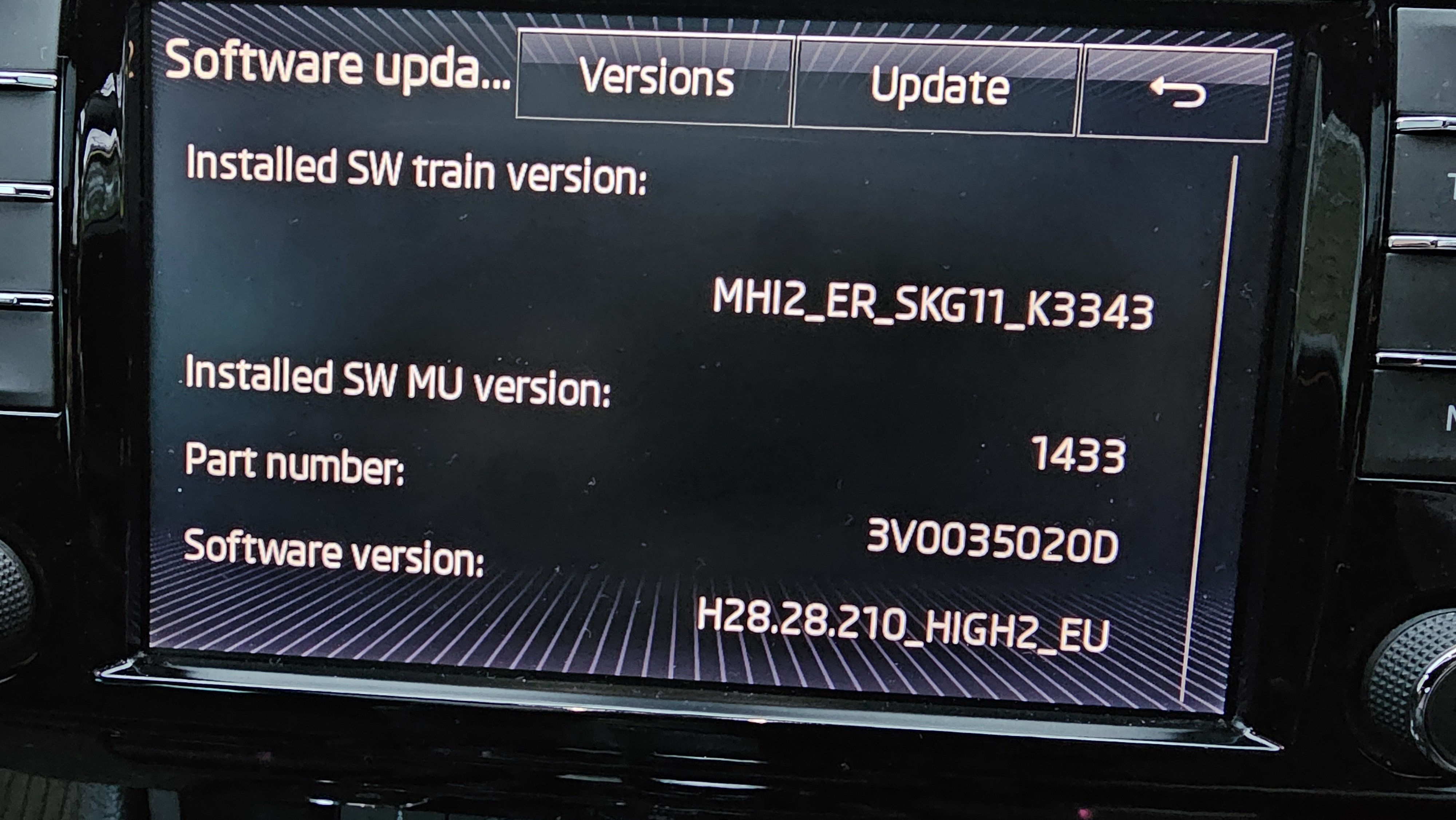

  9. I have posted the wrong photo, and MIB-helper says that this is the latest version. Anyone knows how accurate that is ?
  10. Anyone can help me with some info of how to update the MIB2 to the latest version before I try and upgrade the unit to a MIB 2.5 ? The car has a Canton audio system, don't know if that makes any difference.
