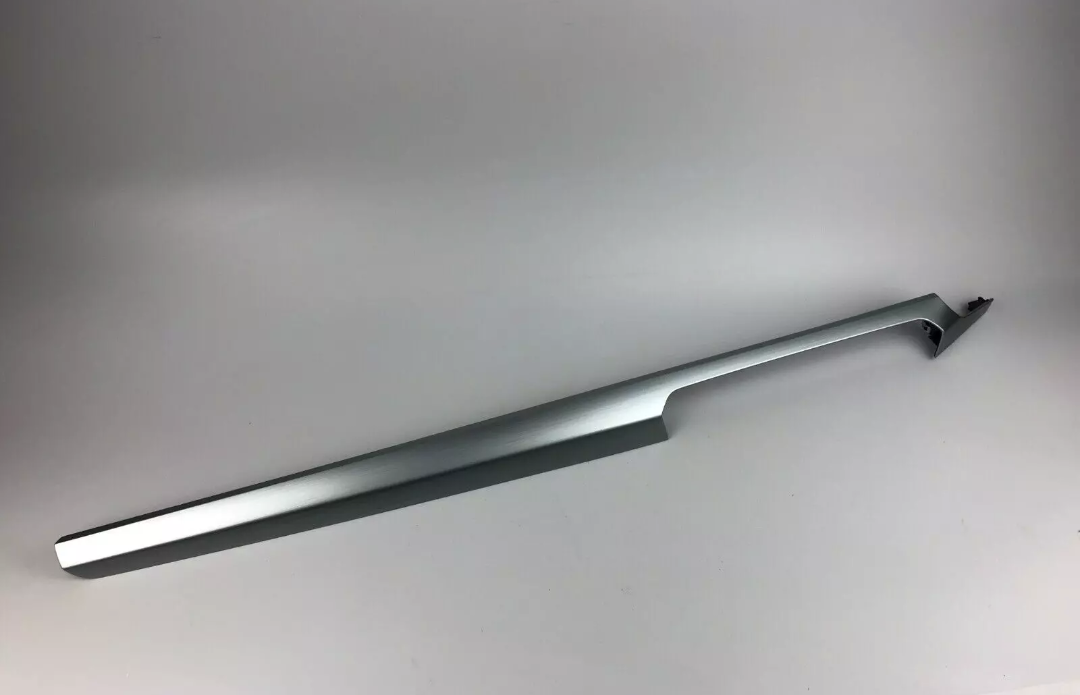

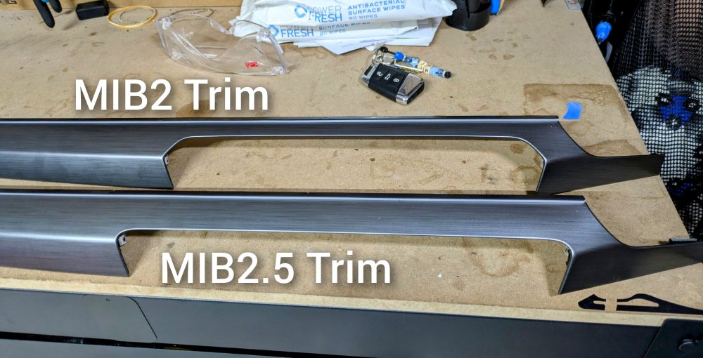

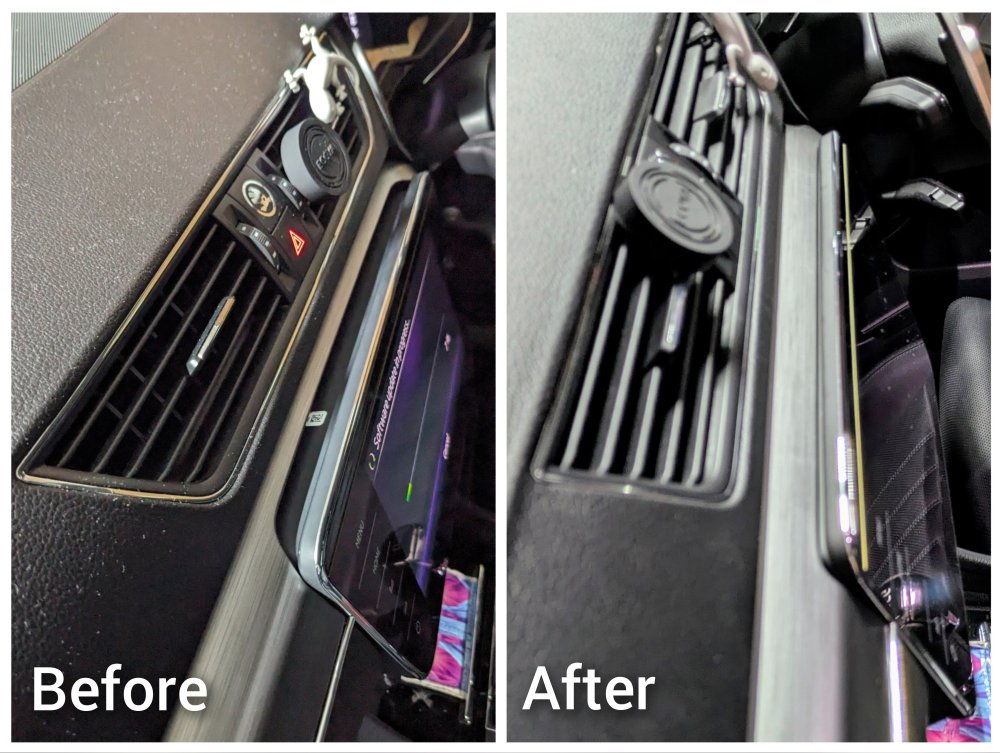

I forgot to mention in the how-to-guide about the dashboard trim piece that needs to b changed, ideally, though it's not noticeable from the inside the car.... unless u look behind the screen, or through the windscreen.
Whilst I'm not a 100% sure yet, as I'm still researching, I think I need version E of the trim piece.
My current part number is 3V2858418 NH1 (Brushed Metal).
I think I need to get 3V2858418E NH1, which has a smaller opening profile behind the screen.
My theory, with pre-facelift, is:-
- MIB2 with 8" screen uses 3V2858418 NH1
- MIB2.5 with 9.2" screen uses 3V2858418E NH1
However I'm having trouble sourcing one secondhand as most r black from Sportline models.
These r the options:-
3V2858418E HQ1 - gloss anthracite
3V2858418E NH1- brushed metal
3V2858418E NF8 - satin black
If u have a LHD model, it will b 3V1.  RHD is 3V2.
As soon as I find out for sure, I'll update this post.

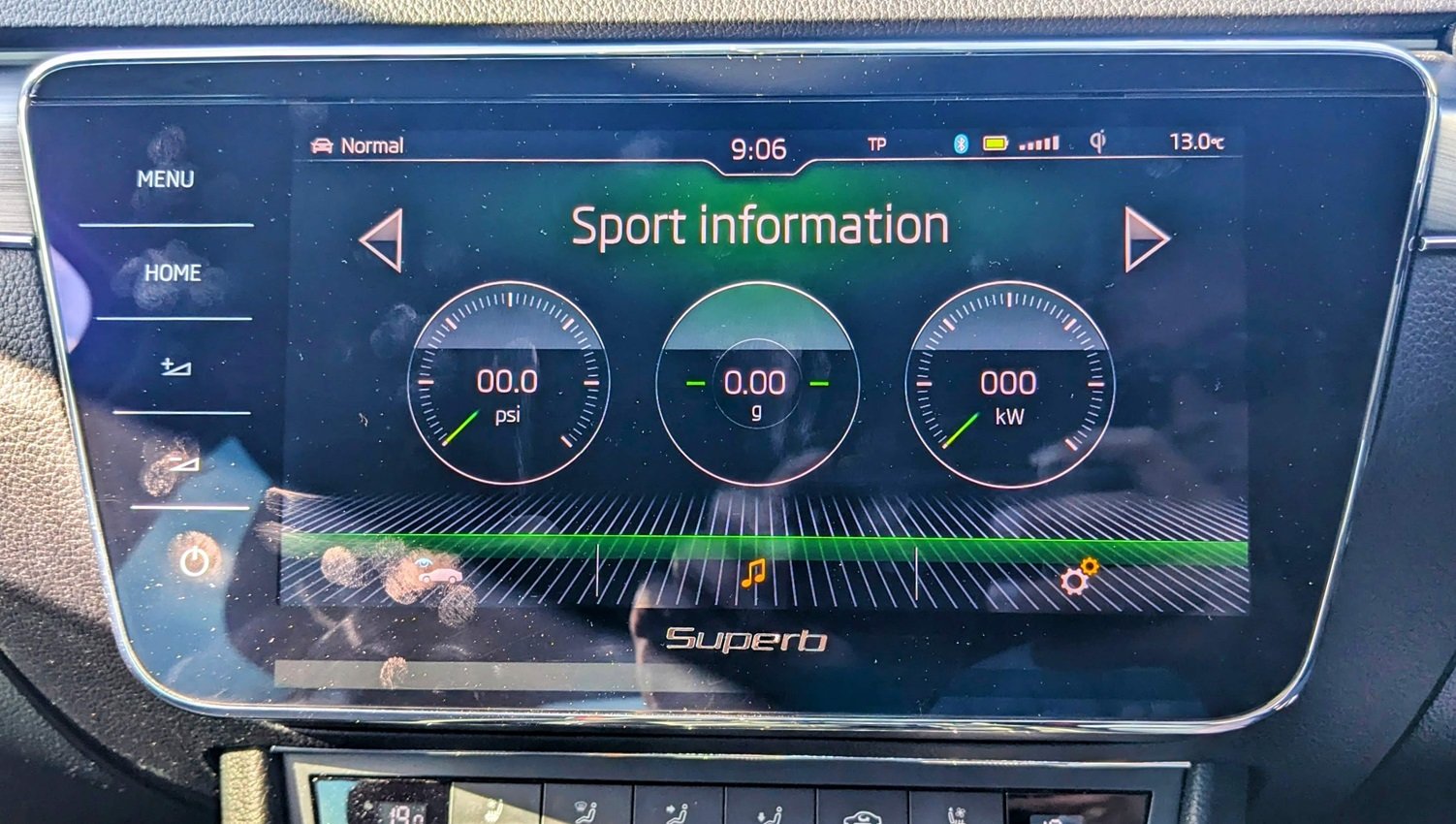

found another feature "unlocked" as a result of the MIB2.5 conversion - Sports (Performance) Monitor!!  woOot
normally this only enabled on Sportline models.

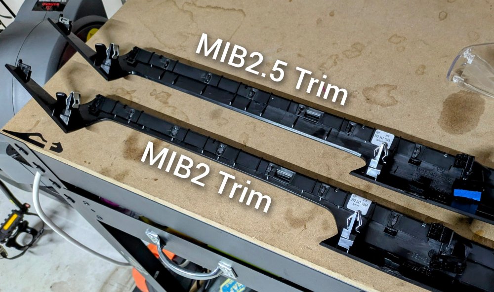

for the purposes of closure/completeness, the final piece of the puzzle was done - the centre dash trim piece.
So 6 months later after converting my MIB2 unit to a MIB2.5 unit, I finally managed to get my hands on the centre dash trim suited for the 9.2" Columbus screen.
MIB2 trim piece - 3V2.858.418.A
MIB2.5 trim piece - 3V2.858.418.F
The swap out process was relatively easily.  Removed the screen first, then unclipped the old trim piece.
I was unable to disconnect the ambient lighting strip connector as it was deep inside the dash trim and there was no way of getting to it!!
So I unclipped the actual LED board and clipped it on to the replacement trim piece.
Job done.
There is two of them.  One shoots light from inside to left, and the other from inside to right.

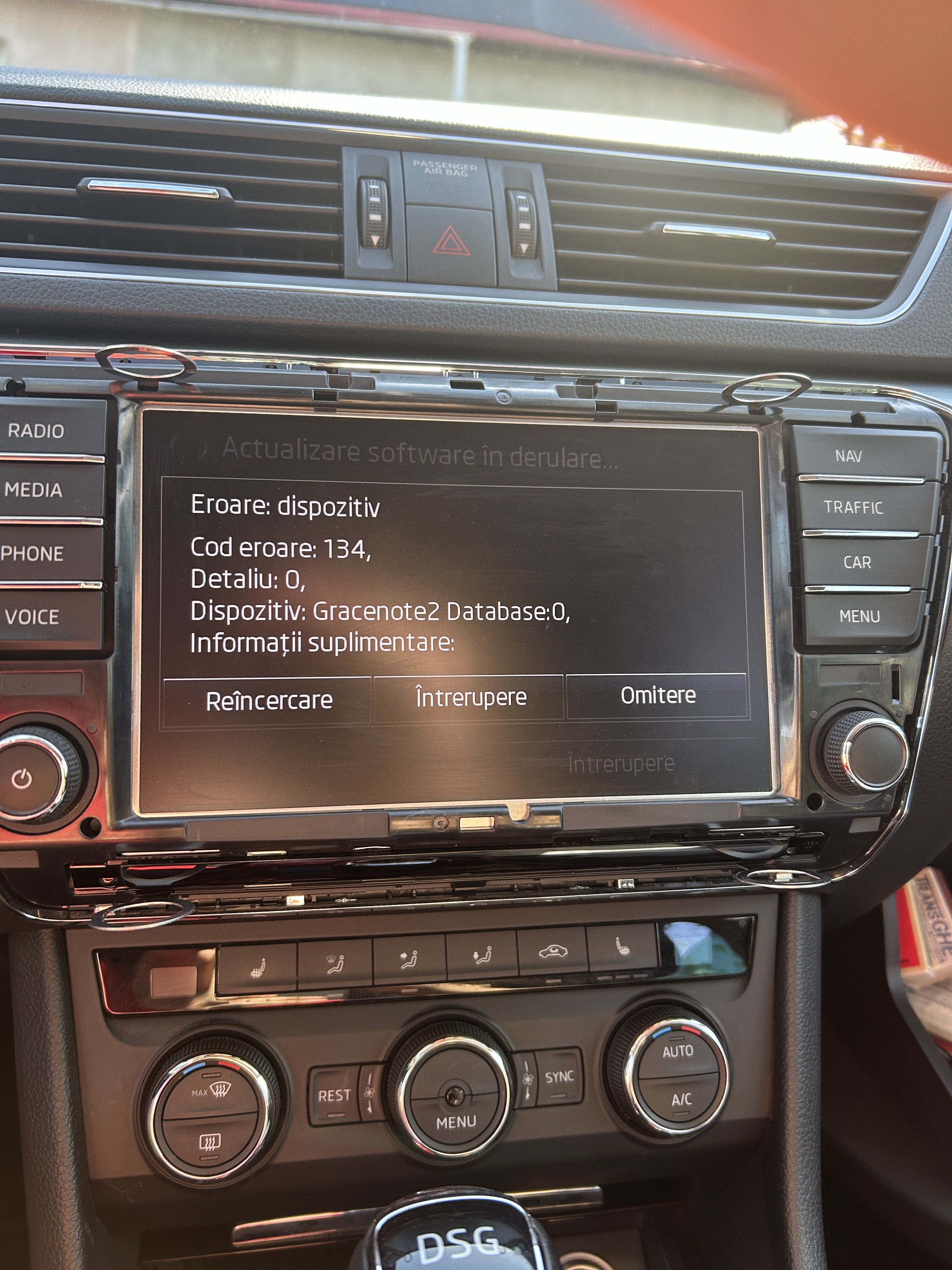

@JR RS yeah, so I did upgrade using AIO software I got from a guy on reddit, but someone told me there is no problem in using Gracenote2 EU-v23-0010-1.1.1.2934-20230223.zip as Gracenote, not the AIO Payload that u mentioned in the tutorial, and it was someone who is doing these kinds of conversions. Ofc I got an error on installing on Gracenote, error code 134. However the sytem is now functional. Thank you for uploading the files. My question would be now if I can somehow update just the Gracenote via a SD card. Is it possible? Or do I have to just do a system update just I did in the conversion with the AIO software and gracenote from you? And other than that i do have a few more questions about the AIO software, is it okay if I send them here in a message and if you want you could answer to them in the next 1-2 weeks? Thank you!

@Codrut20171 - the G11 to G13 AIO instructions on the MIB GitHub state to use the specified Gracenote payload.
I'm not sure how or if it's possible to load that on its own.
Sure thing - happy for u to send me a PM or post in this discussion.
Someone told me its enough to just update the database via sd card(put those 3 folders in the root of the sd card). I will try and let you know here,so if someone encounters this again they ll know what to do.
