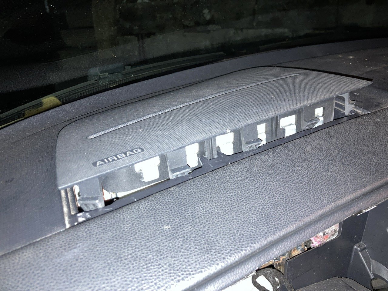

Thank you again for the input! I am delighted to say… Haaaaaaaaaleluyah! Turns out, as is often the case when the problem-solving route has failed, I just had to hit it harder. Though for @ApertureS’s peace of mind, it was more ‘weight plus gravity’ than an actual whack. And I still appreciate the chemistry info 😁 I love to know how and why things work (or don’t). And @UrbanPanzerit wasn’t a silly question, and it was an excellent thought! but I was so drilled by my dad in the careful collection and storage of bits and pieces that I’m borderline incapable (famous last words) of missing something like that. Makes me veeeeeery slow though 😕 On to the next thing now - the bloody door loom. Wish me luck.

This is all really helpful, thanks posters. That’s exactly where I was at: I know the trigger is electronic and so the actual impact sensors won’t be able to send a ‘deploy’ signal to the pack, but at the same time yeah, explosives, so feels wrong to thump it! So I’ll disconnect the battery, and maybe try being a bit more forceful, but will probably not use the shot mallet 😆 Though still hoping someone’s got tips for how to make this slightly less difficult..? This is my optimistic face…

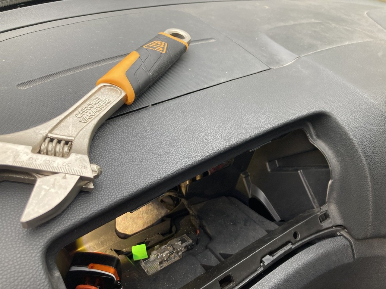

After a successful if long encounter with dash innards to replace the resistor pack, I now can’t get the s*dding airbag back into place. I can see all the lugs (apart from the ones right under the pack towards the windscreen. Everything seems to line up enough that it should respond to pressure. I can get one side, even a couple of corners, to sit flush, but then something I can’t see/work out just won’t budge. And as I’m not sure exactly how the thing works, I’m shy about properly thumping it, considering they’re triggered by impact, though if I disconnect the battery again, will that render it completely dormant?

All the blower & resistor info in various threads = just changed it, and the ice blasters are now producing a gentle breeze, and we can have a conversation at the same time. Bloody marvellous. However, what comes out does not necessarily want to go back. Anyone got any top tips about how to get the sodding airbag cover to clip back in? I've lined it up, I've tried every angle, corners first, anything else first, and shoved torches every which way to see what's causing the most resistance, poked at the various lugs and clips to ease them under the lip but no, something just will not go. And please don't say 'just give it a shove', as the angle of the windscreen plus my lack of physical bulk = I can't deploy the little weight I have in the right place. Anyone..? At least the rest of it went OK. To add some more 'things I discovered while deep in the dashboard of a Fabia' to community knowledge: The 3 Torx 27 screws were too deep, and too content to stay where they were, for a regular screwdriver to shift them (also, I'm tiny, so I have to deploy brains where brawn is lacking). Had to cobble together every converter and extension to create length and leverage. I did something similar to @Oldfellah, but rather than rags I used a parking receipt to create a shoot under each Torx screw from the airbag fixing points, as they're helpfully positioned over holes. Levering out the airbag from below makes sense, but was nowhere near as simple as the YouTube video above suggests (though it's still the most helpful one out there for those of us with a top glove compartment). I ended up using one screwdriver to create another, higher pivot point, so I could apply more force from below with the first one. Lost some skin doing that one, despite the gloves. But I'm gonna go and order a set of plastic trim removing tools, as I've got something else to fix now, and as a PP said, it probably would have been easier to take the lid off from the top. The cable that runs to the airbag was attached to a little clip, that was covered up with the insulation, so initially I thought I wasn't going to be able to get the airbag out high enough to even get underneath it. I've posted a photo below. But once it was out, there was enough cable (just) to rest the airbag on the dash and remove the power. It's worth taking photos closer up than you can physically get with your eyes, so you can see exactly eg how the power goes into the resistor pack, so saving time wiggling the wrong bit of black plastic. Just hold on to your phone tightly! And just because it worked, however stupid it looks...

Well, said it would take me a while. But woohoo, 3.5hrs and several dead torches later, and the blowers blow on all settings. THANKS everyone, plus the many YouTubers whose videos I cherry picked, cos having a top glove compartment, and dash passenger airbag to work around, seems to be a bit of a rarity.
