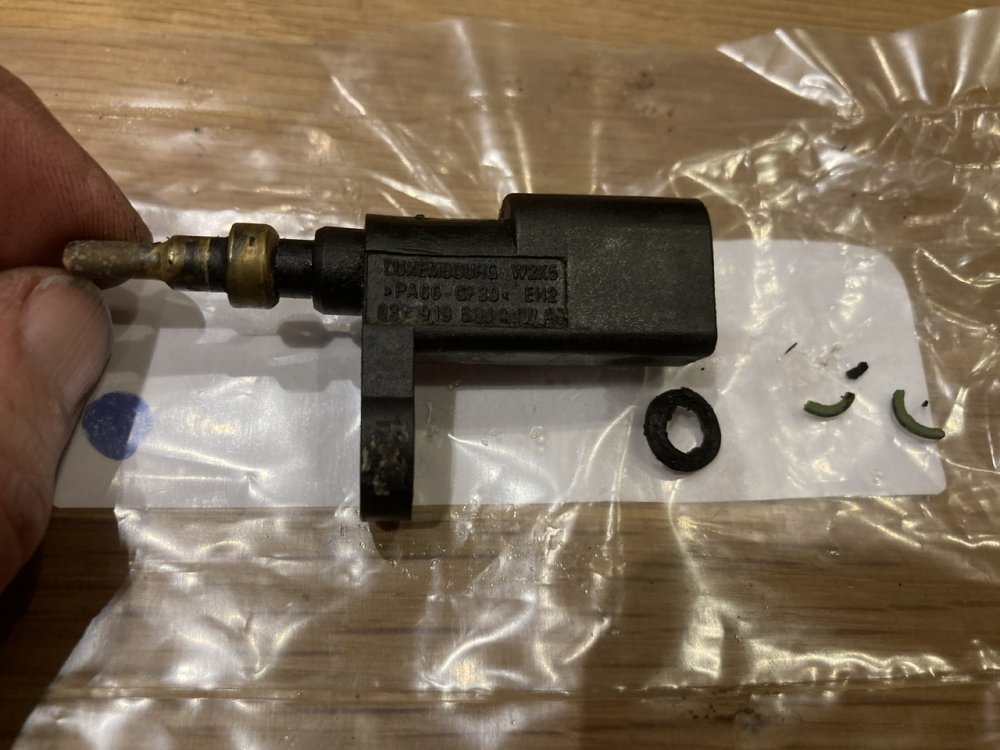

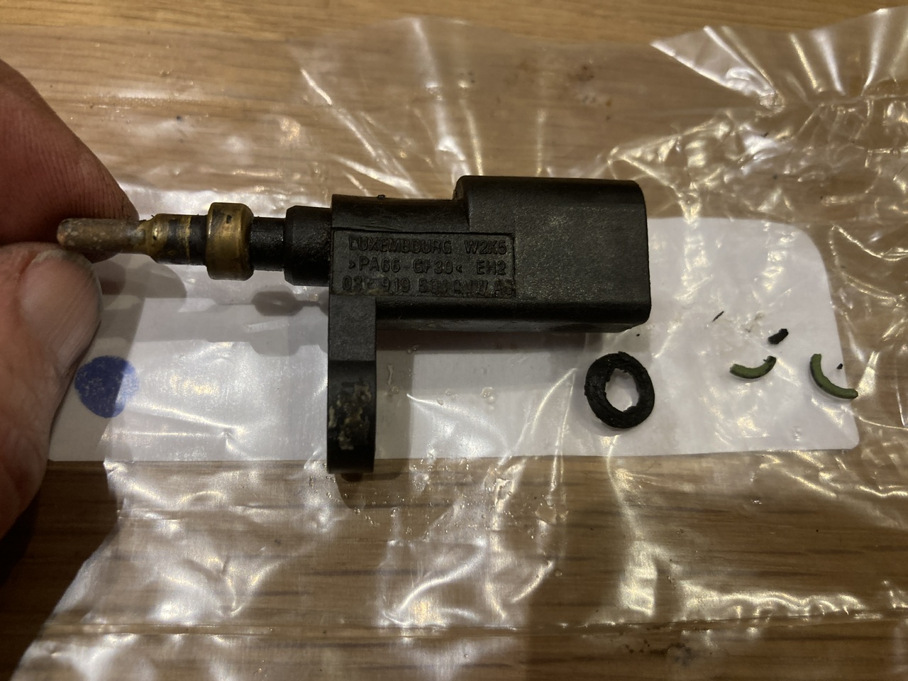

Got the little sod out. Had to fish around for a while, hooking out bits of O ring with an adapted paper clip. Glad the second one is green or I’m not sure I’d have spotted the remnants. Used a combo or torches, mirror (thanks @sepulchrave) and phone camera for the ability to zoom in. Ended up taking out both air hoses and the air filter housing (which was surprisingly easily to remove. Never had need before), and the battery. Disconnected one of the radiator coolant hoses and it was still a bugger to get to. @Breezy_Peteinvaluable info again, both about location and getting the connectors off. Watched videos, had a practice on more accessible ones and voila! That stage could easily have been where I got defeated without this intel. Massive thanks again to Briskoda’s finest.

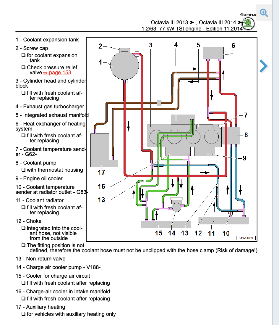

Thanks, yes, I did look at that. But despite usually having pretty strong spatial reasoning skills, I cannot relate that, or anything else I've looked at, to what's in front of me when I'm standing with my knees up against the radiator. I did get under the car to check the leak so I know where the pump is. I understand engine fundamentals, so I can figure out where most things are even if an engine looks totally different to what I was used to. But I have no experience (and apparently little understanding) of cooling systems, so I'm pathetically stuck.
Coolant: Check Manual "Ding, Ding Ding - Red symbol"
Thanks @sepulchraveand I would, if I could %#*{%^ find it. I’ve looked at Haynes, at diagrams, at many photos of other people’s (slightly different) engines and I’m humiliated in defeat. WhereTF is it? Side note: it may be that battery is actually my non-starting issue. But anyway, that bloody CTS… Is it under something, which is why I can’t find it?
