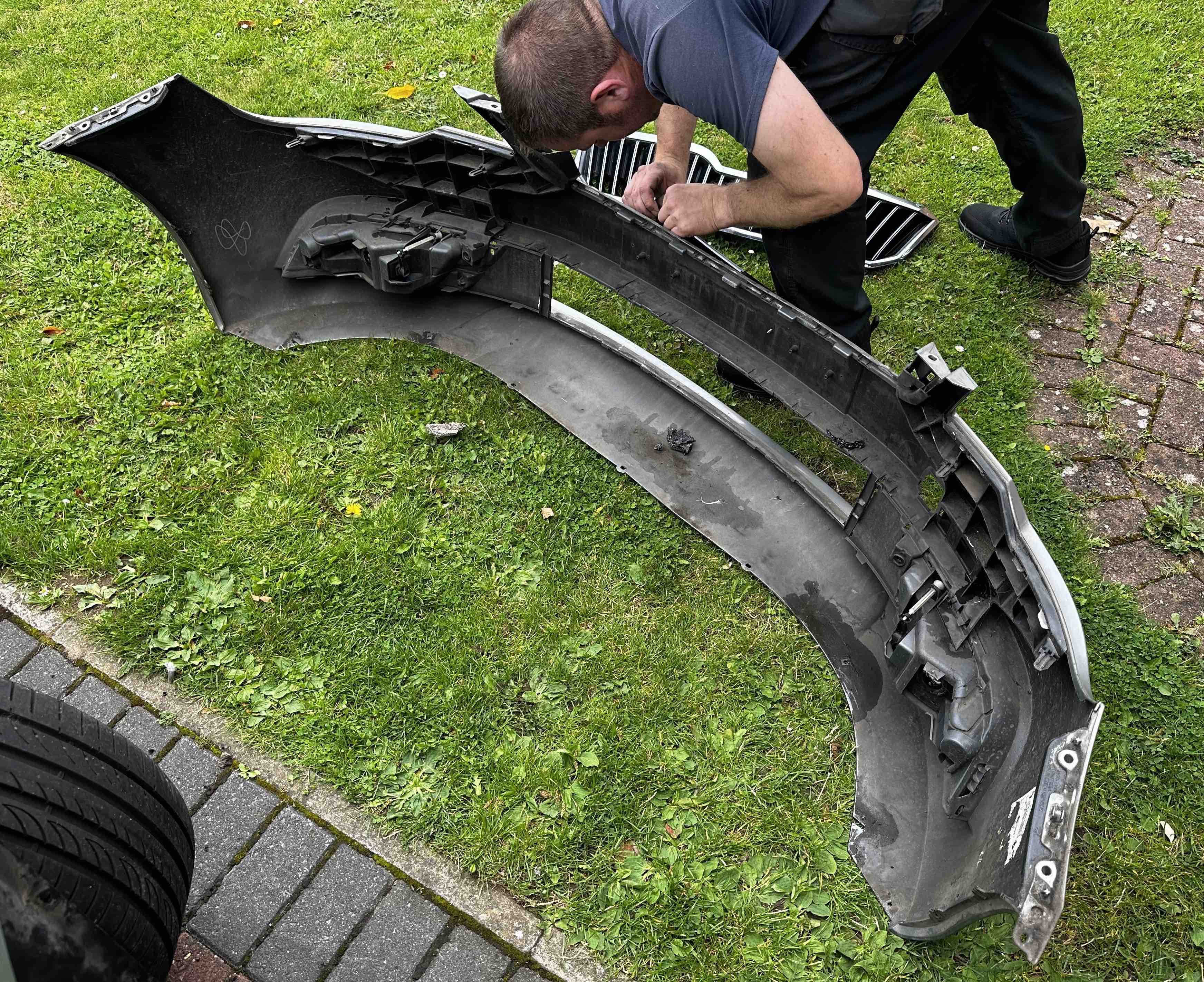

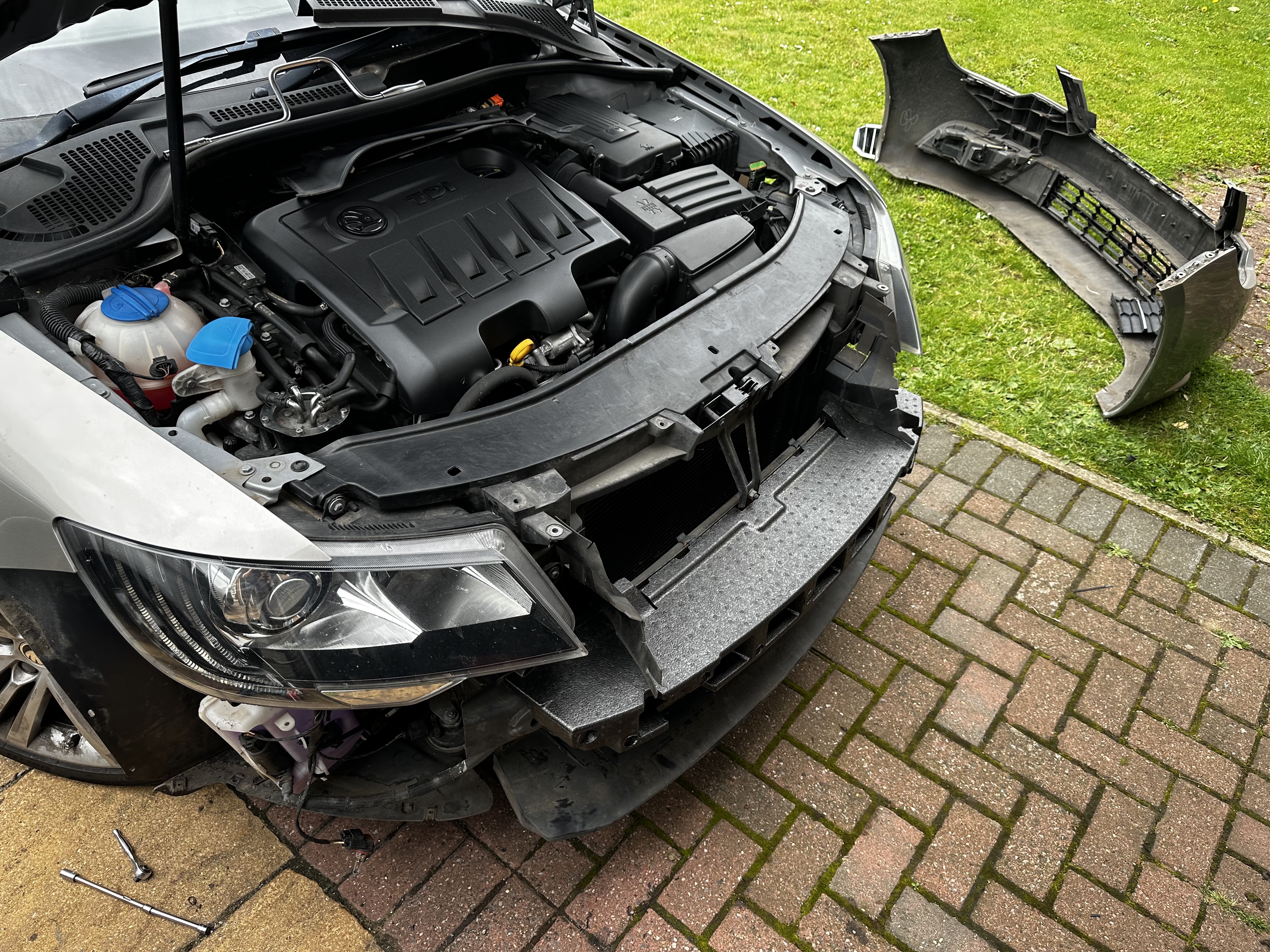

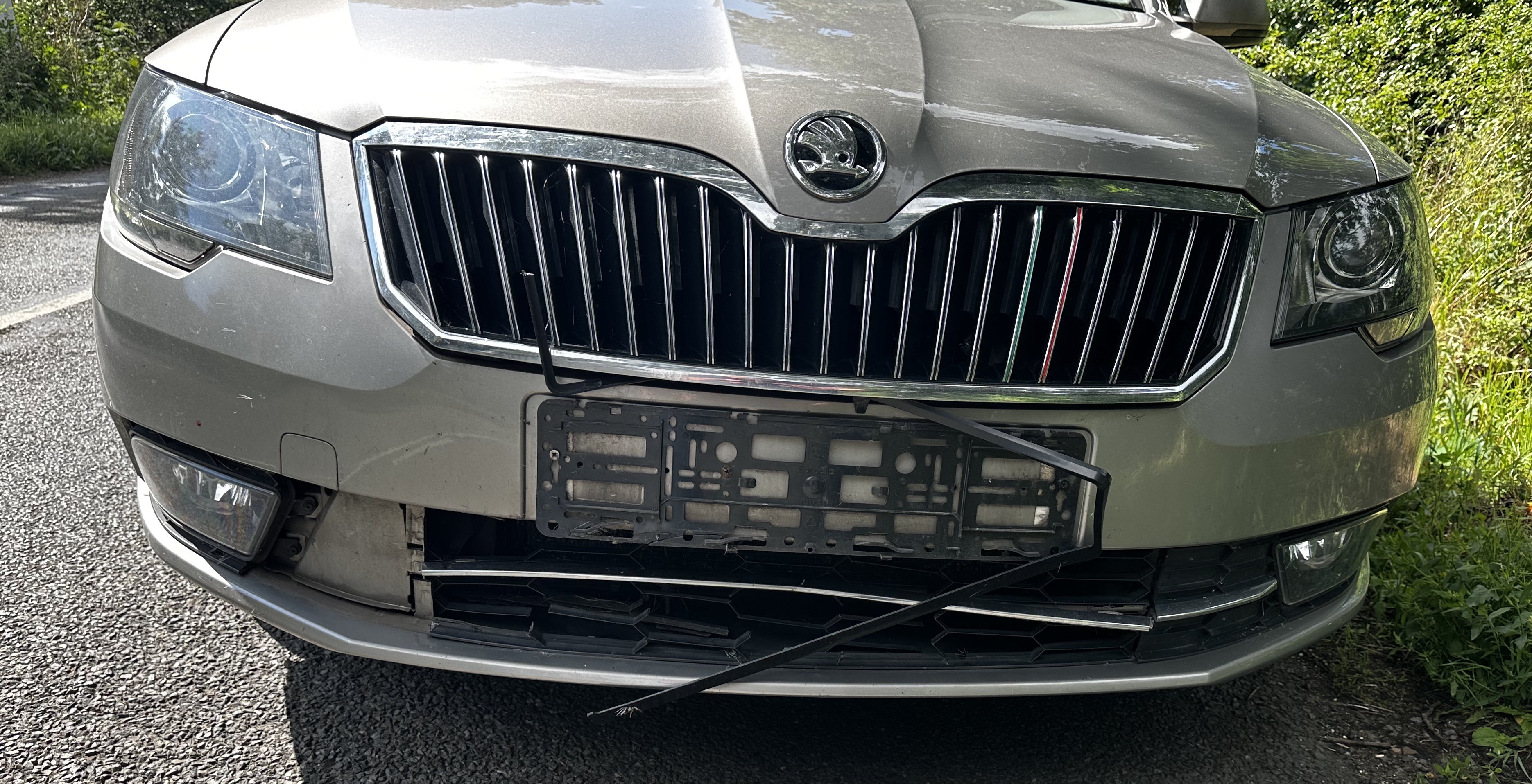

  6. So, last weekend, I had the misfortune of meeting a Muntjac deer whilst on my way home from King's Lynn... Damage was (on first inspection) fairly light, and - importantly - didn't seem to need a replacement bumper. So I drove down to Wings Škoda in King's Lynn early this week and had a chat with Andy, the very helpful parts chap. I ordered three new parts - the lower grill, the chrome strip for the lower grill*, and the expanded polystyrene bolster that sits between the front crash bar and the front bumper. Total cost £180ish... My mate Dave and I started work this morning... With the front bumper removed, the damage looked awful...

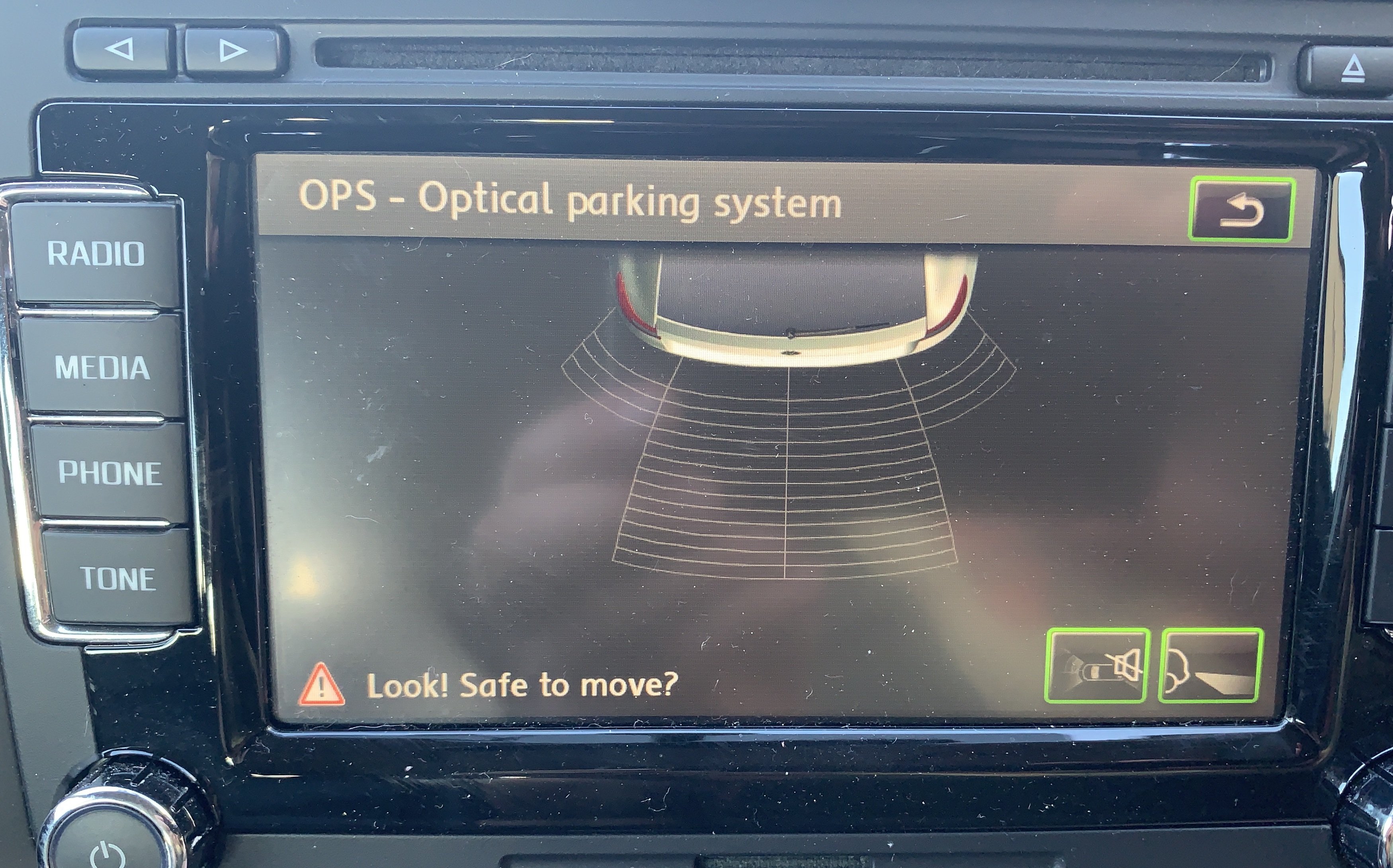

  23. Hi there, 2014 Škoda Superb VIN TMBME73T4F9023013 2.0TDi 140 4x4 estate. Overall, I have been pleased with my first year of ownership. However, there are a few minor niggles that I'd appreciate some advice on: 1. I have a Columbus multi-function system fitted, which strikes me as slow to operate, but is pretty good otherwise. Is it possible to set a default scale on the map whenever it is turned on? Living in rural Norfolk, I want minor road detail on all the time - which only comes on at 400yds and below, so I'd like the default scale set to 400yds. 2. I am unsure what version the maps or software in the GPS are, or how they are updated. 3. Although when selecting reverse I get a screen saying it has 'optical sensors', which work fine, it strikes me that a reversing camera would be a good addition, displaying on the Columbus screen - is this possible? 4. Can I get the folding mirrors to fold immediately I lock the vehicle (like every other vehicle I've owned with folding mirrors🙄)? At present, I have to keep the lock button on the remote pressed for five seconds or so before this happens. 5. Whilst we are on the subject of mirrors, can I change settings so that the heating elements come on with the heated rear window (again, like every car I've ever owned🤦‍♂️)? I honestly thought they weren't heated, until I stumbled across a post here about it - whose bright idea was that? As I said, all minor stuff, but fixing them would make the car more enjoyable to use. Any advice appreciated... Thanks, Mike 😎
