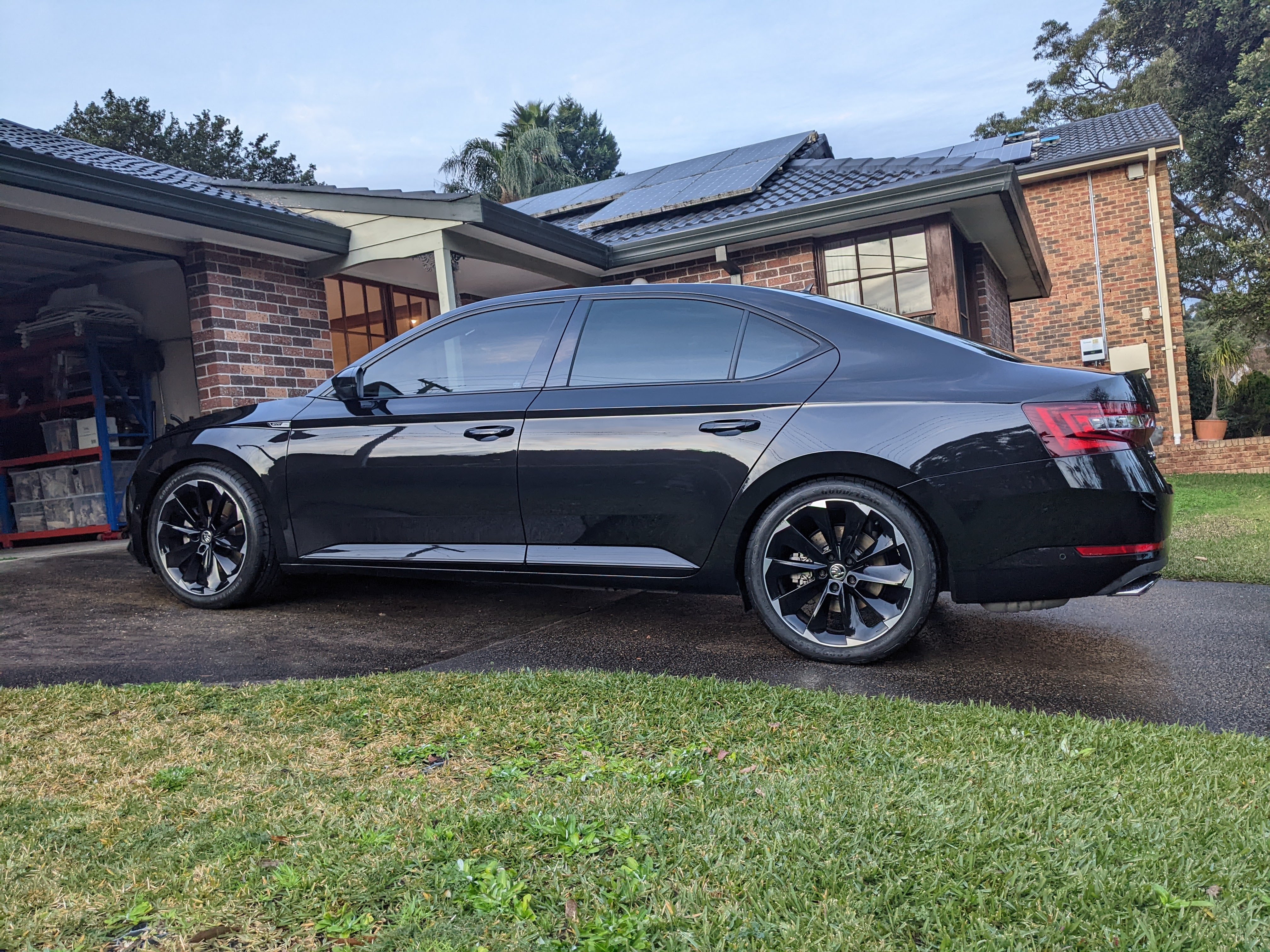

  19. Here is my 2019 Sportline 4x4. Best/worst colour choice and was dirty again 5 minutes after this pic was taken. Currently Stage 2+ ECU & Stage 3 TCU tuned by TVS. Sitting on Eibach Pro's, with 245/40/R19 rubber.
