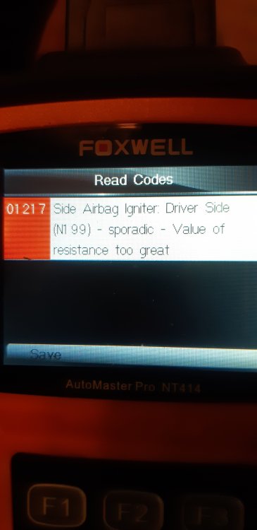

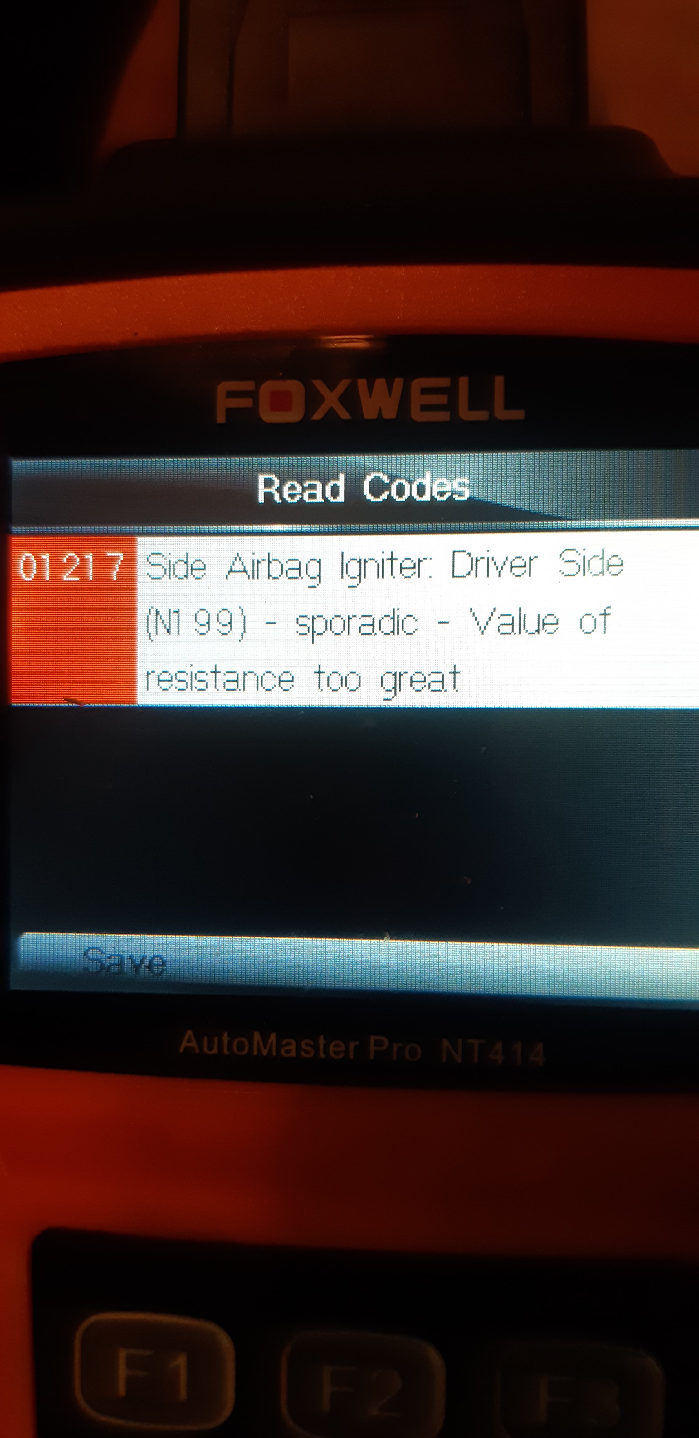

  3. Found plug under drivers seat. Just dangling there. I couldnt get my hand in properly to unplug it (big hands) only jiggle it. But something happened, light has gone out πŸ€·πŸ»β€β™‚οΈπŸ€·πŸ»β€β™‚οΈ
  4. Using a Foxwell reader
  5. Thank you, I only have the Foxwell tool which is generic. I can read codes and erase but that's as technical as it gets. I will look at both front seats and have a dig around, and you are correct no rear bags on this one
  6. Hello all I just bought myself a 2009 Fabia3 The 01217 light has come on and it seems that a plug is at fault according to a google search😳 My question is, is this true and where do I find this plug, front or rear seats, Driver or passenger side Thank you
  7. Hello, just bought a 2009 fabia 3 with this light. Under which seat do I look as I cant seem to find this block Front or rear seat ? Driver or passenger side?
