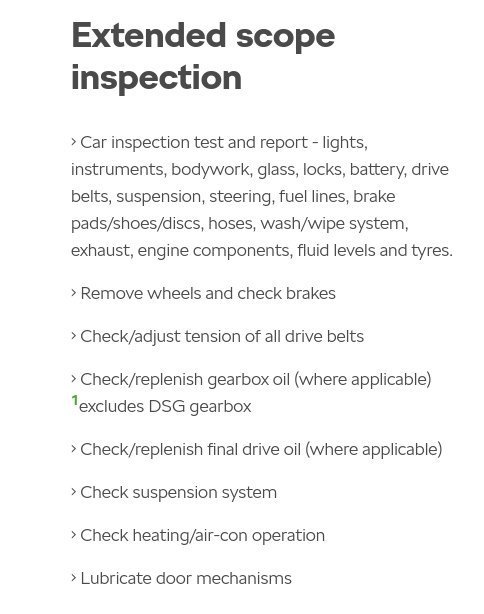

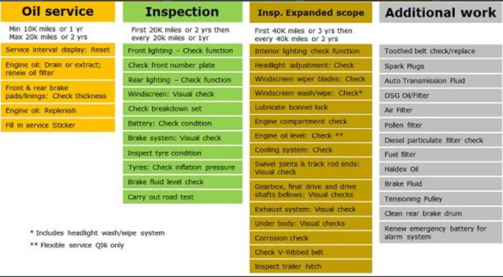

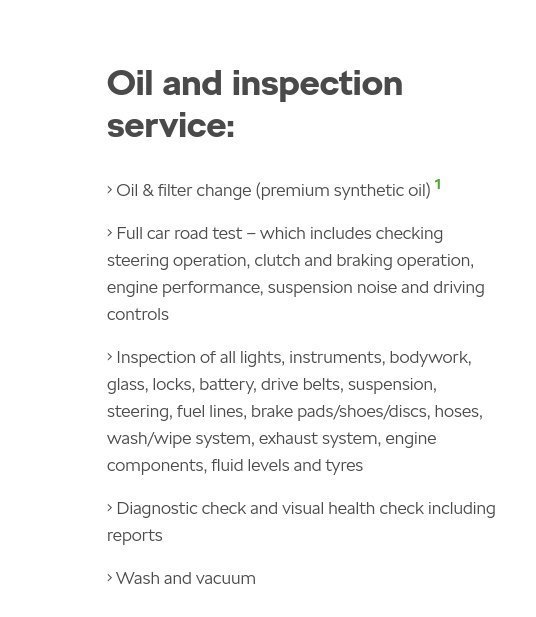

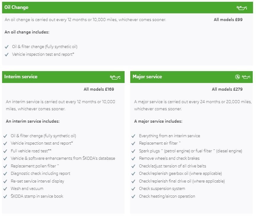

I can give an idea what Skoda used to do or say they did, and what things are now.
What engine is it.
Oil & Filter changes every year. 9,400 miles.
Air Filter, Pollen Filter when needed, Brake Fluid changed maybe every 2 years.     Check, inspect, when ever, do what you think needs doing.
This Green Chart is approx.  More recent terms for services.
1179912860_922218293_Screenshot2022-09-2115_58_57.jpg.3711dc86397a804fc83f268add4ae736(1).jpg.606196-2532f67305f1ec411800c6.jpg.f55e174e557c210d50efea570a141160.jpg.ae2b7033dd7bc736f1c4b4d75ec1ce6b.jpg
1039190636_Screenshot2021-09-29at07_53_36.jpg.994d2b104123865330d493df0f73629e.jpg.469b173dd8ff2b7c1980f902f406fe61.jpg
1025295341_Screenshot2021-09-29at07_53_17.jpg.f3e4a6dc63cb89105f9b1ac440bb1614.jpg.1a83aff70ed152245067b78901bec0e3.jpg
827614452_SkodaFixedPriceServicing.JPG.3dbea7606c029076ed94e2f0216199b6.jpeg.689c25a185d90e4e44889f342770023b.jpeg

Another Skoda service  shedule "lets make some money boys" if your car is over 3 year old get it done yourself use genuine parts but don't pay Skoda prices, quoted for our 2 year old Fabia mk3 1.0 TSI £356.00 that was 4 litres Castrol fully synth oil, oil  filter and a pollen filter, bought the oil for £45, filter was £13.75 , and a pollen filter carbon type £38 a new sump plug and washer non genuine but the same £4.95 as they wanted £18 for one, checked the car over no need for brake fluid after 2 years unless you have stupid miles on the clock , this is not done in the shedule but they try and scam you into a air con service £170 plus but you can get this done / checked a lot cheaper if needed eles where, the air does use the new type gas so it is more expensive but most seem to charge you if you need gas or not

thats the kiddy, its the 1.4 petrol.
just needed a chart of what to change and when
thank you
