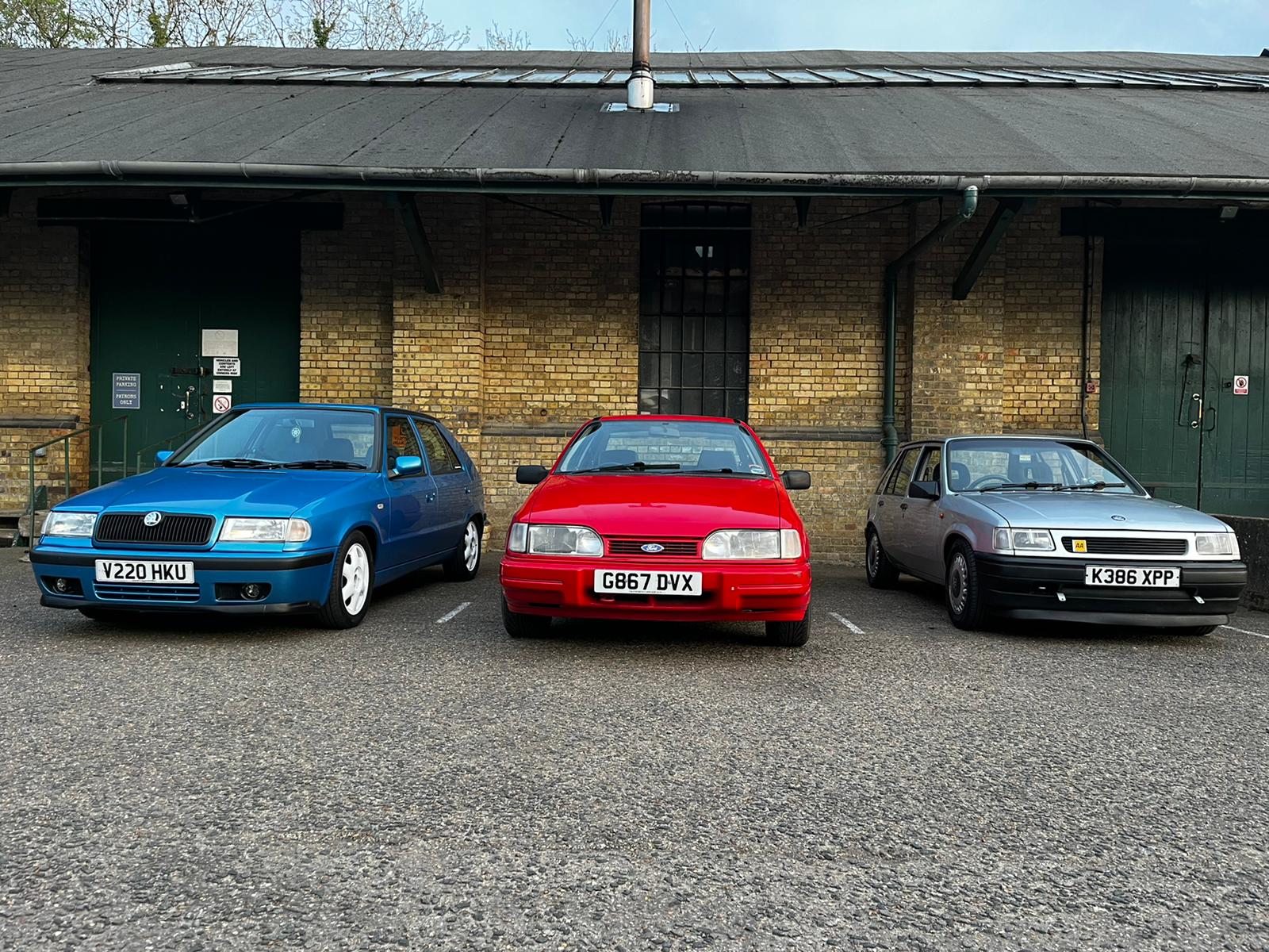

This is my 1999 Felicia Pacific 1.3 MPI that I'm going to hopefully fit a 1.8t 20v Bam in. Modifications I've already done include 15" vauxhall cavalier wheels. Lowering springs Seat Leon cupra front splitter Two rear wings fitted and painted along with both sides of the car because the arches were rusty. And a couple of little bits and bobs along the way. I really love driving this car but I want it to be a complete animal so it's getting 1.8 20v turbo and some handling and braking mods to go with it. I'll be posting as soon as I get the axle back from powder coating.
