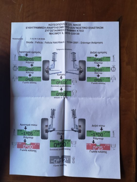

Well caster is conservative and camber.
Adjusting the rear lower wishbone mount will give you one to the detriment of the other.
Generally speaking caster provides in corner camber gain and feedback so yes i think that is the more important to adjust angle
20 hours ago, Papez said:
Felly has pretty low caster angle, so many people racing them are looking for various methods to increase it
my alignment settings, I would like to change the front caster and camber (left wheel) and rear toe.... sadly i cannot😰
