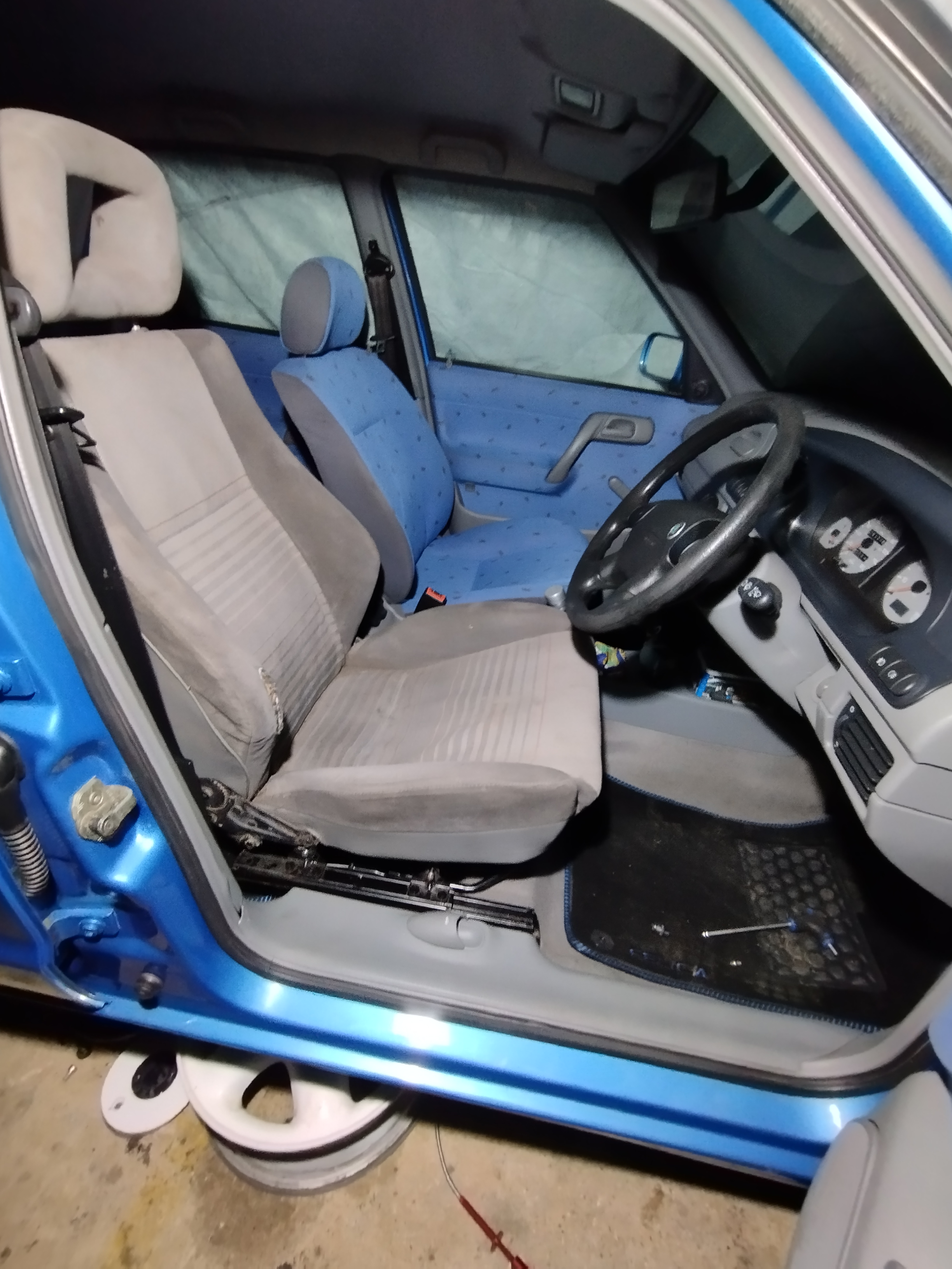

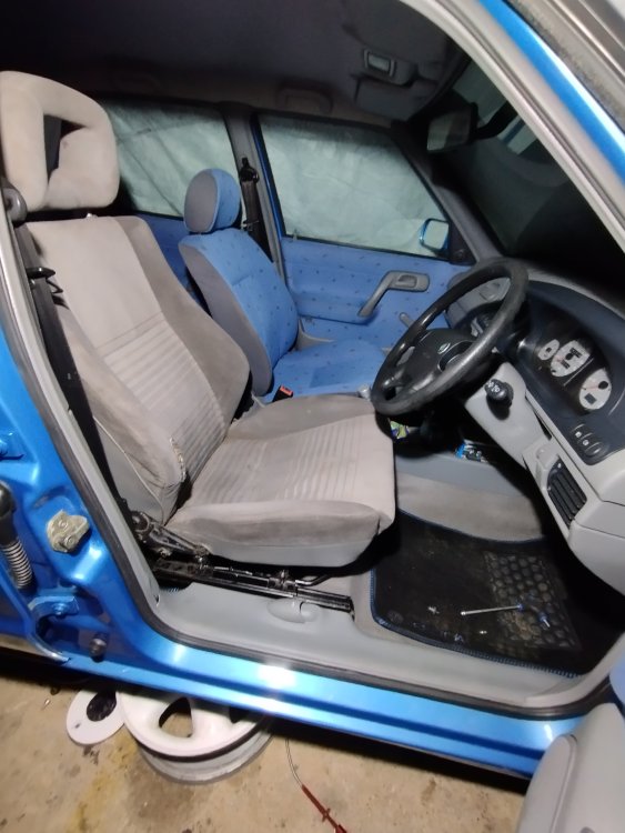

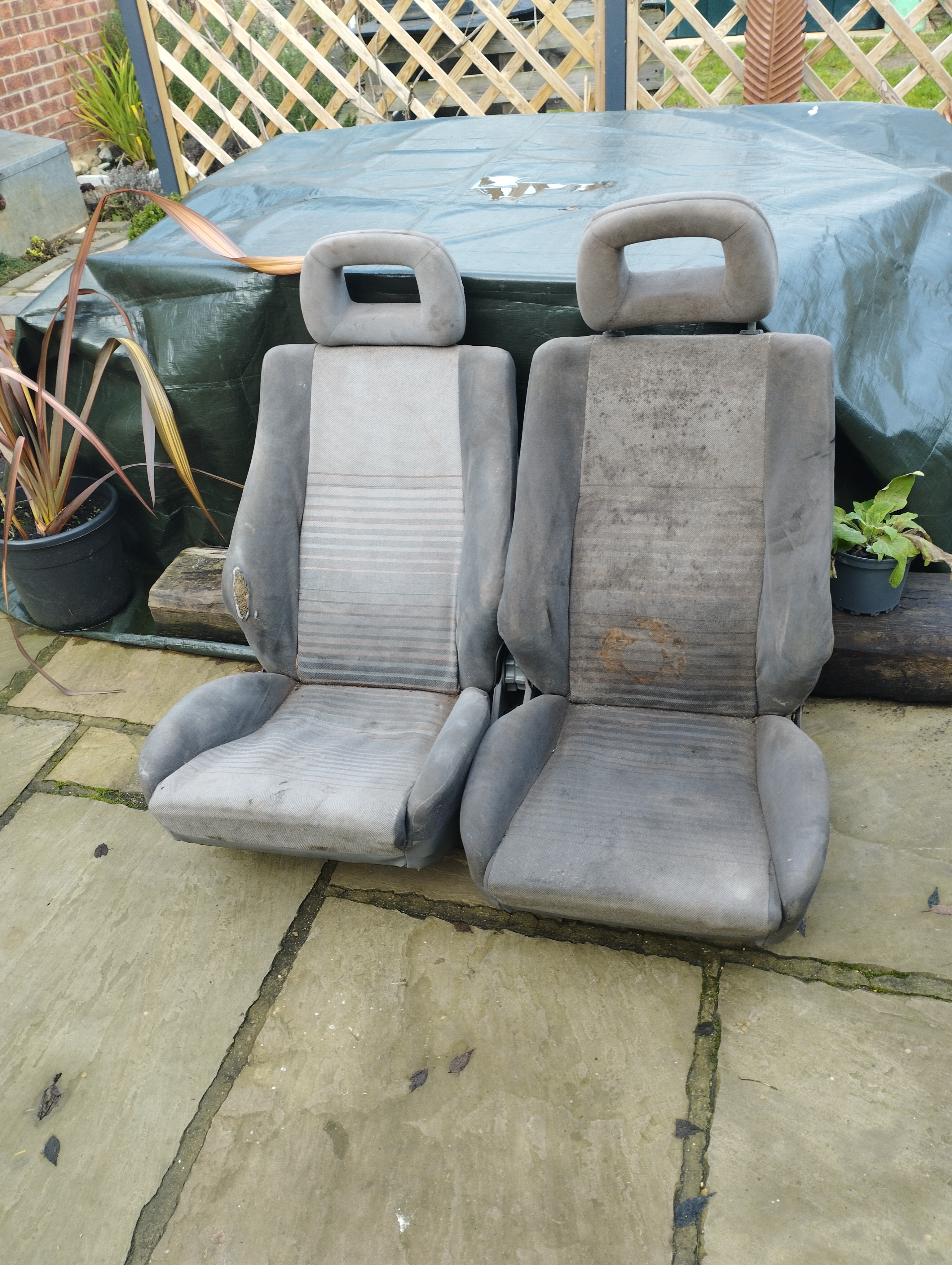

Got some new seats for it.
Vauxhall nova Sri/GTi seats
managed to make a couple of brackets for the front and the rear bolted straight on.
Gonna get them re upholstered in the original fabric

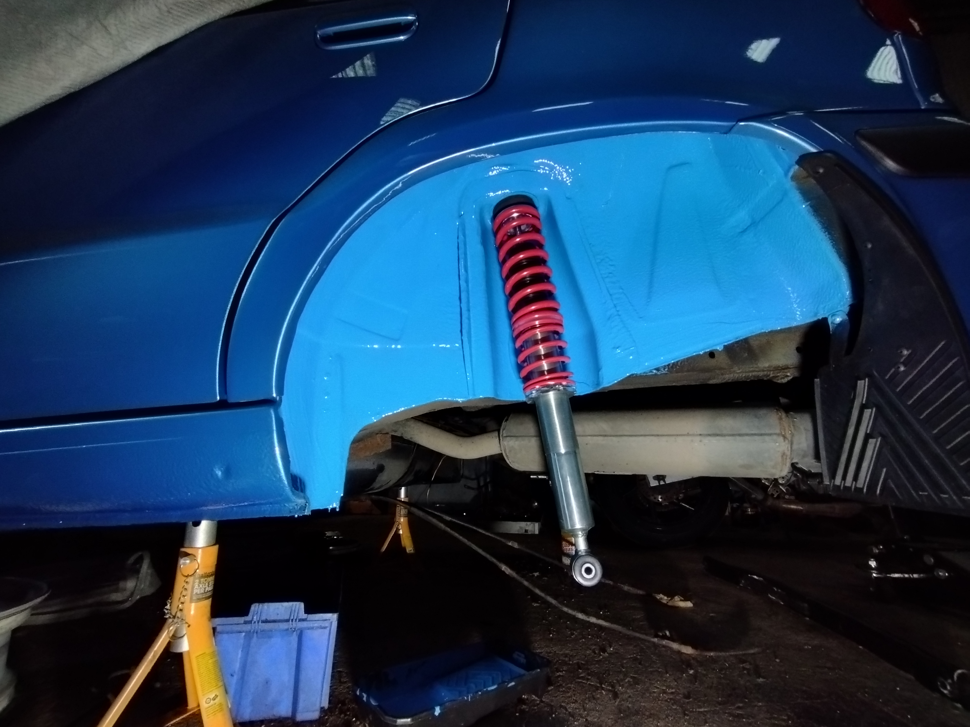

Got one of the rear arches painted. Just the rest of the car to go now.
Also got my brake calipers painted and mudflaps on. Should hopefully have the axle back by next week.
The coilovers are for a MK3 golf GTi. Has been done a few times but you just need to shave a few mill from the top spacer to make them fit with the Felicia top mounts.

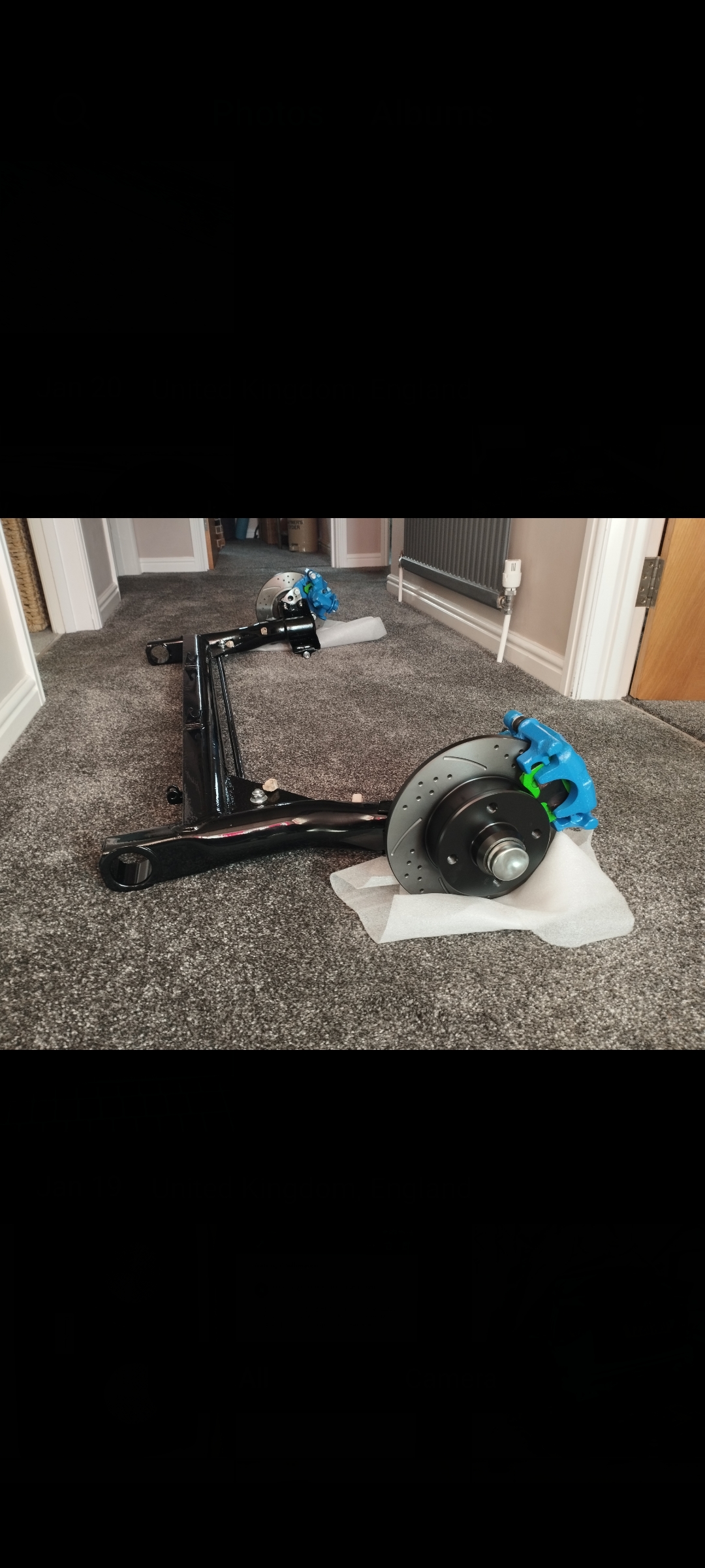

So i got my axle back from the powder coaters and it looks mint.
Installed a full MK 3 golf brake setup with EBC green stuff pads and slotted rotors. Luckily these told me what way round to put them cos i can never work it out😂  Everything from the stub axle outwards, is golf.  Just got to put in the pivot bushes and its ready to go back in after i paint the underside of the car.

Here is the axle all finished.

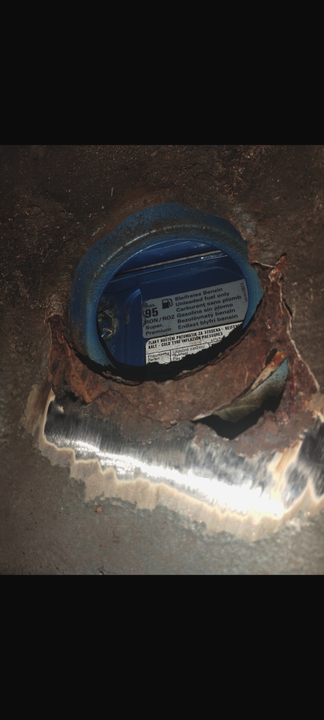

I'll use it for something one day because they are both low mileage and in really good nick so I'll maybe put that engine on bike carbs and stick it in a favorit or something. Most of the rear end is painted now but I found some rust in the wheel arch behind the filler cap. Seem like a mud trap so I'm not surprised so I'll get that sorted soon and then the axle can get put back in.

Also for any Felicia owners and I imagine favorit owners I would advise checking behind your fuel cap for rust. Beneath where the filler neck bolts on in the wheel arch. Mines is very solid car with 76k miles and it had rust here so probably worth checking as I have never seen anybody mention it.
