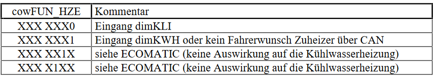

  6. I decided to look in the FR (not an expert but can get by) for some clues, below is the flow chart concering "user-shutdown" of the PTC. It's sort of implied coolant heater but it is PTC So cowFUN_HZE is referred to in DAMOS as "Cooling water heater" and in the FR is reffered to as this The other bits are referring to ECOMATIC (start-stop). We want bit 0. So if bit 0 is 0, then "Input is dimKLI", which we can confirm by the diagram. When bit 0 is 1 (Input is dimKWH or no driver requst over CAN). Basically, when the bit is set to 1, the car is provisioning for PTC heater. If we go back to the diagram, you can see at the top, dimKWH going into an OR block. dimKWH is the physical ECU pin that connects to F268 on cars with no airconditioning. This isn't present on cars with aircon. However, the fact I am able to disable by PTC by shorting this pin to ground shows that the cowFUN_HZE.0 bit is set to 1, which is a good start. Looking at the other leg of the OR block, there is an AND block with two inputs. cowFUN_KLI is a byte in memory that is used to tell the car if it has no climatronic, climatronic without CAN or climatronic with CAN. Climatronic with CAN is specified when cowFUN_KLI = 2. When cowFUN_KLI = 2, decoding of the CLIMA1 CAN frames in enabled, this frame is transmitted by the HVAC controller. mrmCAN_KLI.1 is then the "Driver request of Auxillary Heating" transmitted over CAN from the HVAC controller. There isn't really any easy way of checking what cowFUN_KLI is set to without the correct DAMOS. I have 1.9 TDI DAMOS and in those cars, it is set to 2 as expected, but it is possible they just set it to 1 or 0 in the 1.4 TDI cars. Also, this only enables the ECU side of it, if the frames aren't being transmitted by the HVAC controller, and passed by the gateway then this still won't work. Next step is to keep looking for a 1.4 TDI BNM DAMOS file, and sniff the CAN frames that are being sent from the HVAC controller. Hopefully, the HVAC controller will be sending the requried information and it will just be a byte that needs changing in the ECU flash to turn the decoder on. If the frames aren't being sent, then I'll have to look at getting a D revision HVAC controller. For clarification, the cowFUN bytes are stored in ECU flash and need to be changed the same way you would remap the car, you can't edit them with VCDS for example.

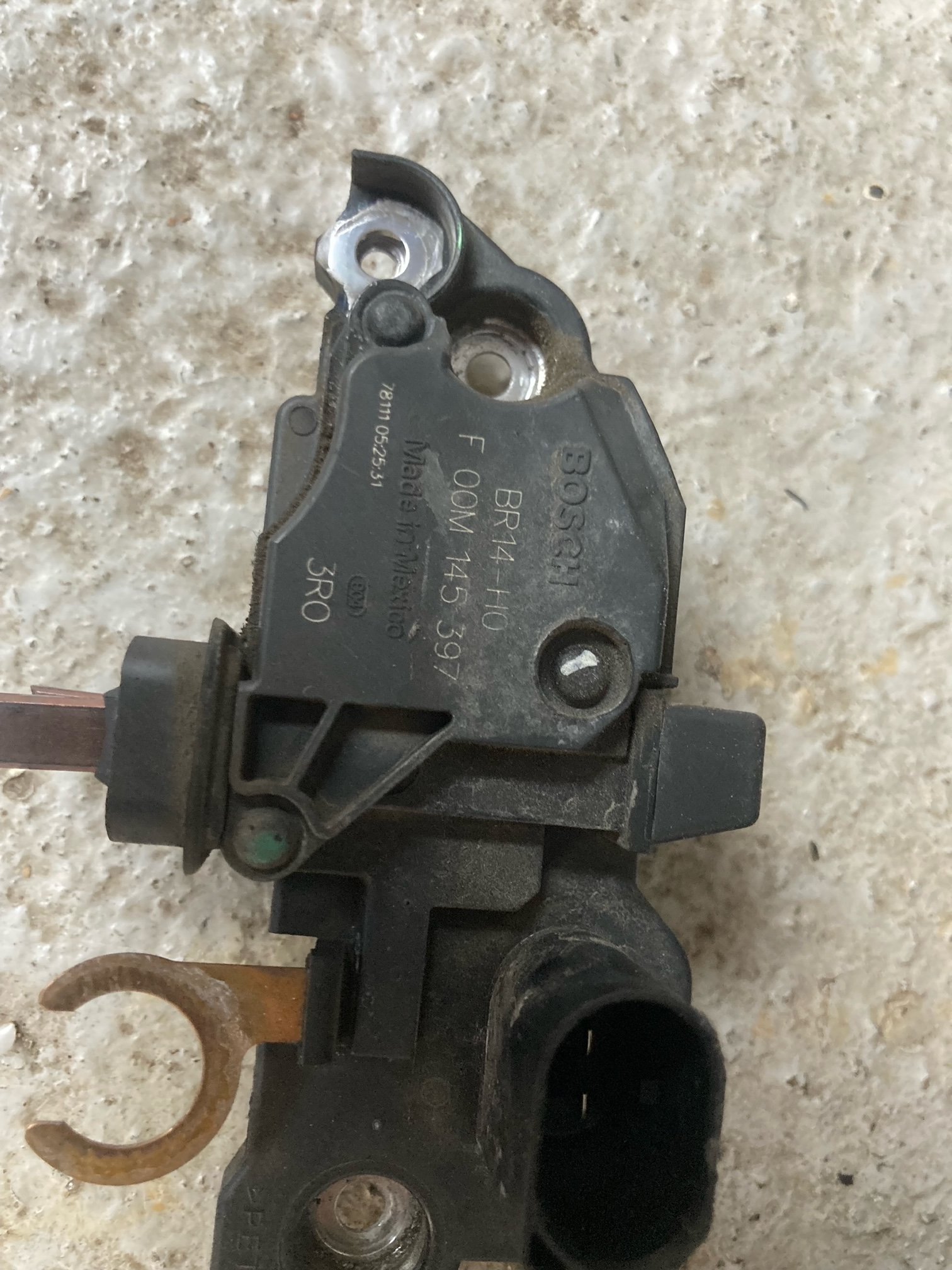

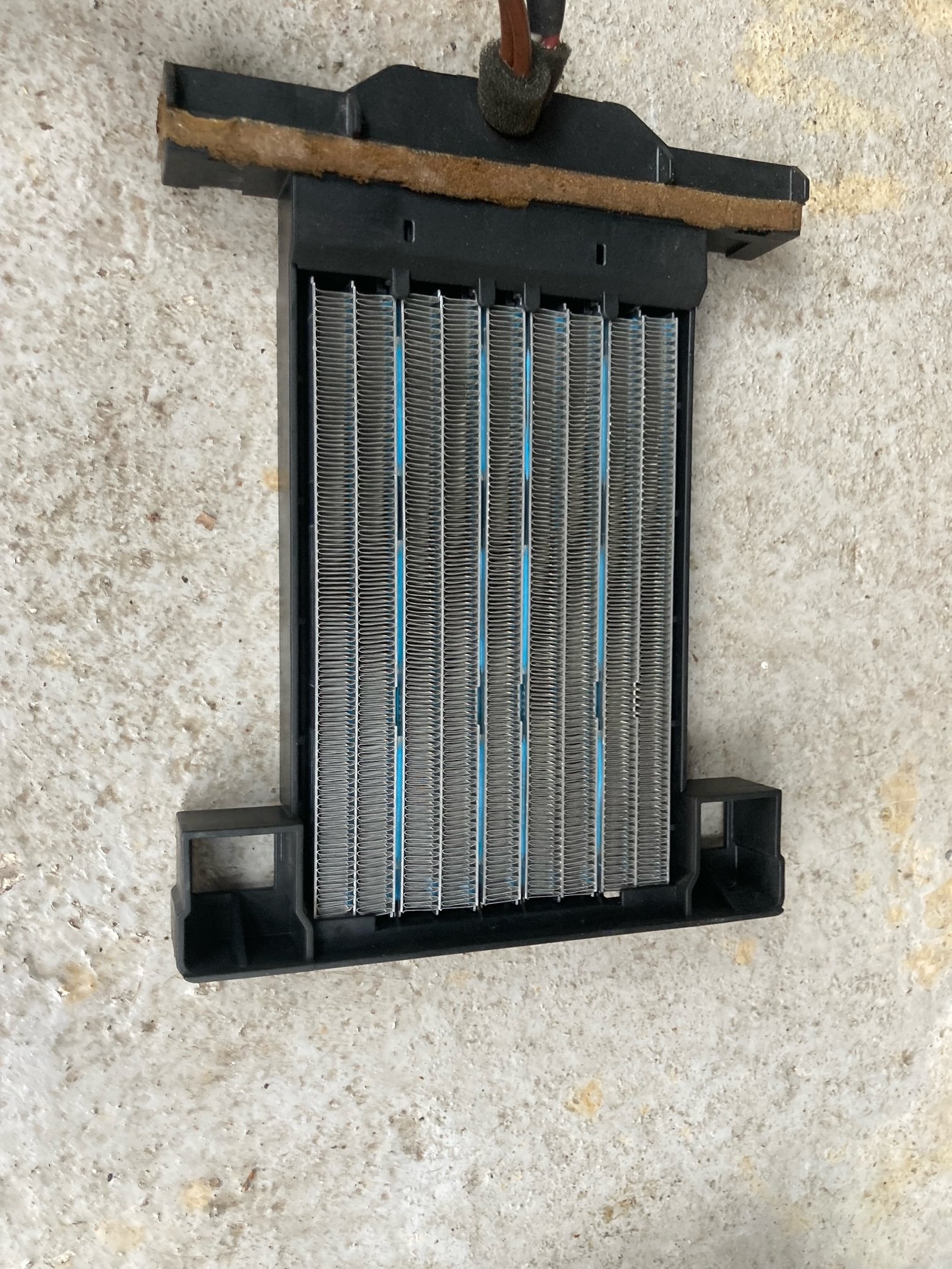

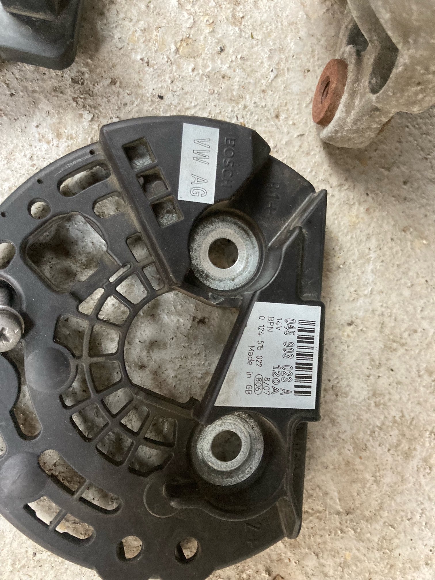

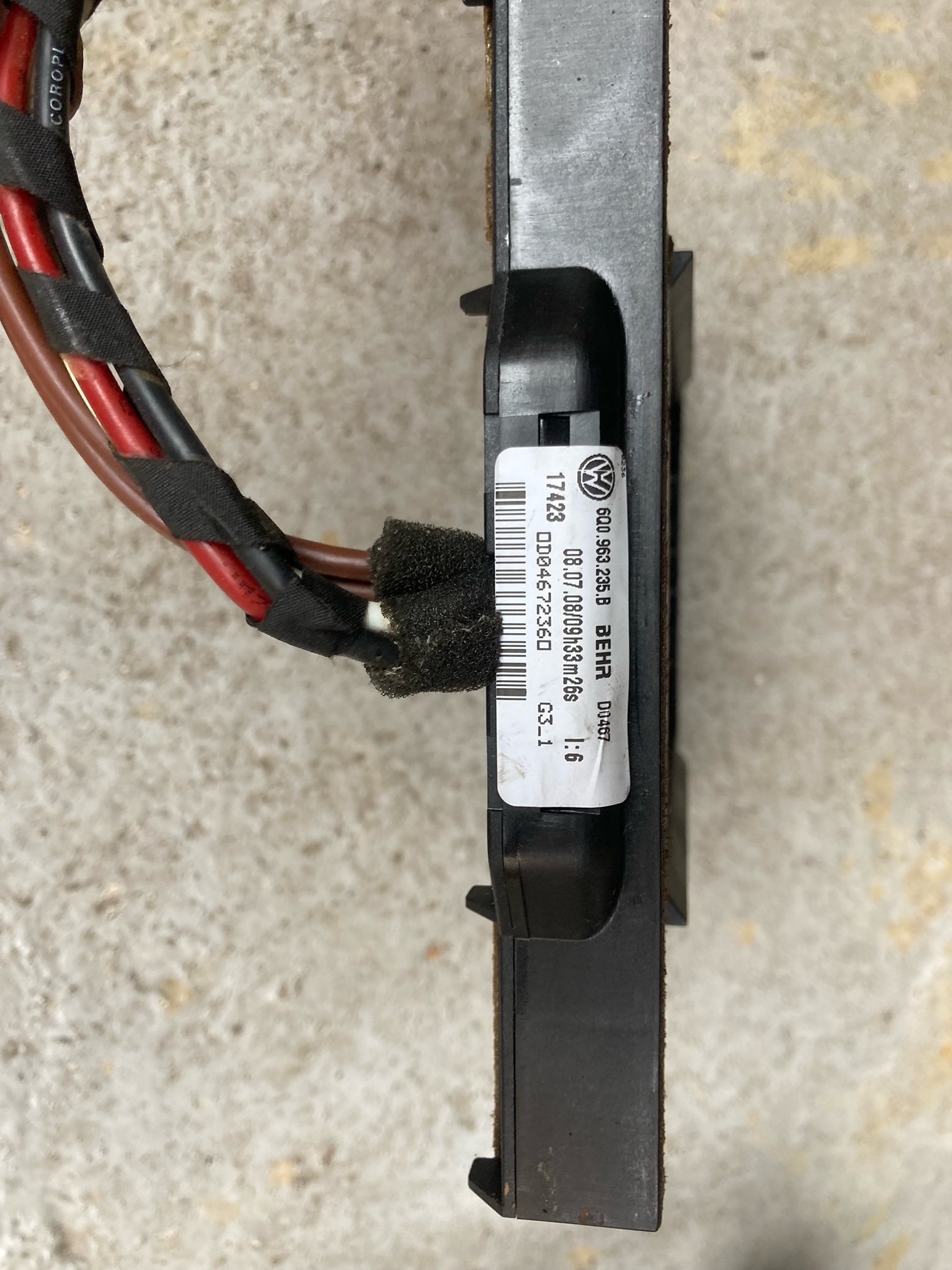

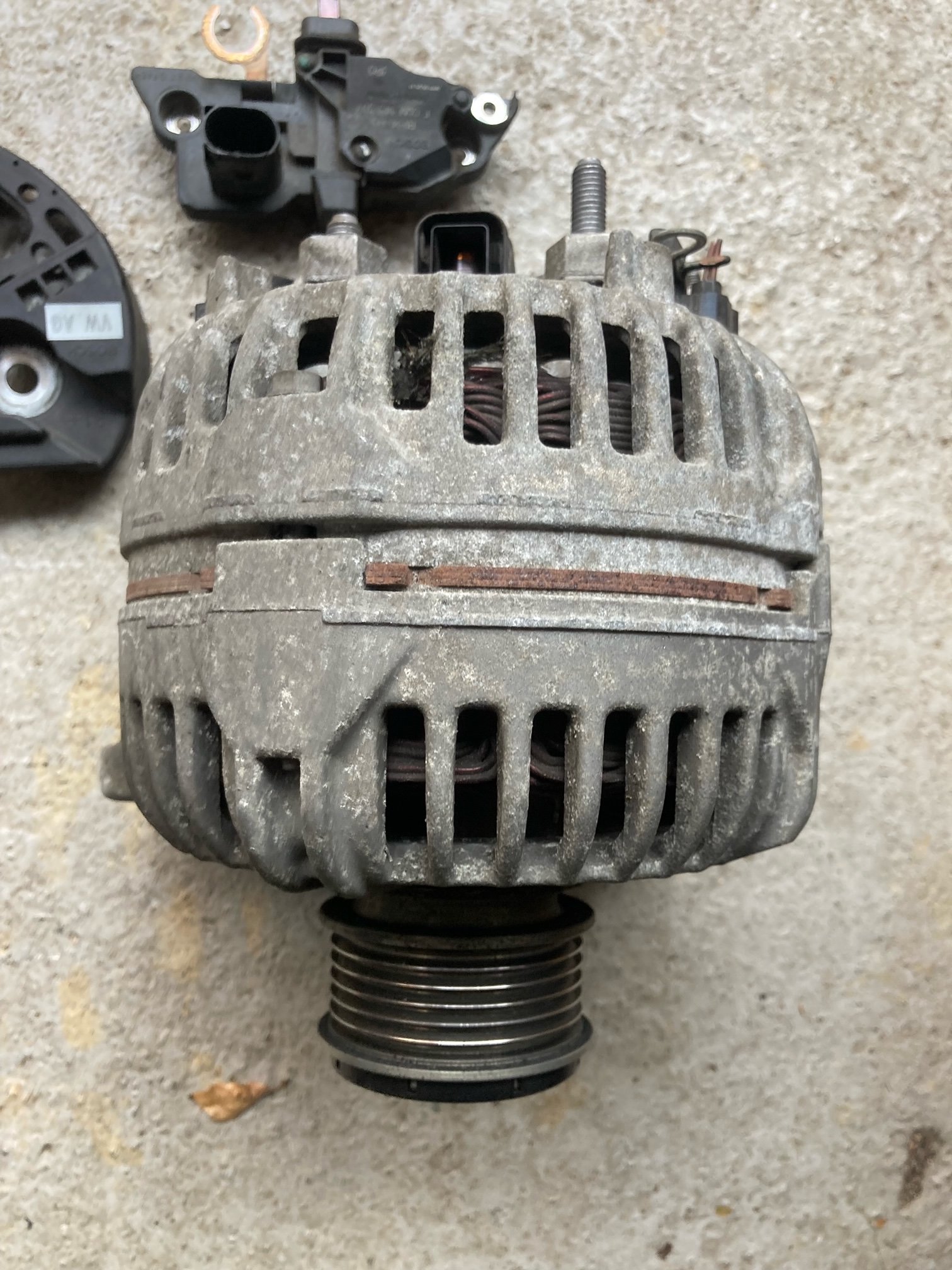

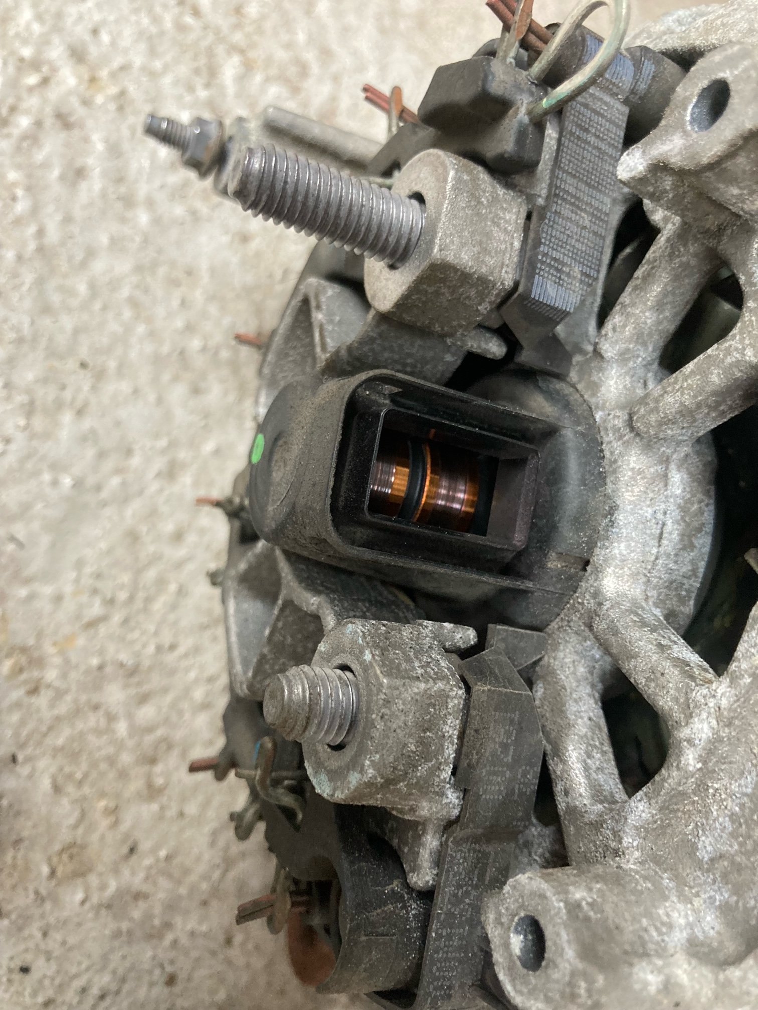

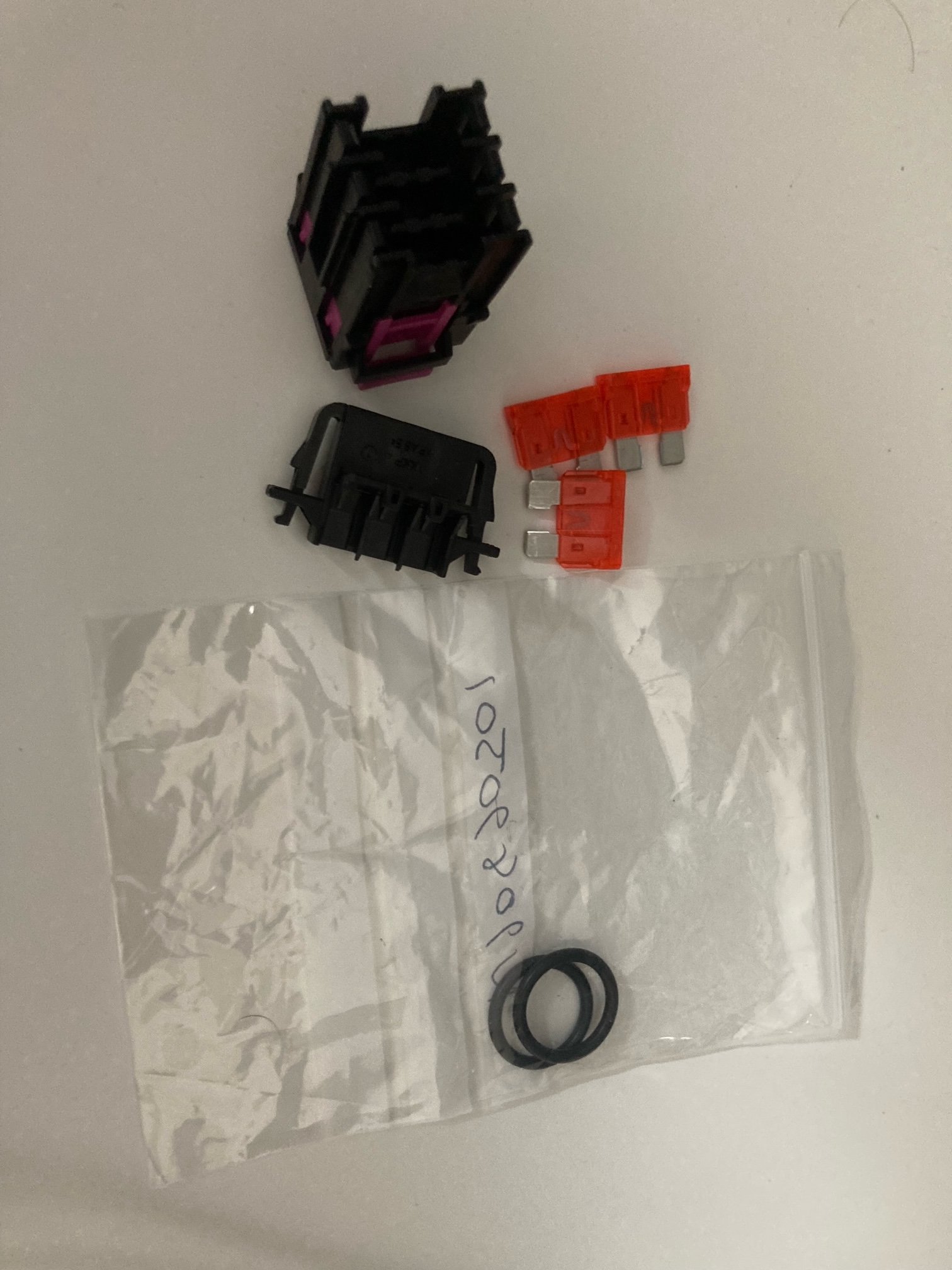

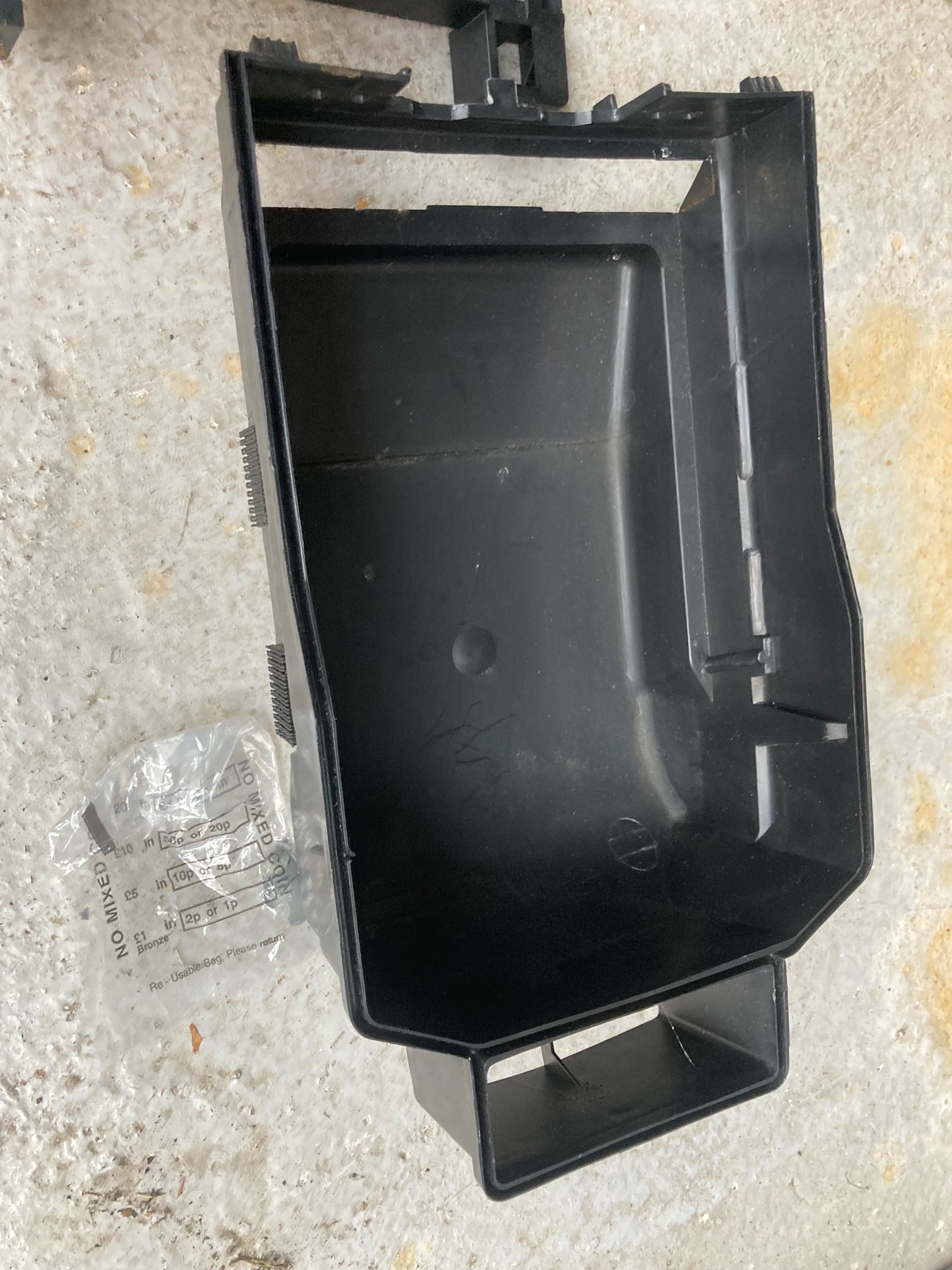

  14. Some pictures of the various parts so far. Genuine O-rings, fuses and fuse holder, along with the connector for the PTC. The second hand alternator came and I stripped it, its from a 2007 Polo, as aside from being dirty is in pretty good condtion, lots of material left on the brushes. There are some pictures of the PTC and associated lower covering too. You can see the brown residue where there was once foam tape, and its location is why I wanted something fire retardent.
