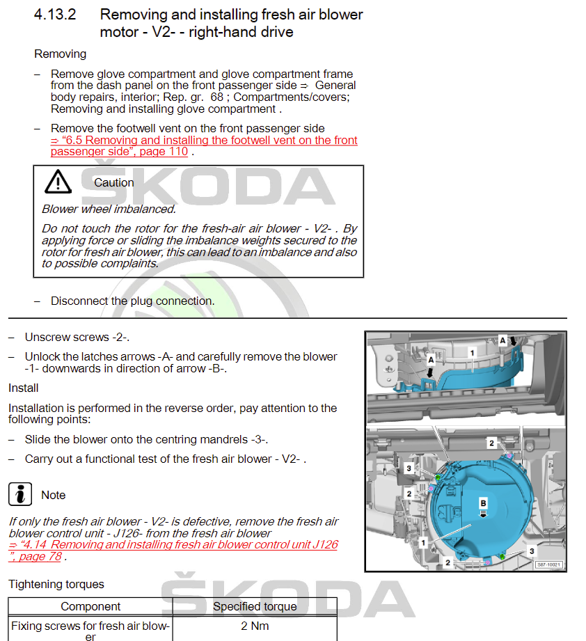

  1. Hello guys, since last year my Skoda Superb 3 2016 has some strange noises coming from interior fan, now it`s very disturbing, it works fine but the sound ****es off my wife. It`s a diy or it`s complicated ? maybe it has a lot of dust, I am not sure if it`s needed to be changed, I found this photo in this forum.

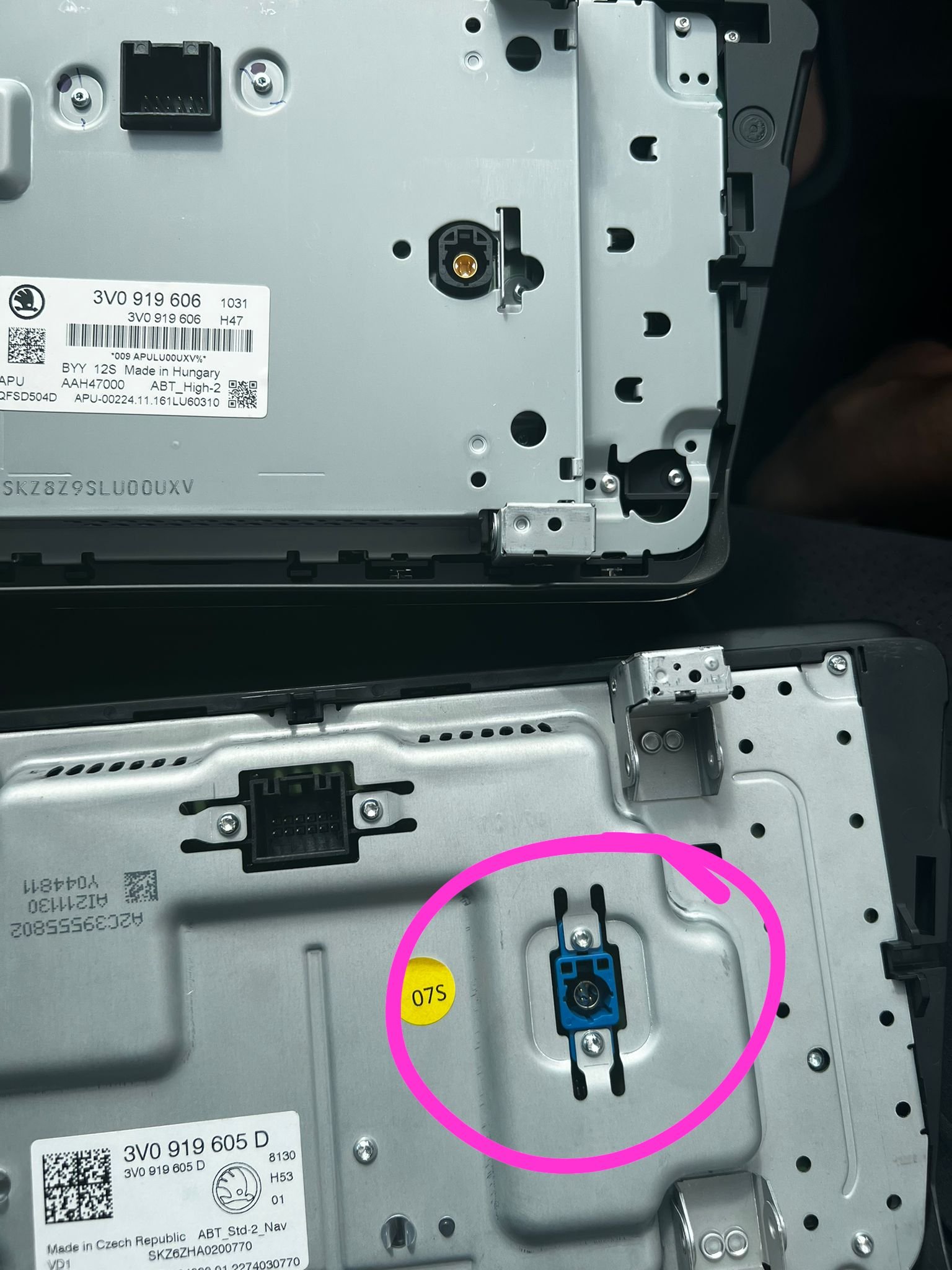

  7. Hi, I also saw that item for sale, I was thinking of buying it just for the motherboard.

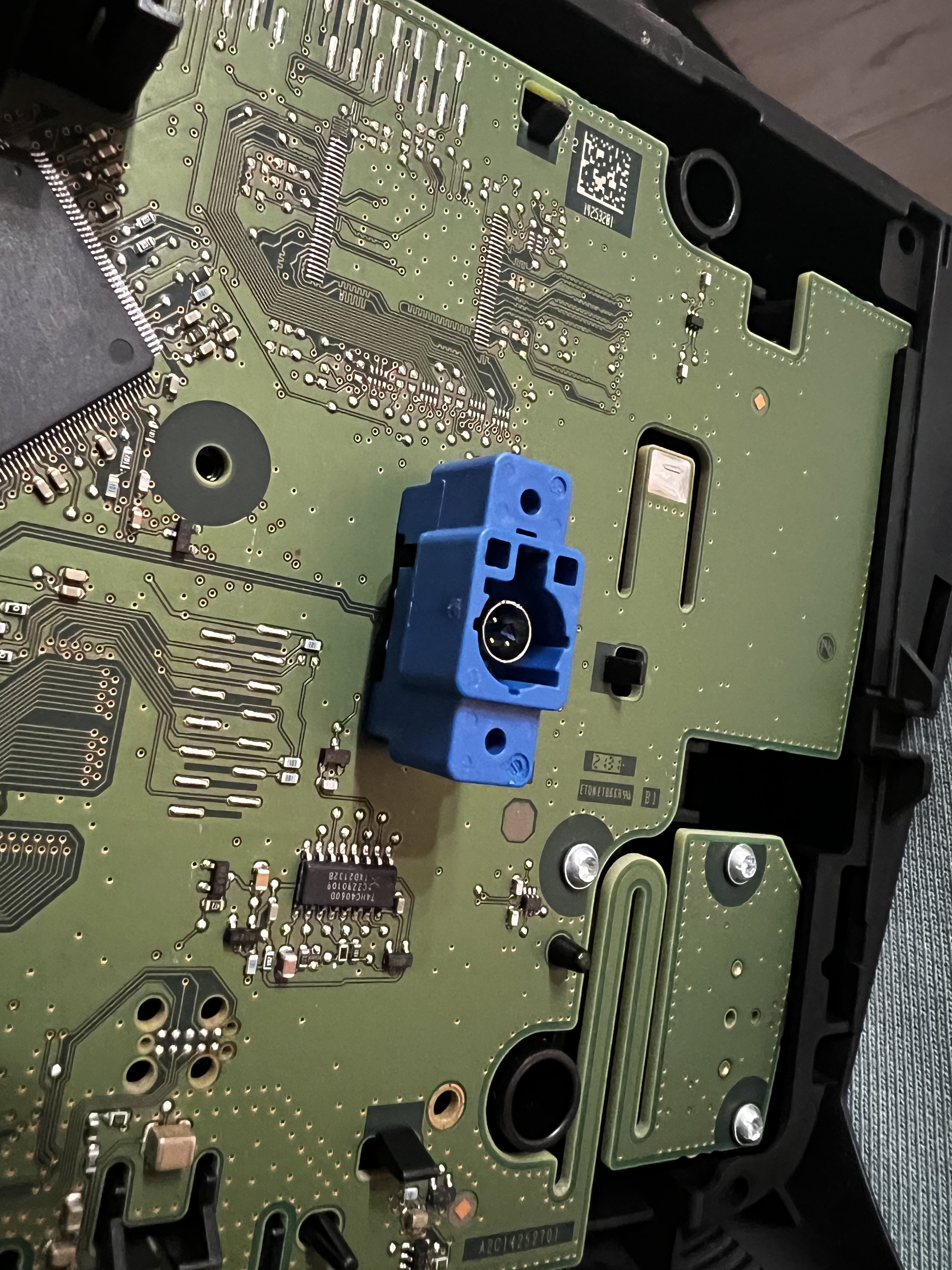

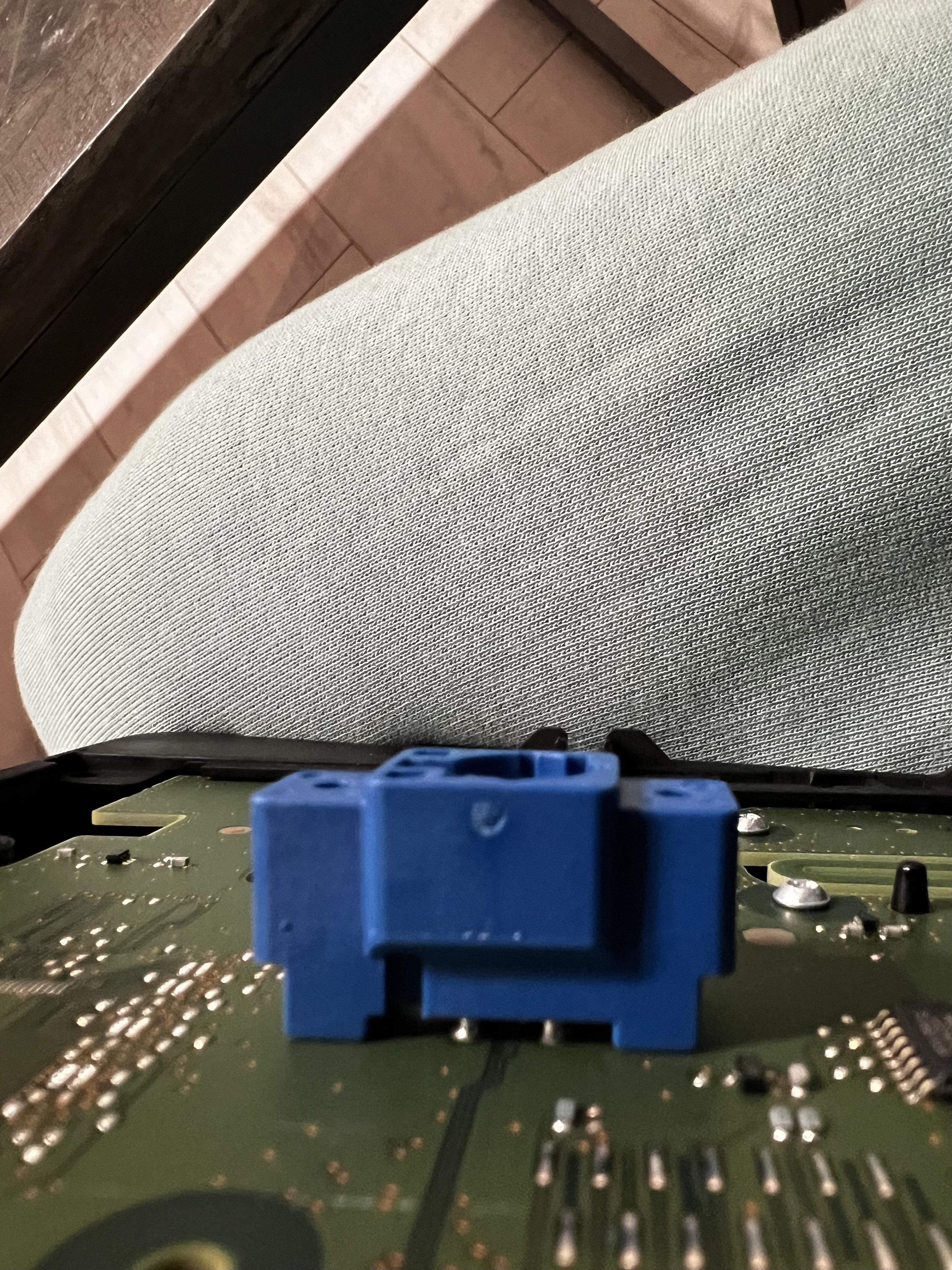

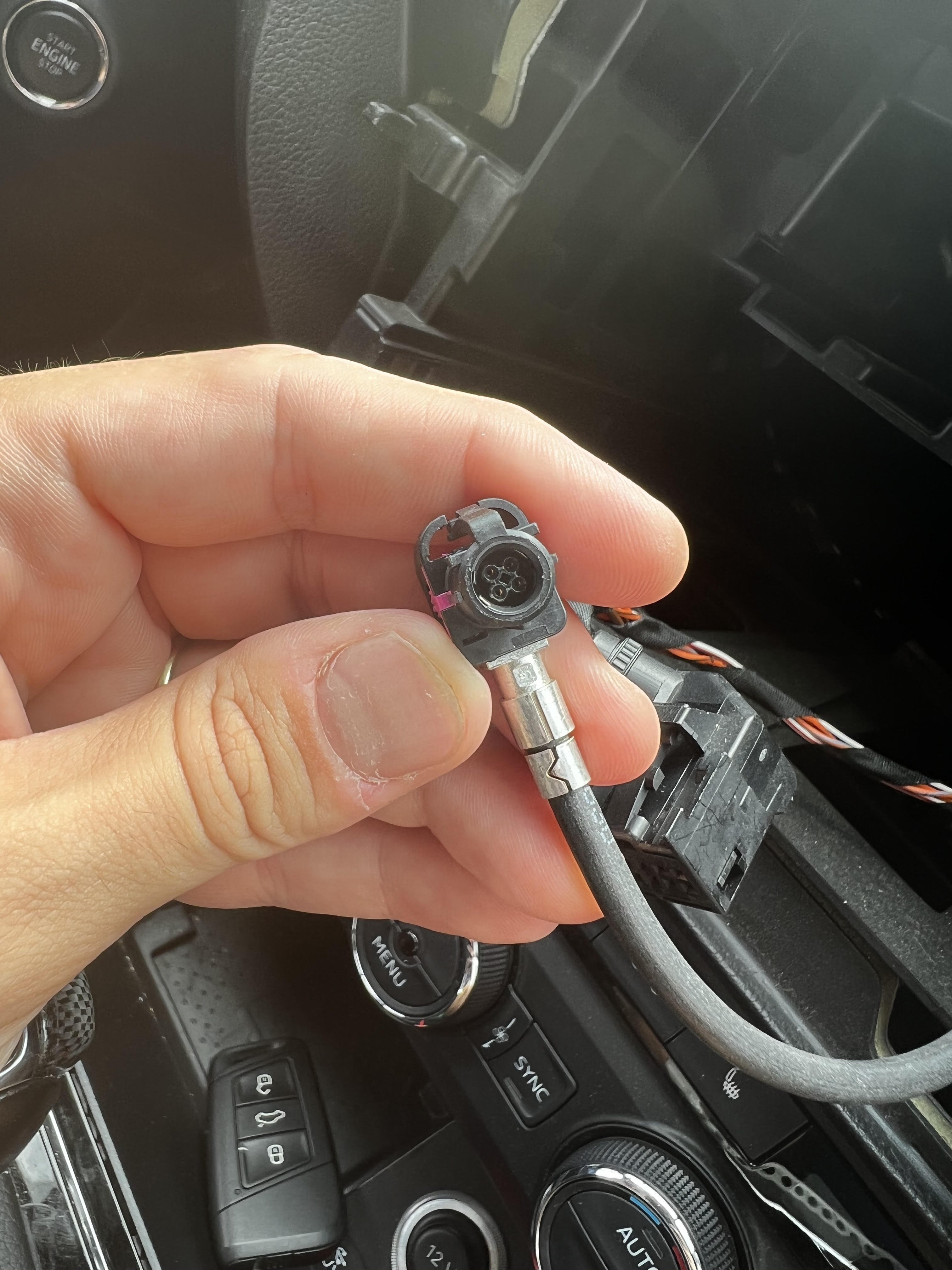

  8. Someone confirmed me that it works if I swap the display. I was just wondering will it work in 3 pins ? I dismantle yesterday evening the board to take a closer look, I need to go to an electronist to do the soldering well... I am ordering one from Aliexpress . Thank you all for the info.
