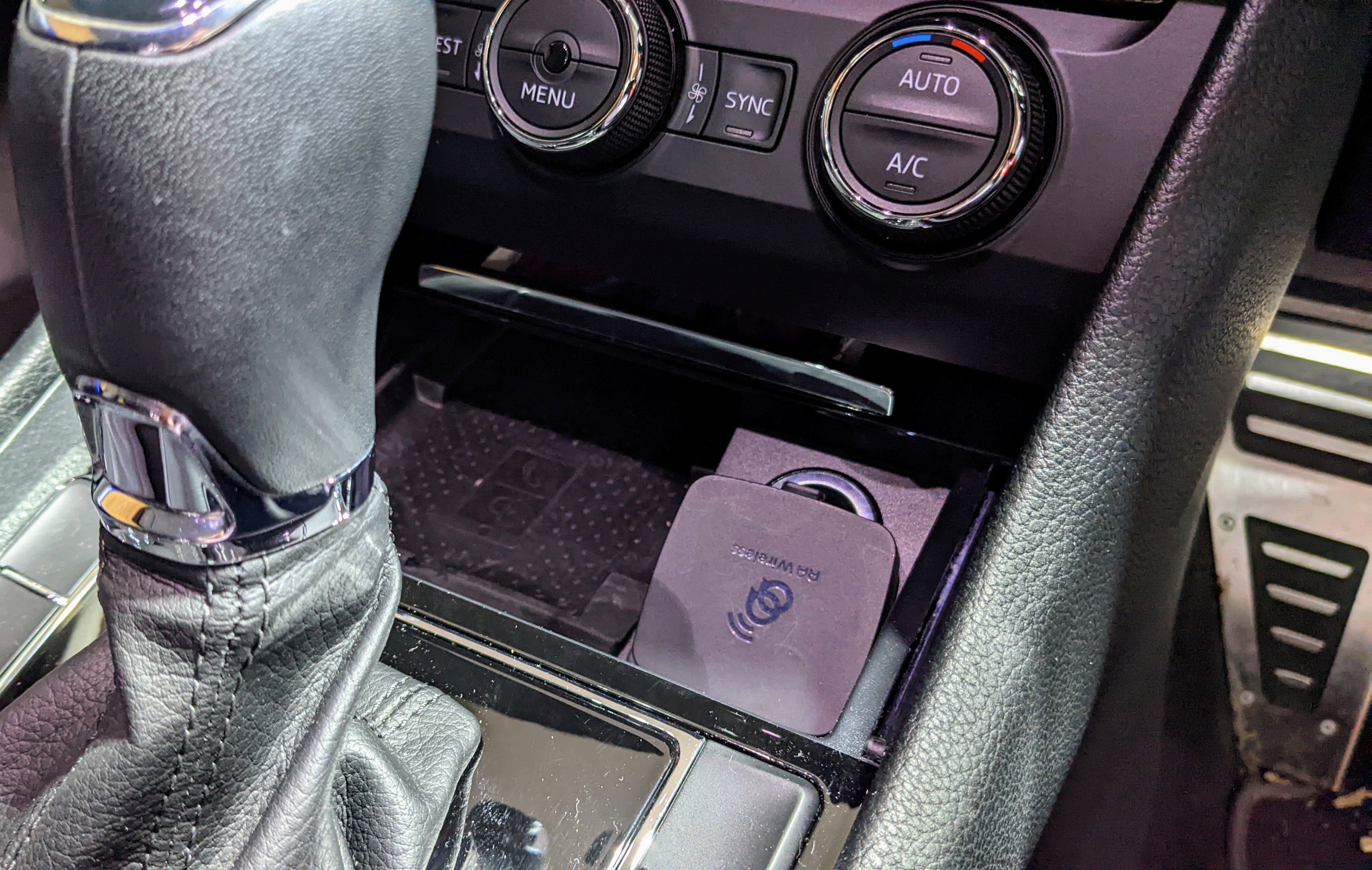

I'm using a AAWireless device to get wireless android auto in my Superb MY17.

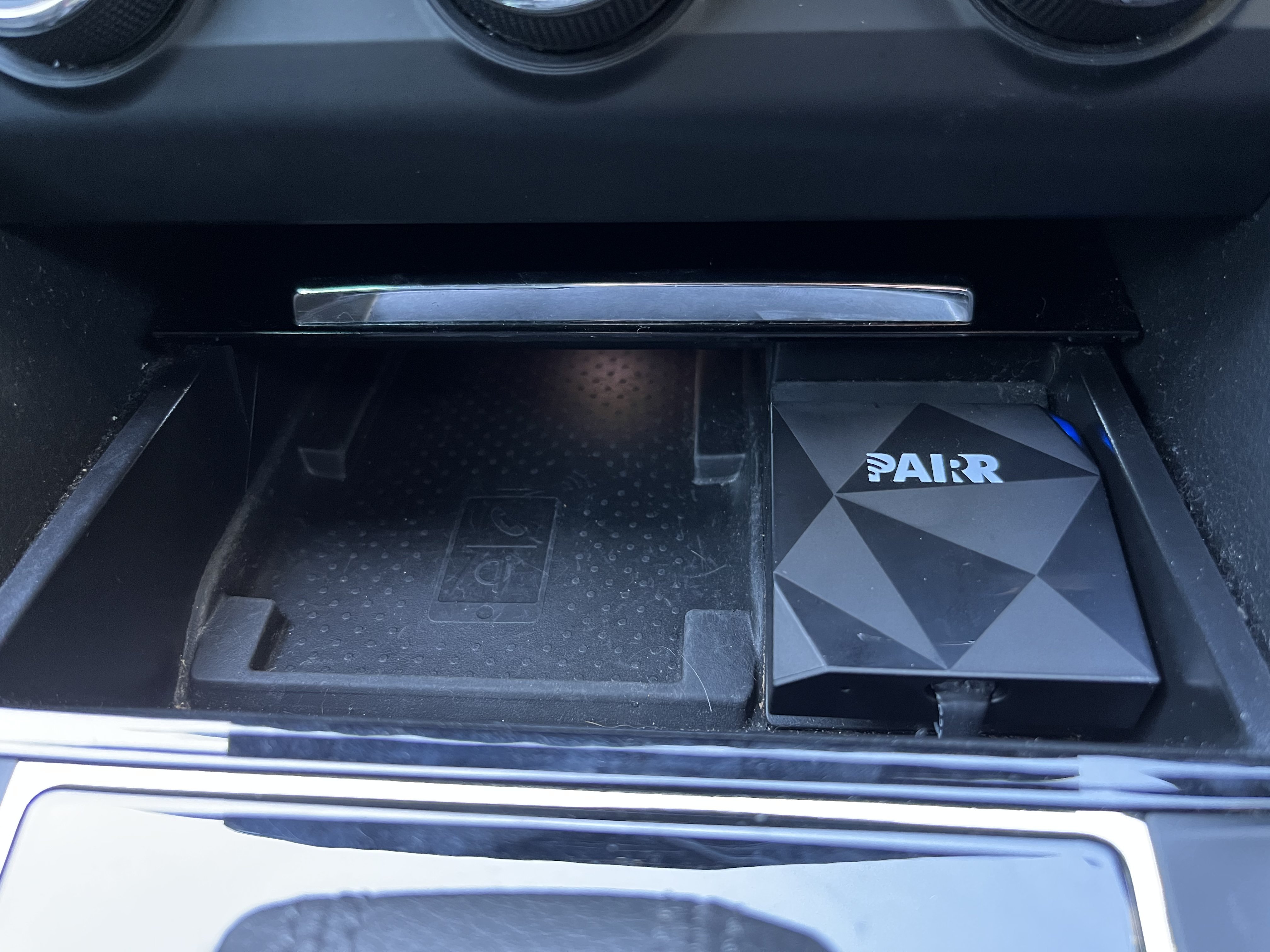

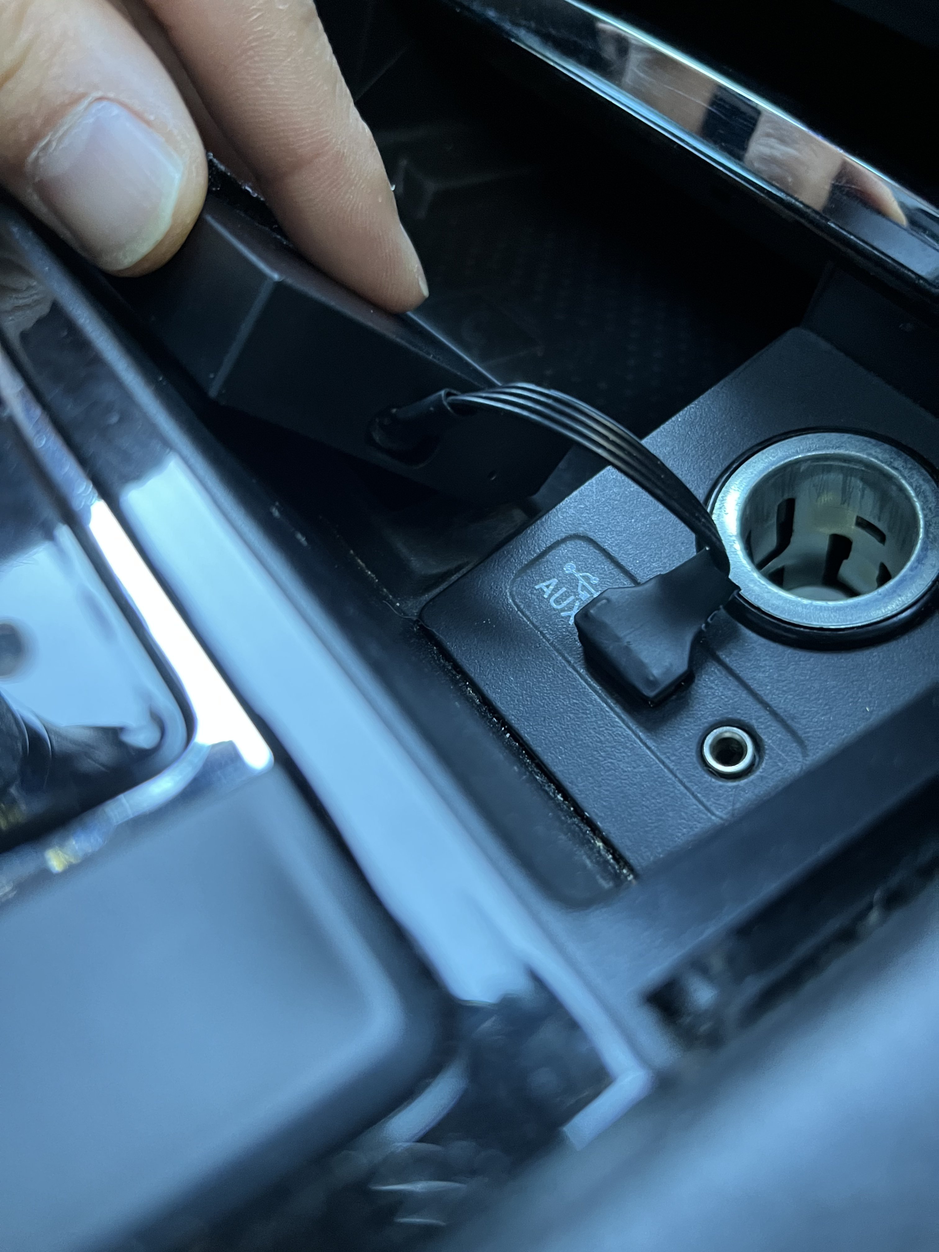

Link here.
The small square ones fit in the space on top of the 12v socket nicely. Get your low profile USB-A to USB-C cables on AliExpress and use some velcro tape etc to affix it. The cover slides closed on top of the unit.
