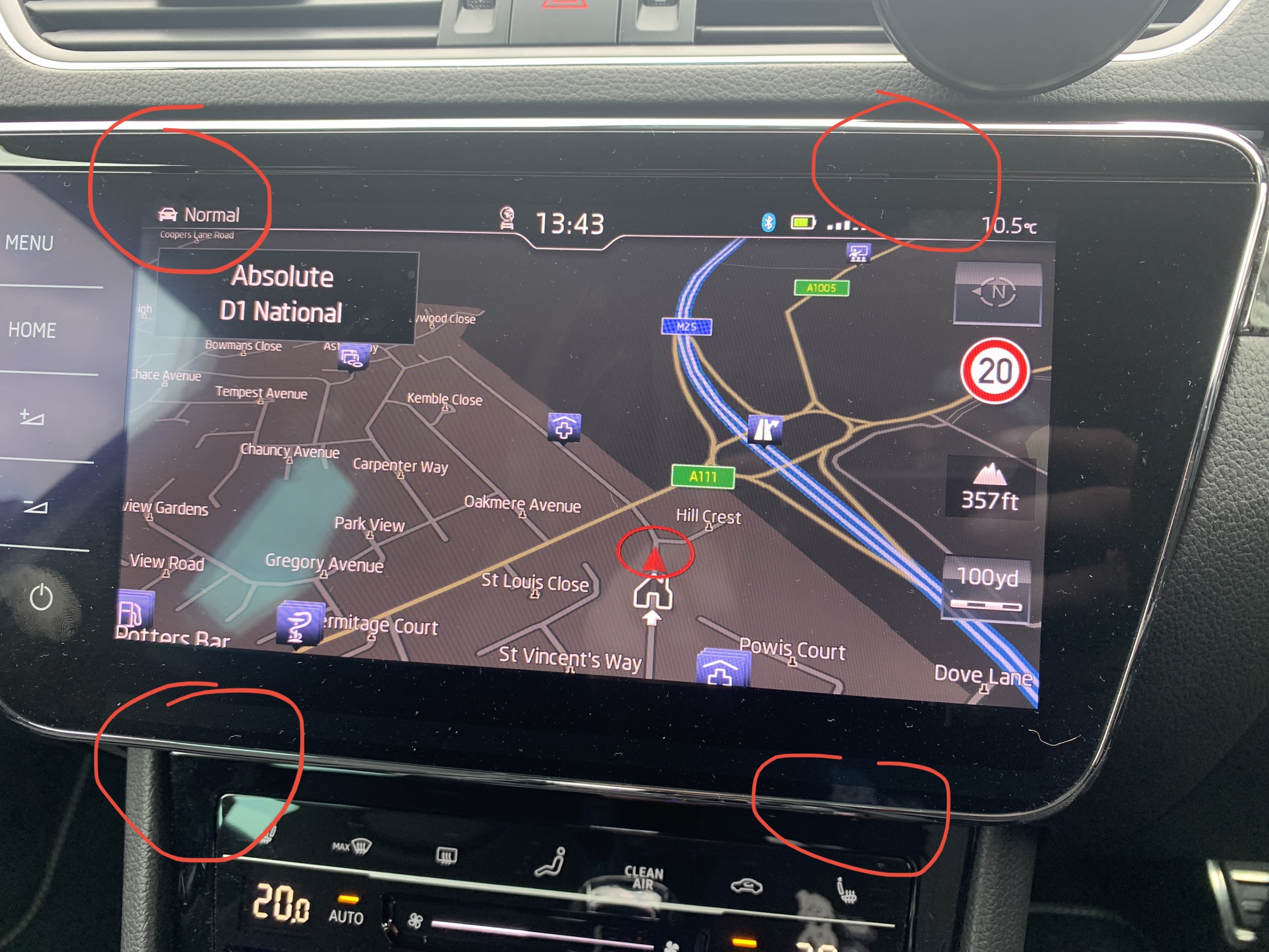

Well now you’ve described it in a bit more detail and made clear you haven’t removed the glovebox no wonder you can’t run any wires.
remove the 5F and then the glovebox with 6 torx screws and you’ll have loads of room to run the wires.
You keep asking the same question and have even said others have said the same as me to remove the display - yet we must all be completely wrong? I’ve described how to do it exactly, it won’t be any different for anyone else when there is only one way to remove it.
see the attached photo, there are 2 holes at the top requiring the keys to be inserted and there are 2 holes just below the gloss display that require the other 2 keys.

On 29/03/2023 at 06:31, ApertureS said:
I have told you exactly how to do it correctly which is based of me doing many of these and also Erwin (etka is for parts, not repair manuals).
your keys, have you got a photo of them?
there are 4 slots, please look harder, 2 near the top corners and 2 on the slanted bit of plastic below the screen.
I’ve already told you the screen has NO most connection at all, it uses a LVDS fakra connector for image display and is not on the MOST network at all.
The standard cockpit does not have a MOST connection either as it is not required.
I am more than experienced in this task as I do this professionally on a day to day basis so if you wanted to travel down to north London to get your work carried out by someone competent and reasonably priced please let me know.
otherwise the information I’ve given you above is accurate and covers everything you need to know
