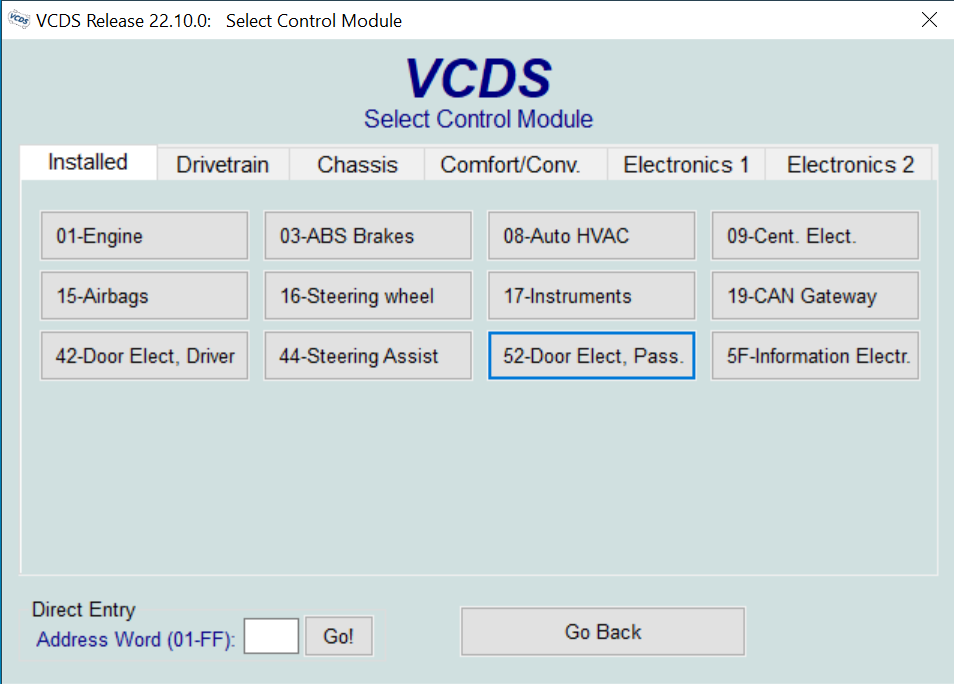

  5. Hi. I have got a Nov '13 Skoda Octavia Mk3 without electronic foldable mirrors. door modules were 5Q4 959 393 B and 5Q4 959 392 B. Interior mirror has auto-dimming (it has a button and a green light). Well. I changed both side mirror for ones with auto-dimming, entry light and foldable electronically. Also I changed bot door modules for 5Q4 959 593 E and 5Q4 959 592 E, and the mirrors knob. But now I have some faults. - When the car is moving the doors auto-lock desnt work. I deactivated that opcion on infotainment because car tried to lock the door one or two times per minute - If I lock doors using lock button in front of the gear lever the door are locked, but I can't unlock doors using that button. - auto-folding mirrors when car is parked and locked doesnt work. That opcion is on infortainment but I can activate it. I followed the SashaGrace instruccions and I can do that: 09] Central Electronics [16] Security Access - Code is 31347, click "Do it!" [10] Adaptation, choose from the drop down channel [24] - Access control 2 - Funk Spiegelanklappung Modus change to “by look command via remote control key” [26] - Access control 2 - Menuesteuerung Funkspiegelanklappen change to “active” But I didnt find those: [34] - Access control 2 - Profilfunktion fur Anklappung der Aussenspiegel [35] - Access control 2 - Signalisierung Spiegelanklappung Do you think I have to change 19 module (can gateway) for the one from the car that donated the mirrors? Maybe yes. Look at the faults: " [New feature! Extended UDS fault detail is only supported by current gen. interfaces]": Address 19: CAN Gateway Labels: 5Q0-907-530-V1.clb Control Module Part Number: 5Q0 907 530 L HW: 5Q0 907 530 E Component and/or Version: GW MQB Mid 124 1144 Software Coding: 030100040B087300EF000248080F00010001000000000000000000000000 Work Shop Code: WSC 73430 790 00125 ASAM Dataset: EV_GatewLear 009013 (SK37) ROD: EV_GatewLear_009.rod VCID: 3A716F2ABD5F905D8C-806E 3 Faults Found: 131658 - Door Control Module - Driver's Door U0199 00 [008] - No Communications [New feature! Extended UDS fault detail is only supported by current gen. interfaces] Intermittent - Confirmed - Tested Since Memory Clear Freeze Frame: Fault Status: 00000001 Fault Priority: 2 Fault Frequency: 1 Reset counter: 54 Mileage: 191960 km Date: 2023.03.08 Time: 19:31:52 Terminal 30 power supply: 12.3 V Terminal 15: OFF 15360512 - Component Protection U1101 00 [009] - Active Confirmed - Tested Since Memory Clear Freeze Frame: Fault Status: 00000001 Fault Priority: 4 Fault Frequency: 1 Reset counter: 247 Mileage: 191415 km Date: 2023.02.25 Time: 18:19:59 Terminal 30 power supply: 14.0 V Terminal 15: On 8526355 - Voltage Drop in Generator Leads too large P30DE 00 [008] - - Intermittent - Confirmed - Tested Since Memory Clear Freeze Frame: Fault Status: 00000001 Fault Priority: 5 Fault Frequency: 254 Reset counter: 67 Mileage: 191416 km Date: 2023.02.25 Time: 20:51:37 Terminal 30 power supply: 14.1 V Terminal 15: On Address 42: Door Elect, Driver Labels: 5QX-959-X93-42.clb Control Module Part Number: 5Q4 959 593 E HW: 5Q4 959 593 B Component and/or Version: TSG FS 011 0032 Software Coding: 00110120D000040000001100 Work Shop Code: WSC 73430 790 12345 ASAM Dataset: EV_DCUDriveSideEWMAXCONT 006001 (SK37) ROD: EV_DCUDriveSideEWMAXCONT.rod VCID: 479706DEFEADFDB503-8012 1 Fault Found: 65593 - Switch for Central Locking B122D 29 [009] - Signal Implausible Confirmed - Tested Since Memory Clear Freeze Frame: Fault Status: 00000001 Fault Priority: 3 Fault Frequency: 1 Reset counter: 14 Mileage: 191960 km Date: 2023.03.09 Time: 20:13:50 Address 52: Door Elect, Pass. Labels: 5QX-959-X92-52.clb Control Module Part Number: 5Q4 959 592 E HW: 5Q4 959 592 B Component and/or Version: TSG BFS 011 0032 Software Coding: 00110120DC00040000001100 Work Shop Code: WSC 73430 790 12345 ASAM Dataset: EV_DCUPasseSideEWMAXCONT 006001 (SK37) ROD: EV_DCUPasseSideEWMAXCONT.rod VCID: 46890BDAF9A7E4BDF8-8012 1 Fault Found: 65593 - Switch for Central Locking B122D 29 [009] - Signal Implausible Confirmed - Tested Since Memory Clear Freeze Frame: Fault Status: 00000001 Fault Priority: 3 Fault Frequency: 1 Reset counter: 14 Mileage: 191960 km Date: 2023.03.09 Time: 20:13:50 I wair for your response. Regards.
  6. Hi. I need your help. I bought foldable mirrors, mirror knob and dorrs modules. I installed today and I can fold them using the knob, but they dont fold automatically when I lock the car. Well I tried to coding using VCDS but the opcions on my VCDS are not the same that in your post. I did that: But I did find that: I see the opcion on infotainment but I can activate. The mirror lights work radomly and i didnt see those options on modules 42 a 52. My car havent door lights

  14. Yes, I was following those intructions, but my no-memory mirror can not do that I did it with Vagcom, but didn't work because my mirror is a no-memory one. Now I can say with absolutely certain that my doors modules are not compatibles. I dessambled one door, and I check module pin conections and wires harnesses. Module pin conection to mirror only have six pins and wire harness from module to mirror six wires (obviously). Well, seeing that I need to change both modules and both wire harness from modules to mirrors. But now I have a big doubt: mirror knob must to be change because the actual one has no power foldable option, but ... how many wires has the mirror knob that I need?. Actual has four wires, if the one needed has more than four I need to change all door wire harness. Can anyone solve me this doubt please?

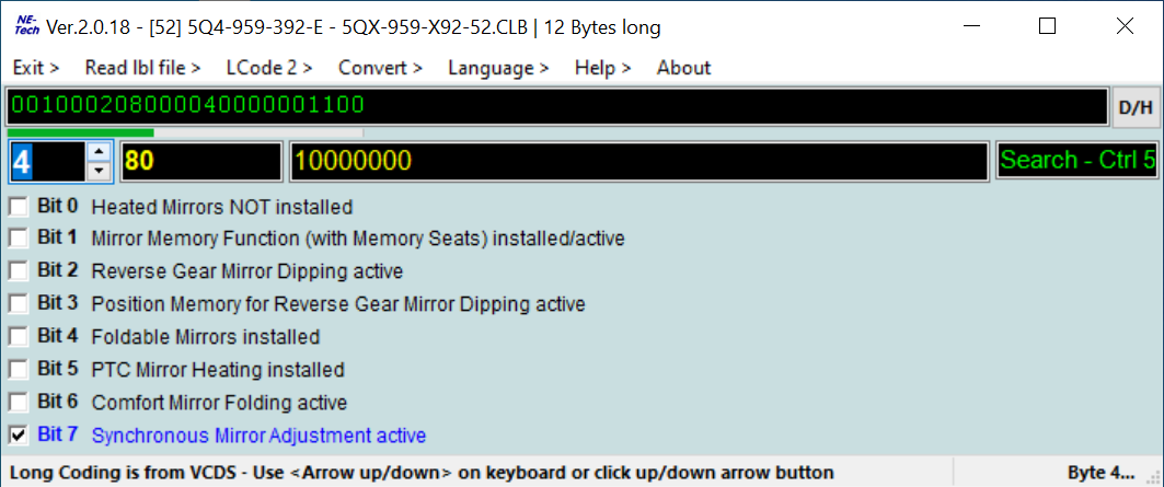

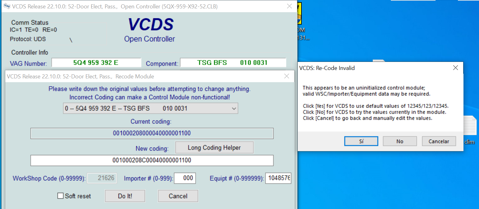

  19. Hi guys I was trying to enable passenger mirror dip on selecting reverse but I received an error and I didnt knew how to continue. My Octavia III is from November'13 and maybe it isn't compatible with this mod. Well, car's module 52 is for passeger's door like the tutorial tells Really bits 2 and 3 in byte 4 are correct and if you read the descripcion them are for dipping mirror I activate both but when I exited for write the chages I received and error and I didnt know if was secure for the car Continue. Can you help me with that? Maybe I should to select "NO" and continue, but I was afraid of decoding the control unit and causing a breakdown I could activate fog lights as cornering lights, activate fuel refill on maxidot and activate goth rear fog lights using the tutorial on this forum. Thanks in advance
