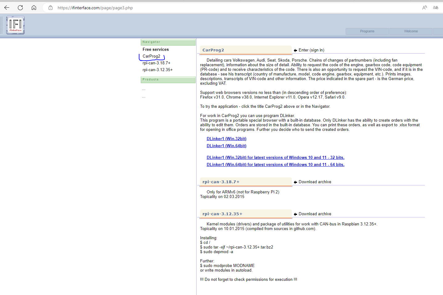

  5. i like the VBF but it also has its limits as u mentioned- for me the problem are hooks for the bags- now the boot is not deep enough so those hooks are basically useless. heres is the website for ETKA IFI :: Free services (ifinterface.com)

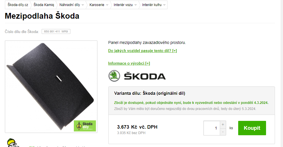

  9. i think i have found the culprit :DD all the components except for the VBF itself i ordered at the skoda dealer-i had numbers from briskoda, they confirmed it and that was it i had the 658861411WR9 from kamiq post and after a loft of search i found one (from "scrap car"). the thing is when i found the website that was selling those spare parts from scrap cars i was no longer searching it by the number but simply by the name "skoda scala" so i did not check whether the numbers are matching. I have checked the invoice now and can confirm that i also bought the 657861411WR9. your measurements explain it all since the kamiq boot is shorter and has less capacity-which was one of the reasons why i went for the scala. ...so i can confirm: 657861411WR9 skoda scala 658861411WR9 skoda kamiq

  11. Boot floor: 658861411WR9 left side: 6578645119B9 right side: 6578645129B9 bolt: N10751101
  12. They have the parts u need. Example below
