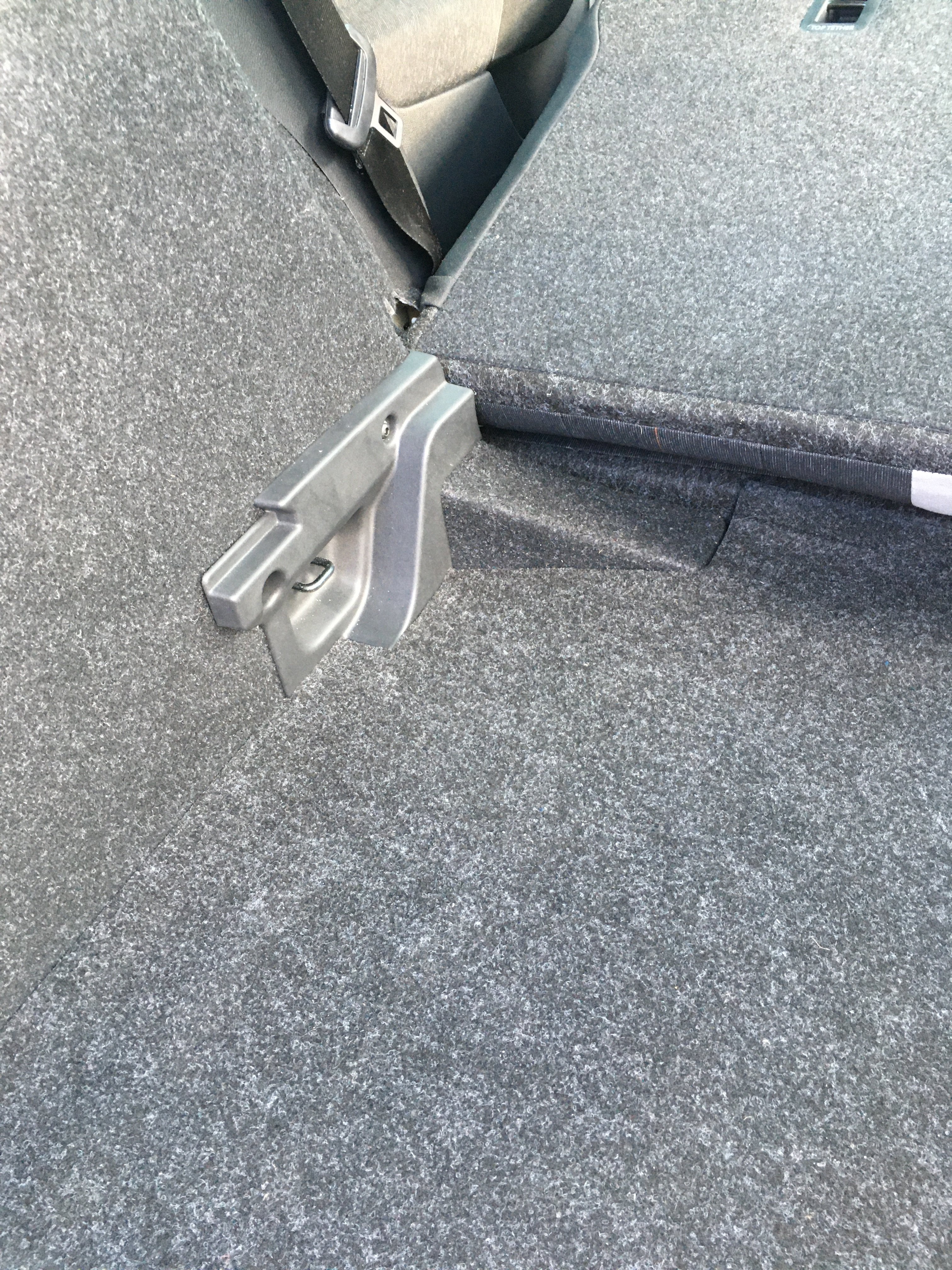

I have seen a number of posts from people wanting to fit of a variable boot floor after the car has been purchased. Dealers will not do this work. I have seen the difficulty people have had getting the parts. I have just fitted one to my Scala with no problems after the initial problem of getting the wrong boot floor.
The parts required are: left and right trims to attach to bodywork Parts S6578 645 129 B9 (right) AND S6578 645 119 B9 (left). boot floor S657 861 411 WR9 (not the often quoted S658 861 411 WR9 which is for a Kamiq). I did not bother with the replacement side panels nor the new restraint lugs as I don't tend to use these and existing lower ones are retained anyway.
I had to order the bolts separately as Skoda did not supply these. They are standard M6x20mm black bolts with Alum key heads. I needed to add washers.
I cut through the lining and found the bolt holes for the bolts were already there for three out of the four bolts needed. The rear one on the near side was missing for some reason. So I no-nailed some wood to the panel and bolted into this. I cut the holes in the trim wide enough for the supports (25mm will do the job). I cut out the boot side liners round the restraint lugs so the side trim fits right to the metal on the sides. I then cut the existing floor mat  so that it fitted round the new corner trims and can be lifted to gain access to the spare wheel. Bingo, all done and works a treat just like a factory fit.
I attach a couple of photos. I have others if people are interested. Cheers

I did not take the side trims off. I had a look and decided it was far too much effort and I might not get all the trim back as well as it fitted from new. So I drilled a pilot hole (about 1/8in) and checked that there was a bolt hole beneath then I used a 3/4in wood bit to cut out the carpet around the pilot hole to gain access to the bolt hole. You need to do this as the corner trim fittings sit through the carpet. I found that there were three out of the 4 bolt holes ready and waiting. The left/rear bracket and associated bolt hole was not there!! So I simply "no nailed" some wood, the right thickness and larger than the hole, against the chassis and bolted through onto this. If had to cut the carpet out around the luggage restraint clip so that the trim fitted against the chassis (this gave me the access for the piece of wood mentioned above). I then had to cut the boot floor carpet slightly to fit over the corner trims.
I would think carefully about the variable floor itself if you wanted to lower it and have it at the lower position as it has to have some sections that "hinge" to allow for this. There is the front section that hinges and slides up on the corner trims and then there are small sections at the rear that allow you to tilt the floor upwards. They have to flex to go past the shopping bag carrying hooks. They are then cleverly designed to wedge into the notches on the side trim, that normally hold up the rear parcel shelf, and support the floor while you put anything underneath. The floor is made from a lightweight composite material to make the handling easier for you but support reasonable loads.

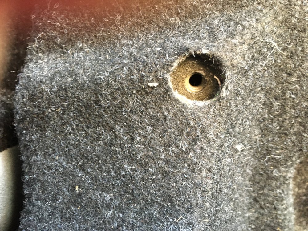

First of all-i have come across the same problem as dave75. in fact i had 4 holes drilled but the one was without a thread (left side) so i could not mount a bolt there so i kept it empty for now.
if i recall correctly-originally there is "extra metal plate" welded to the cars body with the hole and thread for the bolt. my idea was to drill two holes (instead of welding) and attach the home made metal plate with screw rivets. i have to say that the no-nail (glue) solution is definitely a better one so thanks for the tip.

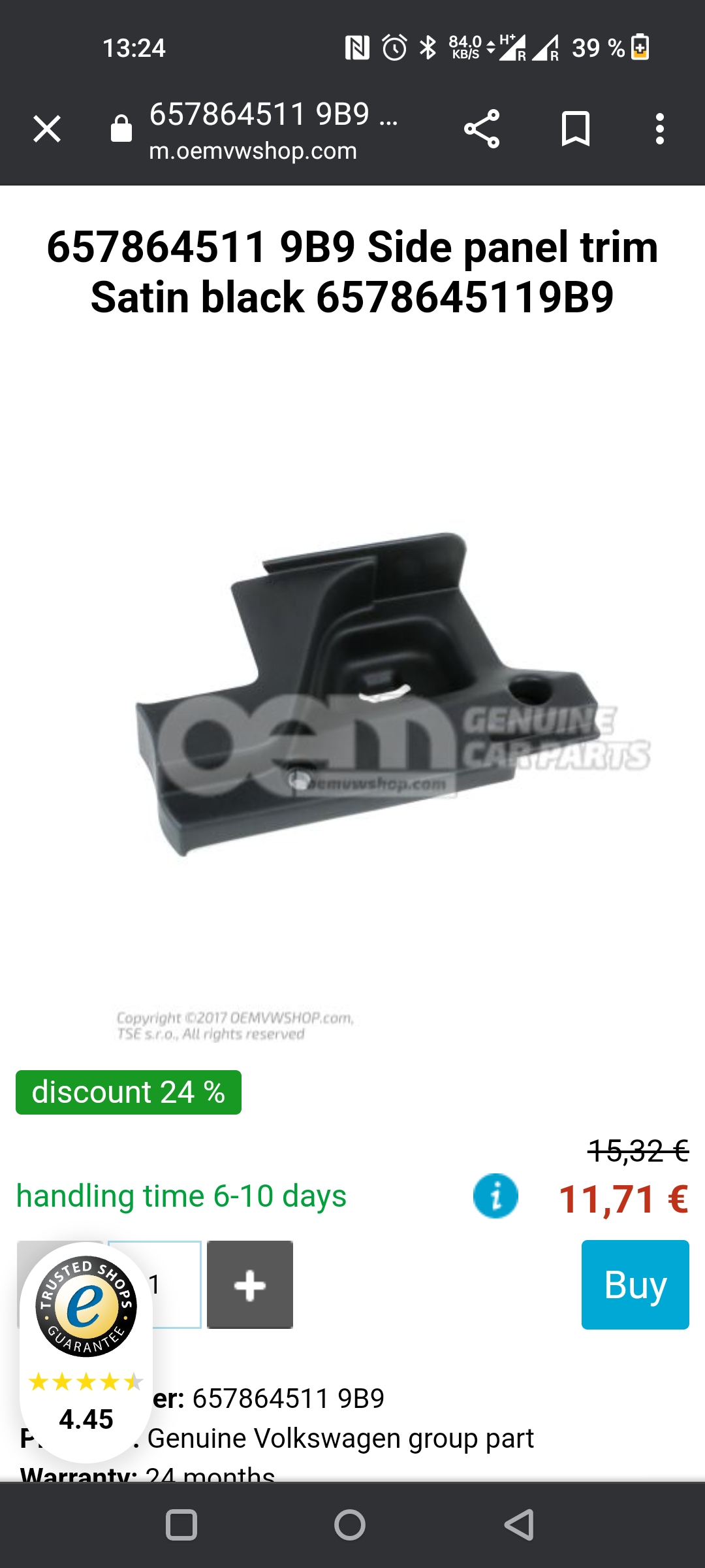

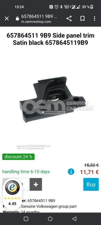

i can also recommend the website: https://www.oemvwshop.com/ if i am not mistaken they are based in CZ but they do deliver to the whole word so u can order everything there.

I have been to both the web sites recommended, with no luck.
Both sites turn up nothing when searching by part number.

They have the parts u need. Example below
Boot floor: 658861411WR9
left side: 6578645119B9
right side: 6578645129B9
bolt: N10751101

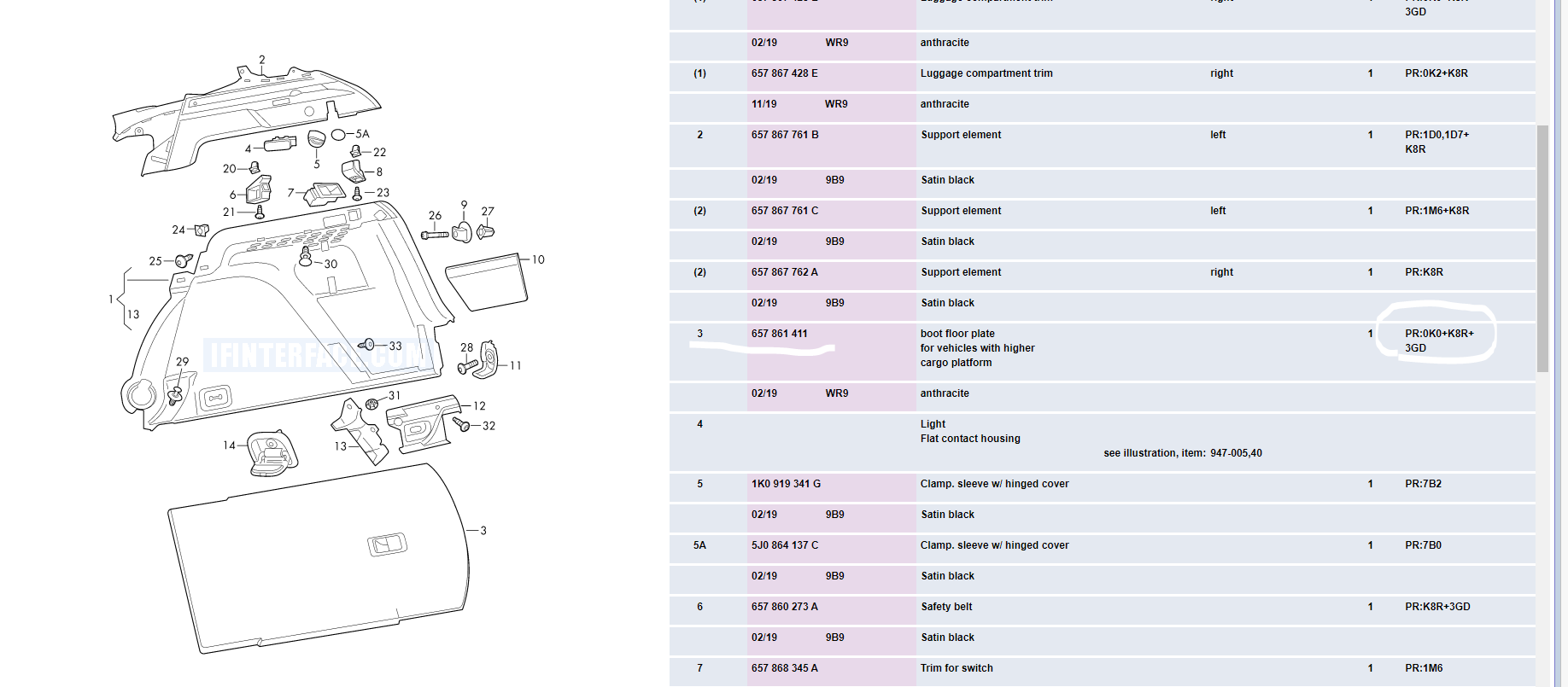

i have to say i am surprised there are two types of variable boot floors. AFAIK i got mine based on the info from the kamiq thread and its fits perfectly even though my car is not kamiq but scala. i checked the number you provided and sure it exists.
there is no "shape" difference of floor itself but those pictures are not precise...but there are small differences when it comes to other parts related to VBF. maybe it depends on model year or engine? dunno. mine is 2022.

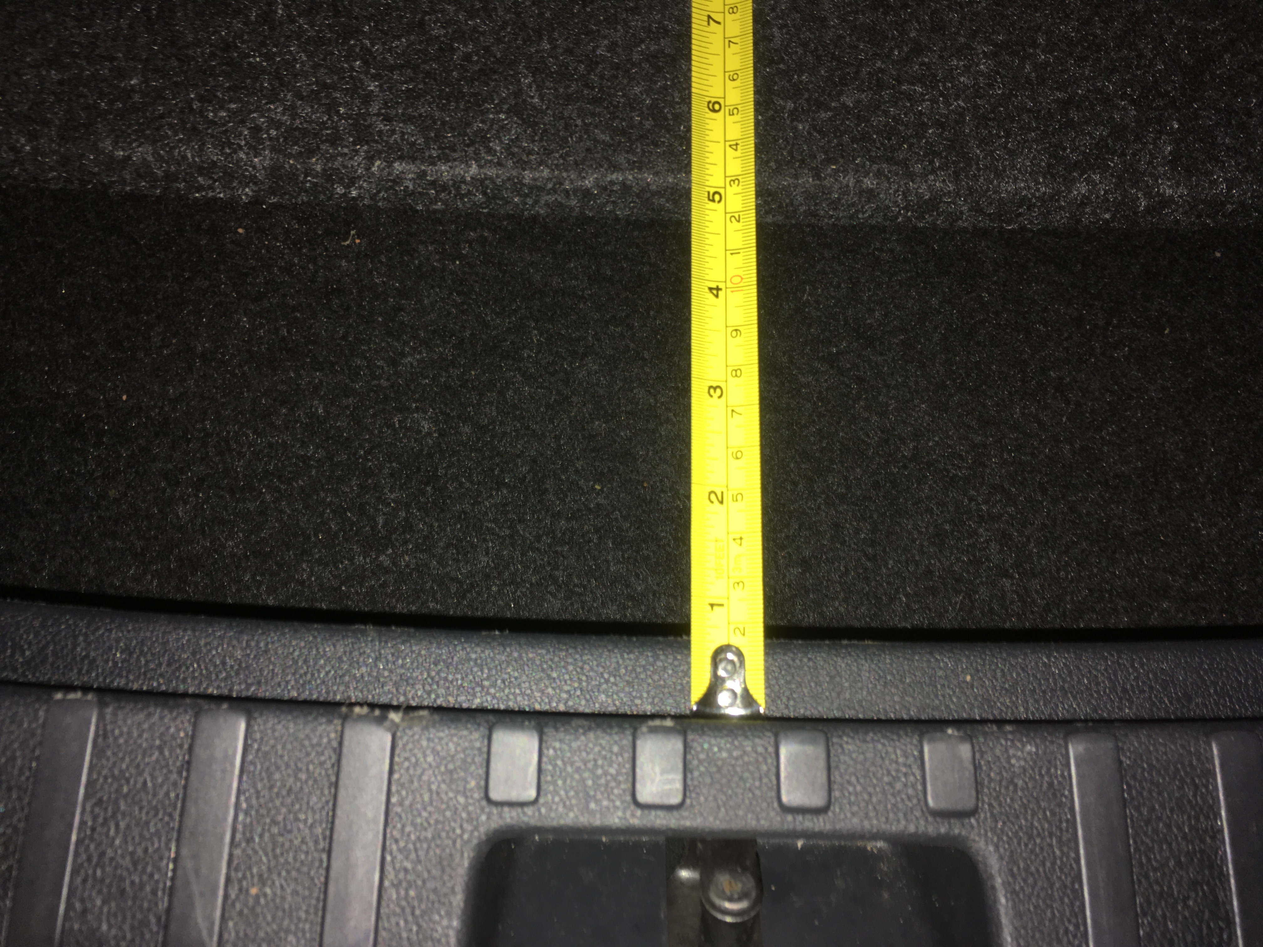

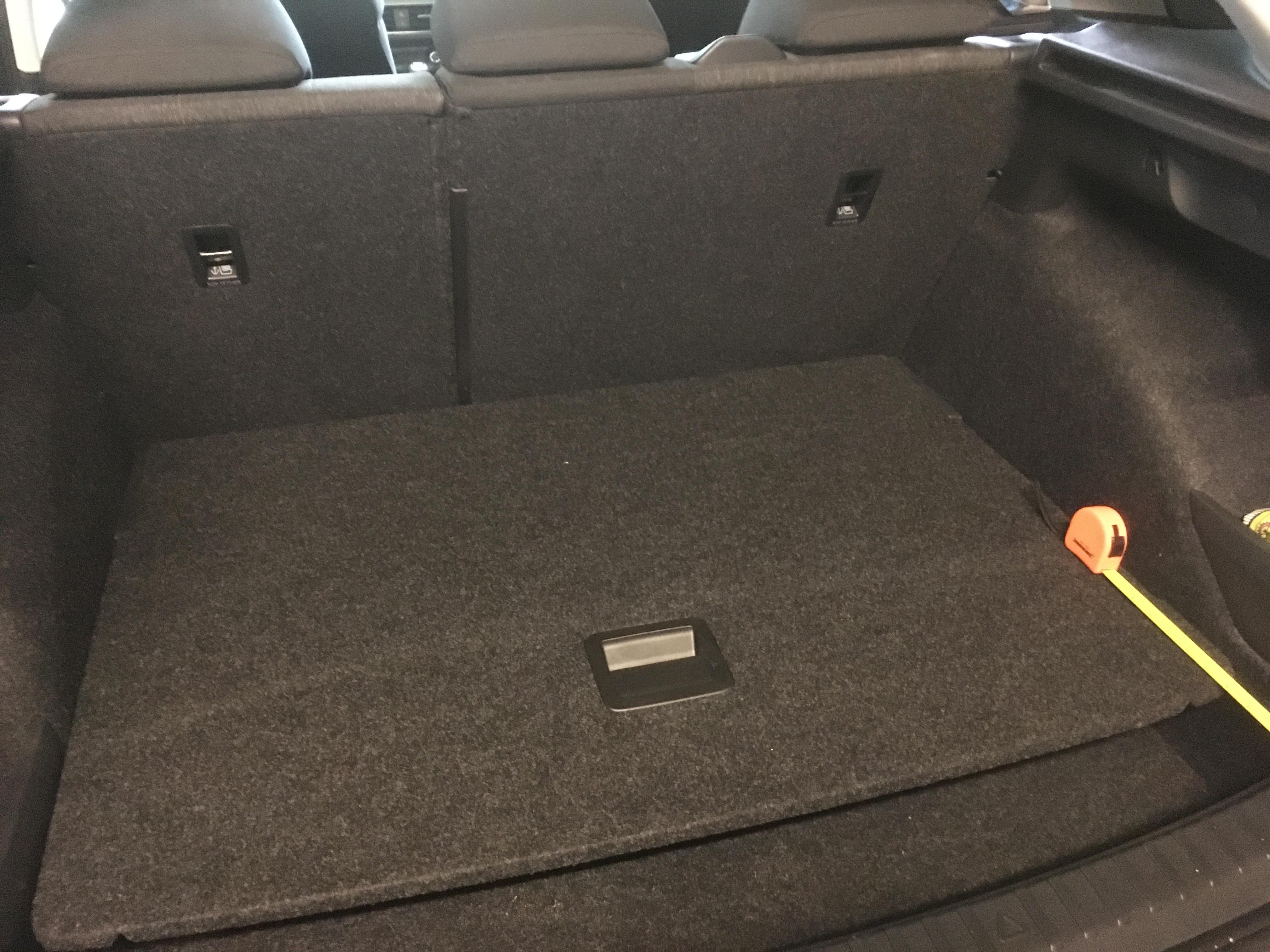

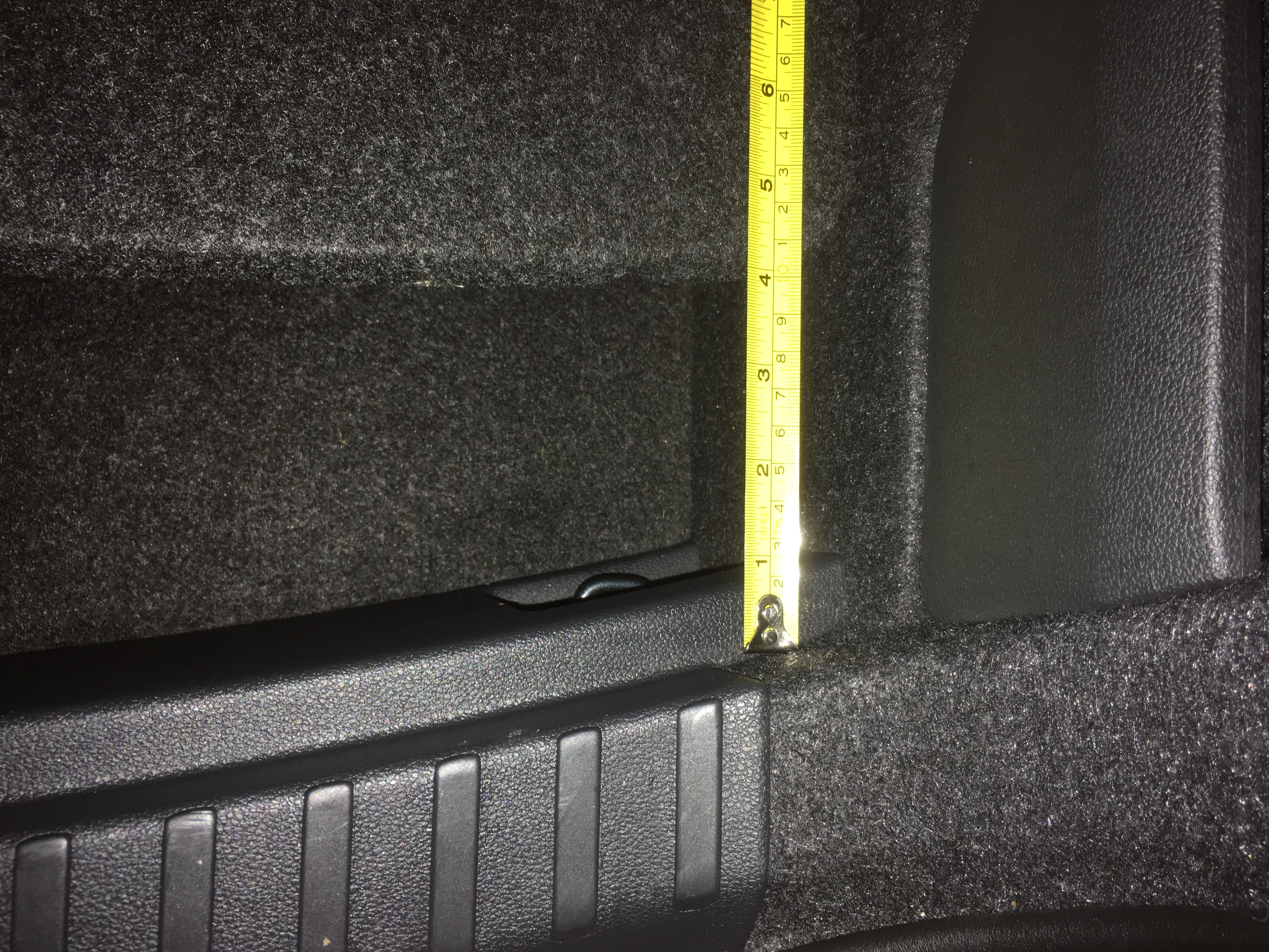

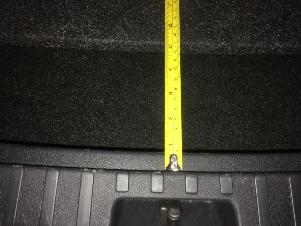

I definitely had size and shape difference when they sent me Part No: 658861411WR9.
These are the photos when I dropped this boot floor into my car, showing it was about 100mm short at each side and about 125mm short in the middle so length and curvature were wrong!!
When they supplied Part No: 657861411WR9 all was well.
Dave

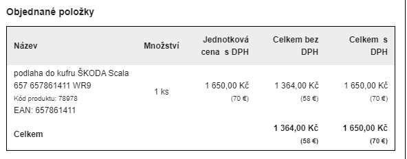

i think i have found the culprit :DD
all the components except for the VBF itself i ordered at the skoda dealer-i had numbers from briskoda, they confirmed it and that was it
i had the 658861411WR9 from kamiq post and after a loft of search i found one (from "scrap car"). the thing is when i found the website that was selling those spare parts from scrap cars i was no longer searching it by the number but simply by the name "skoda scala" so i did not check whether the numbers are matching.
I have checked the invoice now and can confirm that i also bought the 657861411WR9. your measurements explain it all since the kamiq boot is shorter and has less capacity-which was one of the reasons why i went for the scala.
...so i can confirm:
657861411WR9 skoda scala
658861411WR9 skoda kamiq

I can also confirm that the left side rear tapped hole is not on my vehicle either.

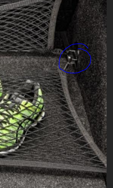

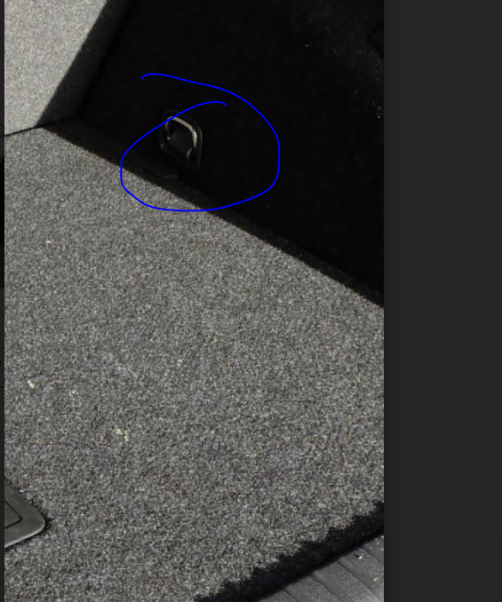

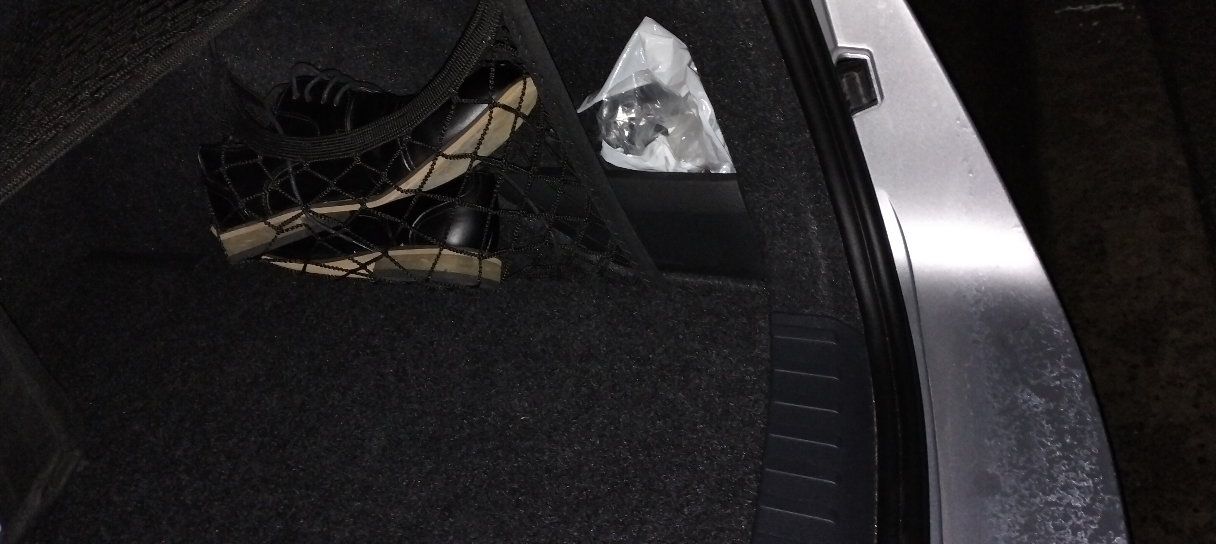

The issue I have is with the cargo nets. My car came with them, (and I think they're great) but I can't figure out how they attach now that the VBF is installed. Looks like it is either the VBF or the nets. Not very clever.
Any thoughts?
Dave

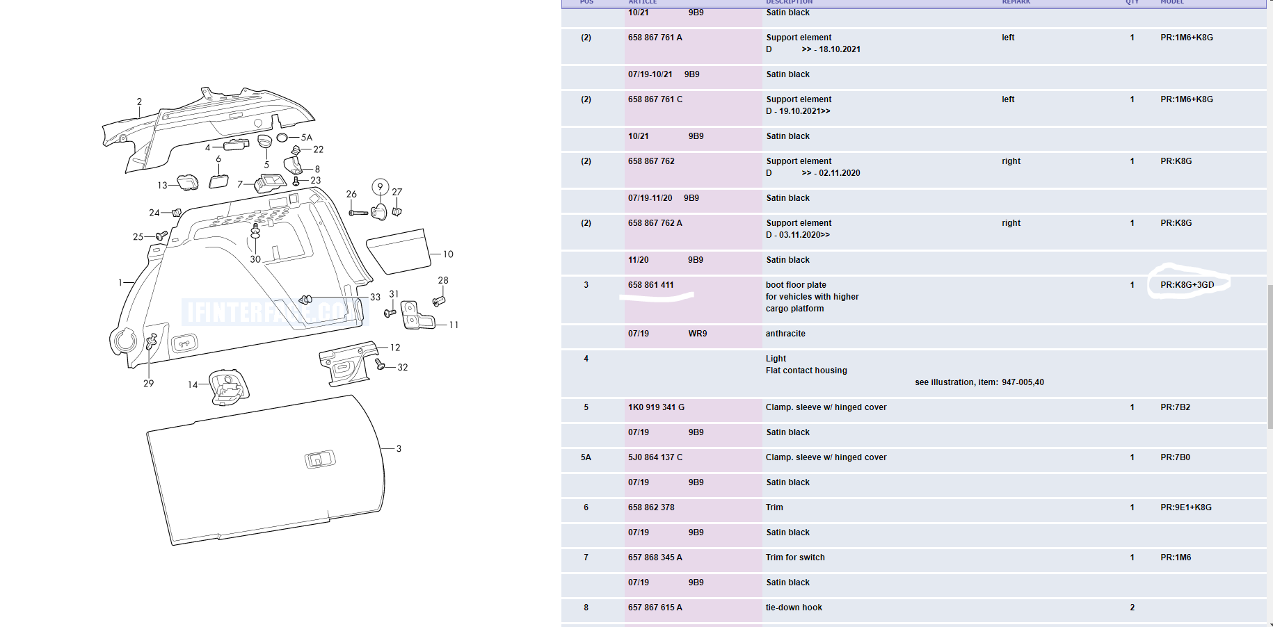

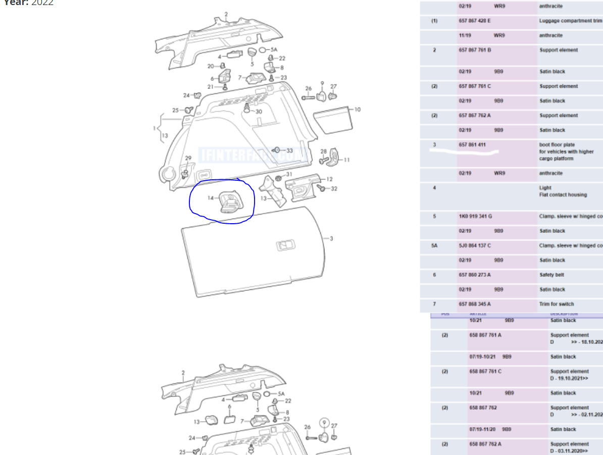

u should have ordered hooks as well (num.14 from etka-my reply above). hard to say whether its possible to mount them since there can be missing holes as well so u either have to remove the whole panel or u could try to pierce the carpet with a pin lets say to see whether there is a hole-if yes, you would cut a hole in carpet and assemble the hooks-i have ordered them just in case but never installed.

nope. i intend to keep them just in case. they were pretty cheap if i recall correctly-problem for u could be that u are from NZ...since i am from slovakia it was very easy to order it-i had it like in couple of days no shipping cost since it was ordered from skoda Czech.

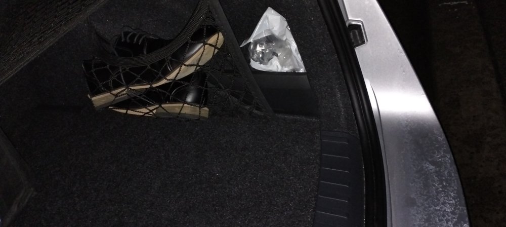

I also have a net which attaches to the side (not behind the rear seats as the large one does). It also has had its capacity reduced because of the VBF.  There does not appear to be a position where a hook could mount above the VBF as there is a plastic cover in the way.  See photo.
At the moment the rear of the net is attached to a hook which is now below the VBF.
I can order them no problem. I got the VBF and brackets from Czech. Where did you get the parts diagram from?
