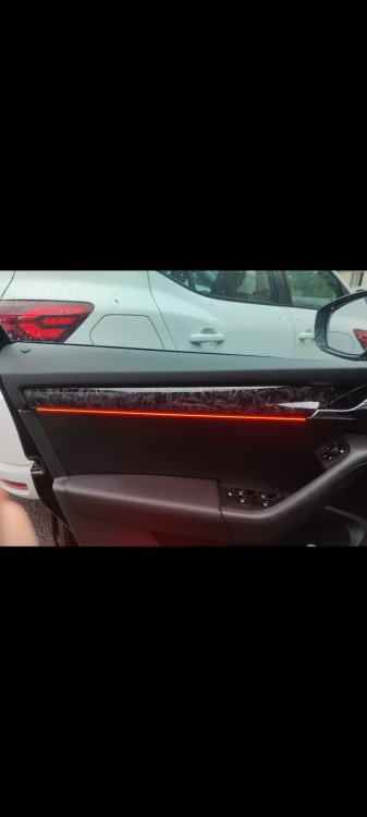

  1. My curent panel is a bit scuffed and was considering an upgrade if im going to change them. All 4 doors are sound insulated, metal and plastic panel, trims are covered with forged carbon foil and added aftermarket ambient light (don't really like how i fitted them).

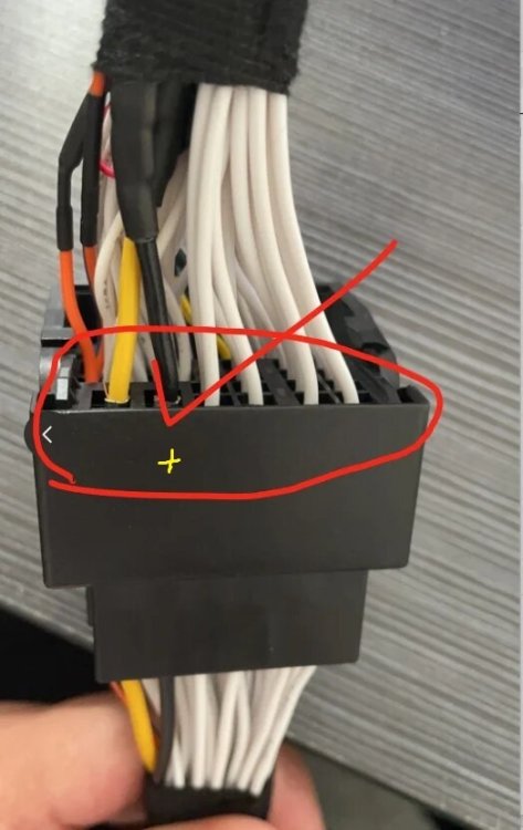

  9. Hello, After 2 years of no issue, my reverse camera from China started to act up in the morning, the image is black and whine and flickering. Most likely due to fluctuation in the voltage from the car, because later in the day, it works just fine. A solution is to install a 12v power filter on the + and - but i have no idea exactly where these wires are. The camera is plug and play, no wire cutting so the power comes straight out of the MIB 2 box, I got a picture of where the + wire is from the Chinese guy, will attach a picture but would like some one that knows the wiring loom to confirm this is + and where the - might be.
