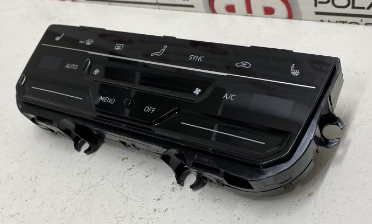

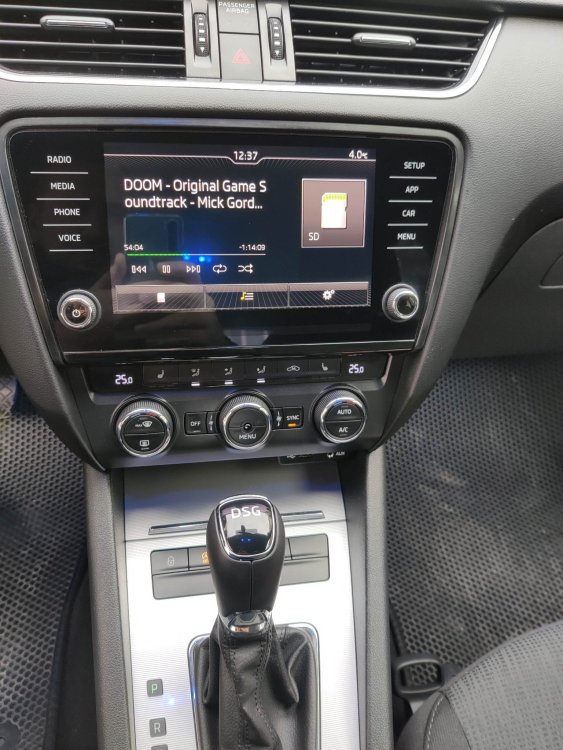

I own a Octavia 3 from 2015 and i saw that you can replace the climatronic panel to one with touch buttons. Has anyone done this and can help me check if my model can benefit form it. And if so, what touch panel codes might fit and what frame is compatible and a location to buy it, even if it's AliExpress.
Bellow is my current setup and a picture of what i am aiming for.

Thank you for the feedback so far, I know now what panel unit number i need: 5NA907044AJ (without Webasto)  from a Tiguan2 / Kodiaq / Passat B8 H. Just need to find a suitable frame, one of the Russian posts used a Superb frame but the bottom corners were sticking a bit out.

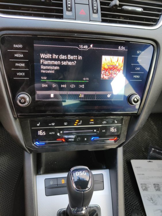

And I've done it, the frame i bought it from Romania, it was 3D printed and did not need to paint it and it fits perfectly.
I just need to sort out some error codes:
-start the AC compressor.
-ignore climate zones 3+4, as it is coded for Arteon or Passat that have separate heating in the back area.
