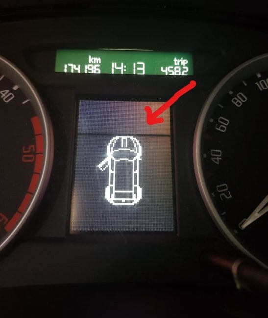

  19. Hi, For a long time my headlight have glitched.. When the headlight switch is set to "0" half light has been on. This is quite normal on swedish cars.. (on other brands as Saab or Volvo this is normal) . During service at VAG servicepoints they have told me this is normal.. However.. when i have checked other Skoda Fabias the light has been off at "0".. It has been like this until last week.. when the half light glitches off that often that i now need to put the light ON to be able to have a stable headlight.. Last week i have also faced problem with the passenger door indicator... It also glitches.. and mostly the car think the door is open even if its closed.. that means that the indicator at the instrument panel will show the door open and the interior light are on.. as it glitches.. the interior light will go on again after timeout. Wich will lead to a drained battery 😞 At the same time, i can readout errorcodes about the lambdasonds.. Telling me that signal grom the heaterelement are weak.. P0031, p0037, p0141 are my errorcodes.. There has also appeared a pixel error row at the instrument display that has not been there before. I have done some reasearch.. looked att youtube videos etc.. I have checked the cables in the door. I have checked the switch in the lock unit. (I have unassemblied lock module and tested the switch.. No problem there) I have tested both lambdasonds by heating them up and checked that it creates 1volt.. also that there are resistanse at the heatercircuit.. There are no other faulcodes detected from my Delphi dongle. I am suspicious about that all these fauls come at the same time.. also.is it normal that both lambdasonds break at same time? I have now read in this forum about earth issue in the window motor.. i will check that.. Does anybody here have other tips what the fault might be? Could it be something in the Voltage unit located behind fuse panel? To where are the lambdasonds connected? Thank you in advance
