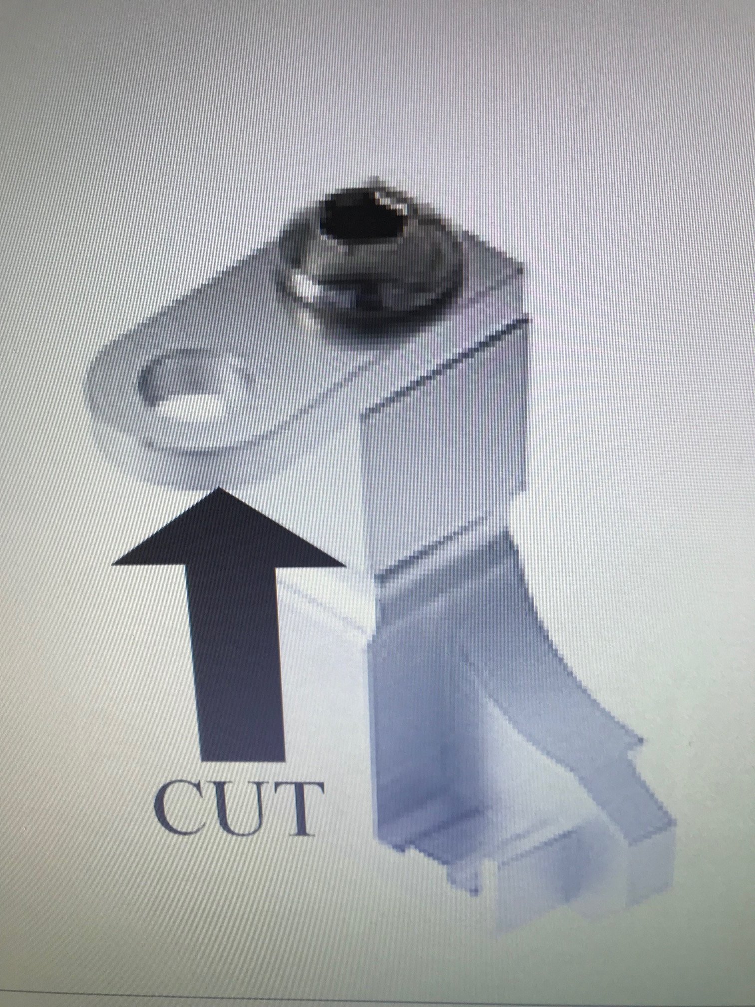

No the bolt won't come fully out.
This is the way I did it...
I cut the small bracket that the bolt needs to go through just enough so the bracket will slide over thread with the bolt loosened.
I also put locktight on the thread for piece of mind.
Obviously the correct way would be to take the manifold off but I didn't want to mess with the fuel lines.
Mines been on there over 30,000 miles now with no problems.
I'm no way suggesting this way is better, it's just a shortcut I decided to take.
Shame we didn't have the aluminium manifold where they bolt on within minutes hey!!!
Hey just an update did the job today thanks for the input guys all went pretty smoothly thanks to the workshop manual from sealover and although I was actually going to dremmel the fixing plate, as you did Kris,  I ended up taking the full manifold off and attaching the bracket instead which really wasn’t as much of a bad head as first anticipated, around 2.5 hrs and EML self righted after starting up. Job well done 👍
