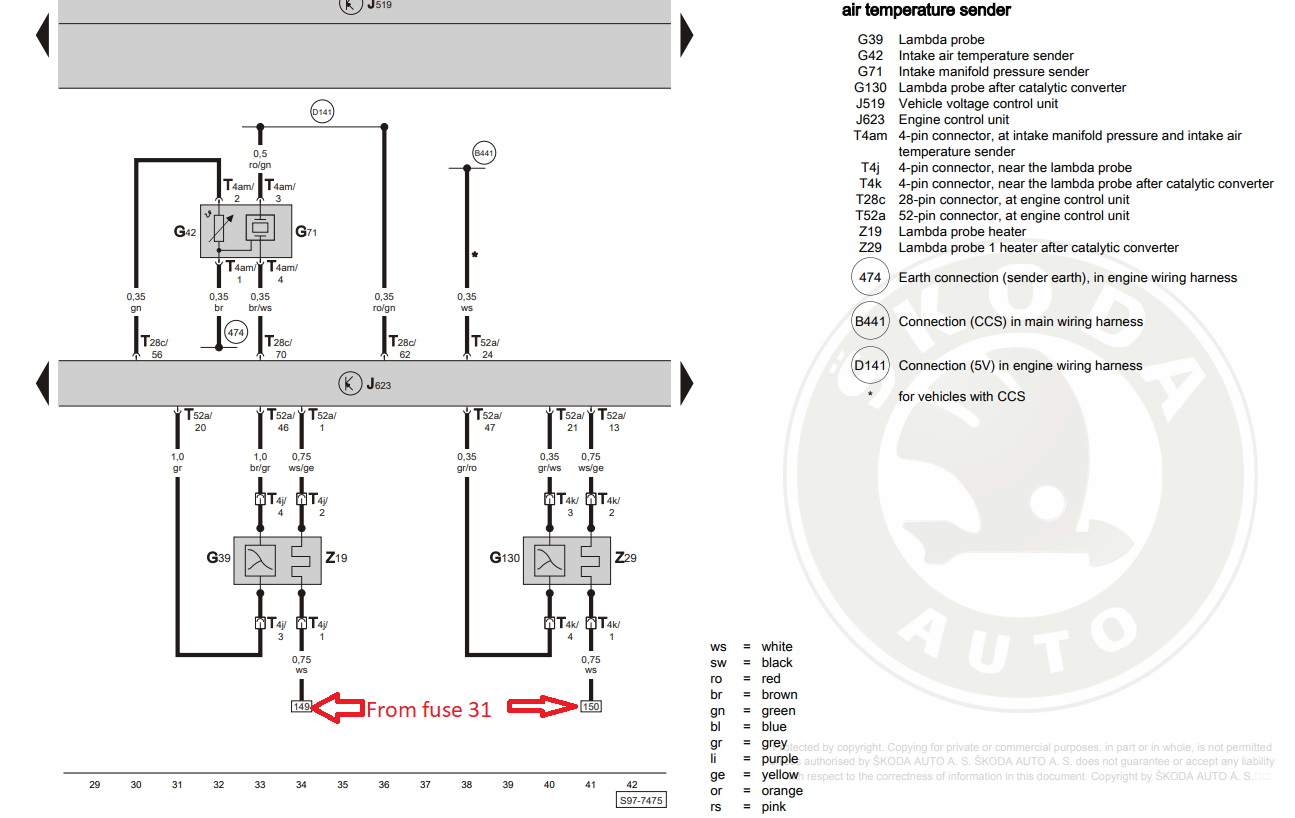

I will post a circuit diagram of the lambda wiring for you tomorrow.
Great!.. thanx for your support!

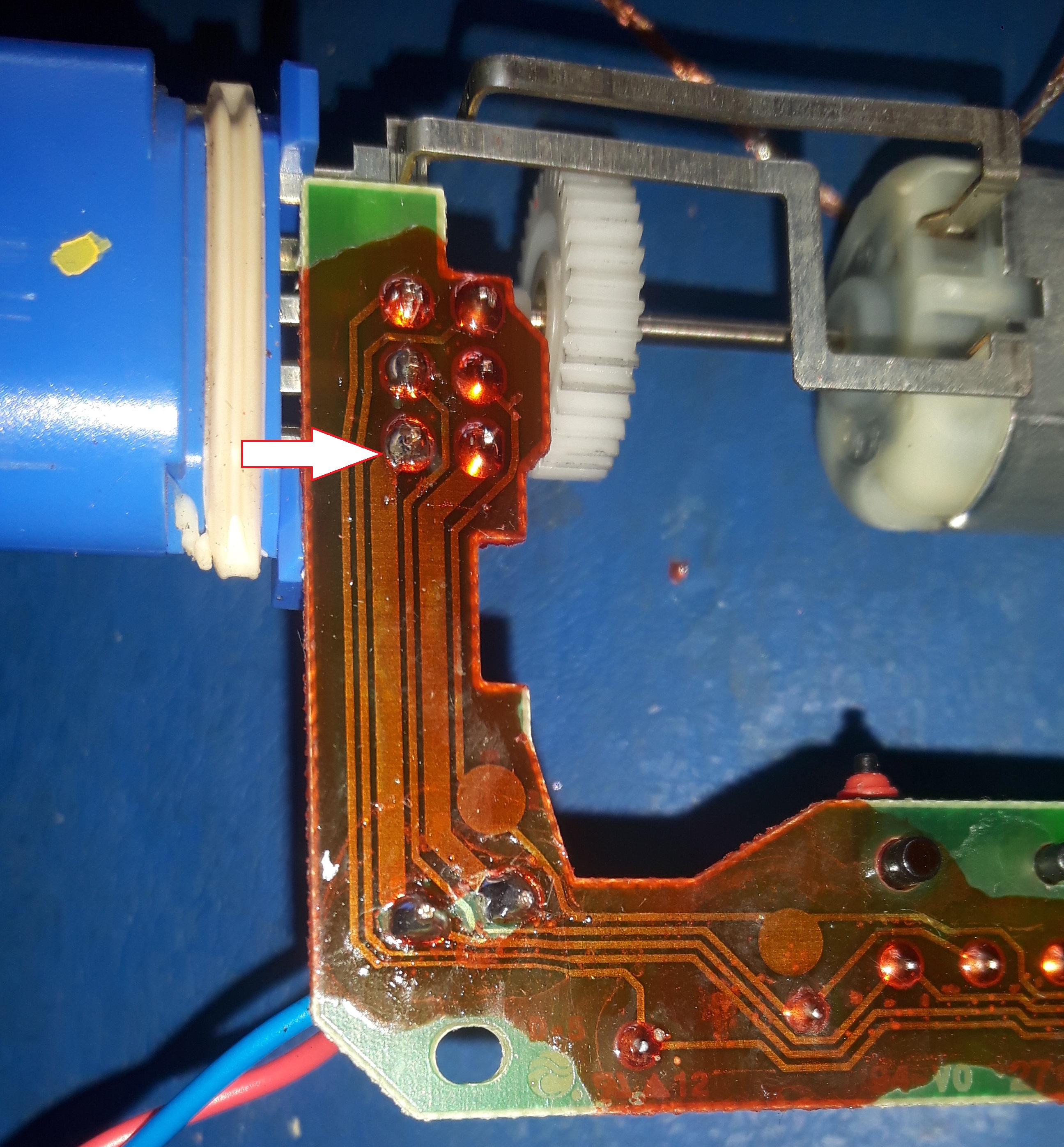

I have seen youtube videos, and also read about the small mini-switch in the lock unit, so i unmounted the switch, cleaned it.. did a simple measurement and it seem work.
I have run VCDS check, and i do not have any errorcodes more than lambdasond and AC compressor shortcircuit to + pole.
The door indicator glich intermitent, so the car think the door opens and close a lot of time..
When driving for a while, alarm sounds as the car think door is open while driving..
If you close the door.. everything seem to be fine.. but maybe after a minute... or longer.. the car think the door is open again.. for a short while..
Noone even touch the car.. when it happens 🙂
  • Sponsor
The door lock fault can be the solder joints where the connector attaches to the circuit board in the lock also, as well as the microswitch.

Have checked the doorlock now. Opend it and checked all solderings. All looks fine.
Door still glitching.. uhh..

When i read the wirediagram, (thanx for that @Breezy_Pete) it really make sense that there should be a fuse at position 31, otherwise pre-heating will not be possible. The car is equiped with 4 wire type lambdasond.. so why should it not be in use?..
