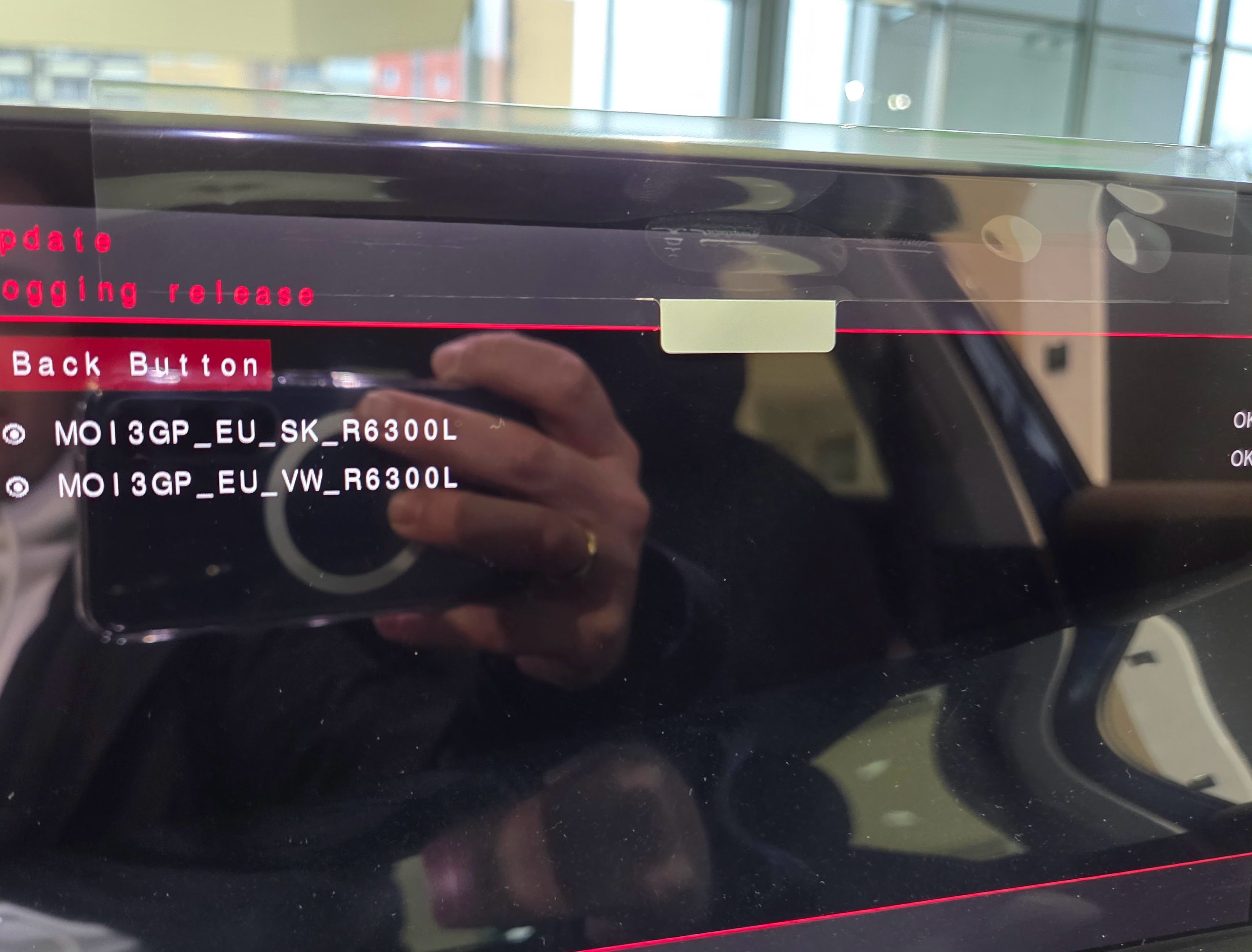

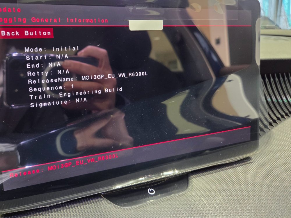

  5. Hi Got 2024 Superb, which I was trying to connect to my SkodaID. Unfortunately globe on top right part of the screen remains grey. I know that it has been 10+ times at the dealer with various problems including dashboard lights, errors etc. Since I'm unable to check OTA updates (privacy settings are not loading at all- stuck at loading screen) I've checked software version in the eng menu which is described as MOI3PG_EU_VW_R4500L. Decided to compare this with display car at dealer which has two software versions installed- branded as SK and VW (different than mine, also newer version) Is there any option to perform offline update and add missing SK firmware or the only possibility will be to book an appointment at dealer? Attached pictures for reference from both cars (screen covered in plastic is a display car at dealer) 20260202_151930.heic 20260202_150357.heic

  8. Thank you! As far as I know unit wasn't hacked. Only Skoda Dealer was connecting into the car in the past. Was bought brand new, AA and Car Play were included as one of the options. Should I expect 1555 / B201A DTC after upgrade? If yes, which interface will be better (for like one-time use, would like to avoid subscriptions for the whole year). I'm thinking about OBD eleven or carista. Currently I have only old K+CAN and KKL usb cables which re working only with very old VCDS versions
  9. Cannot edit my previous post, adding photo of next screen
