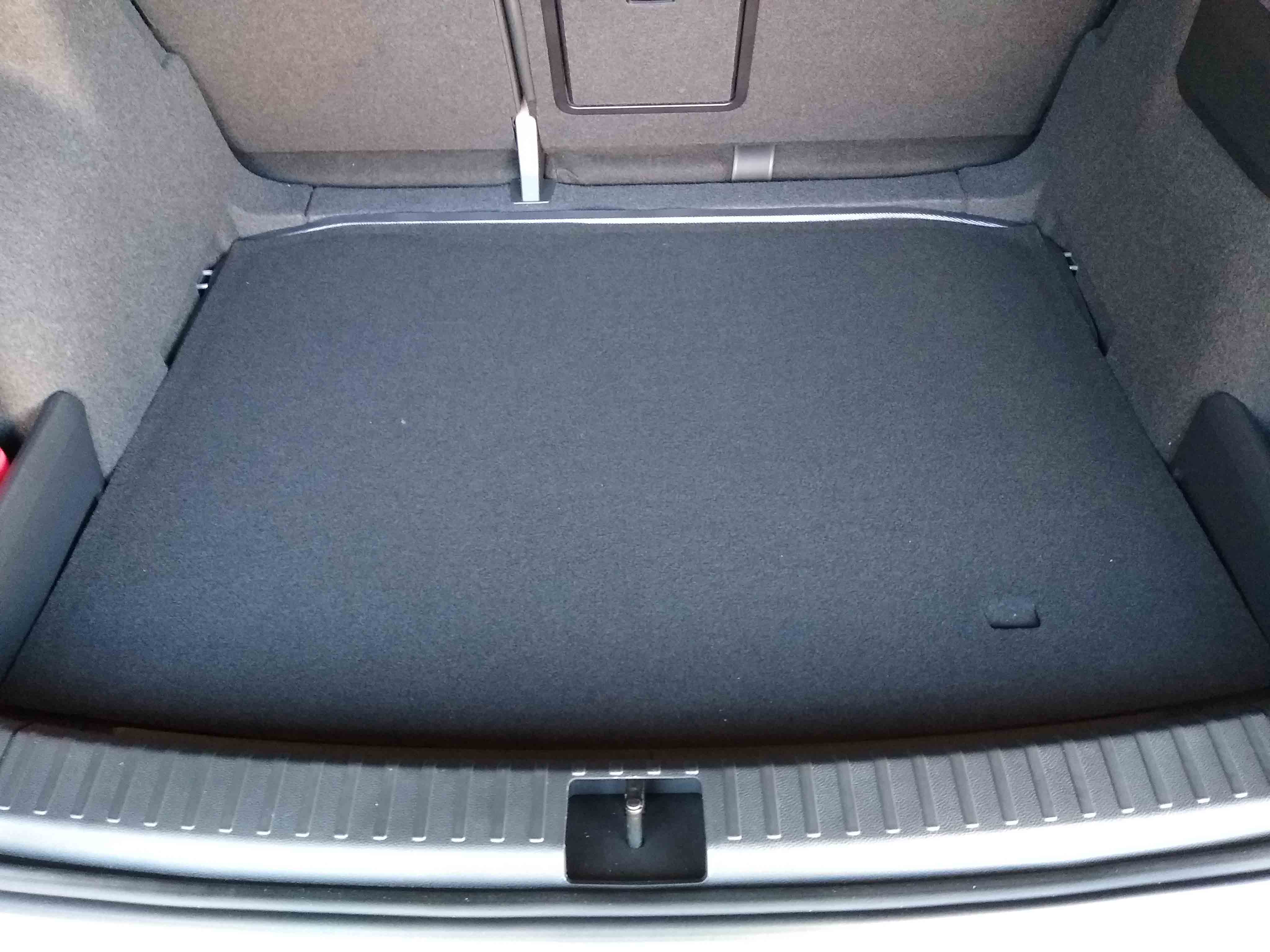

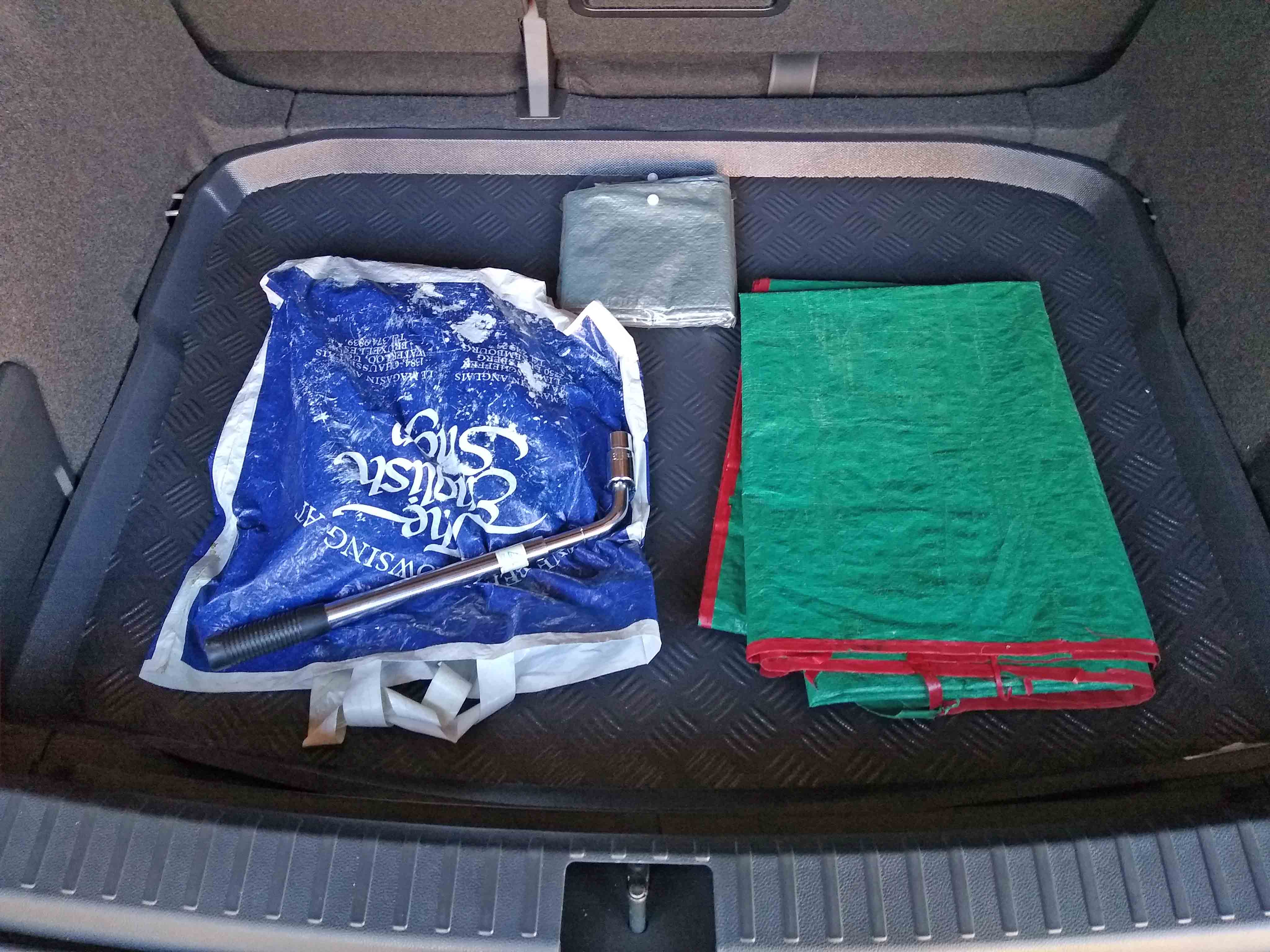

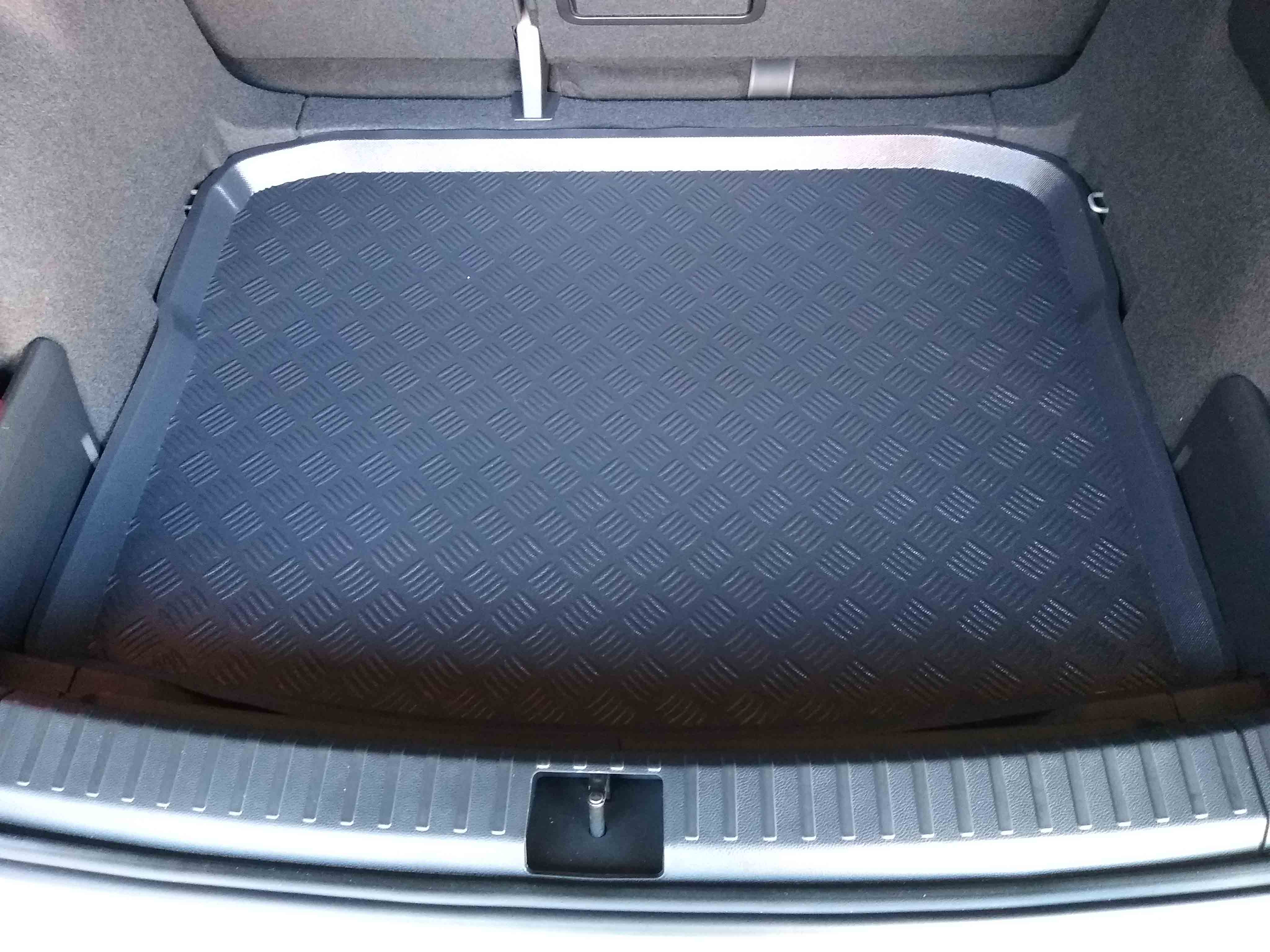

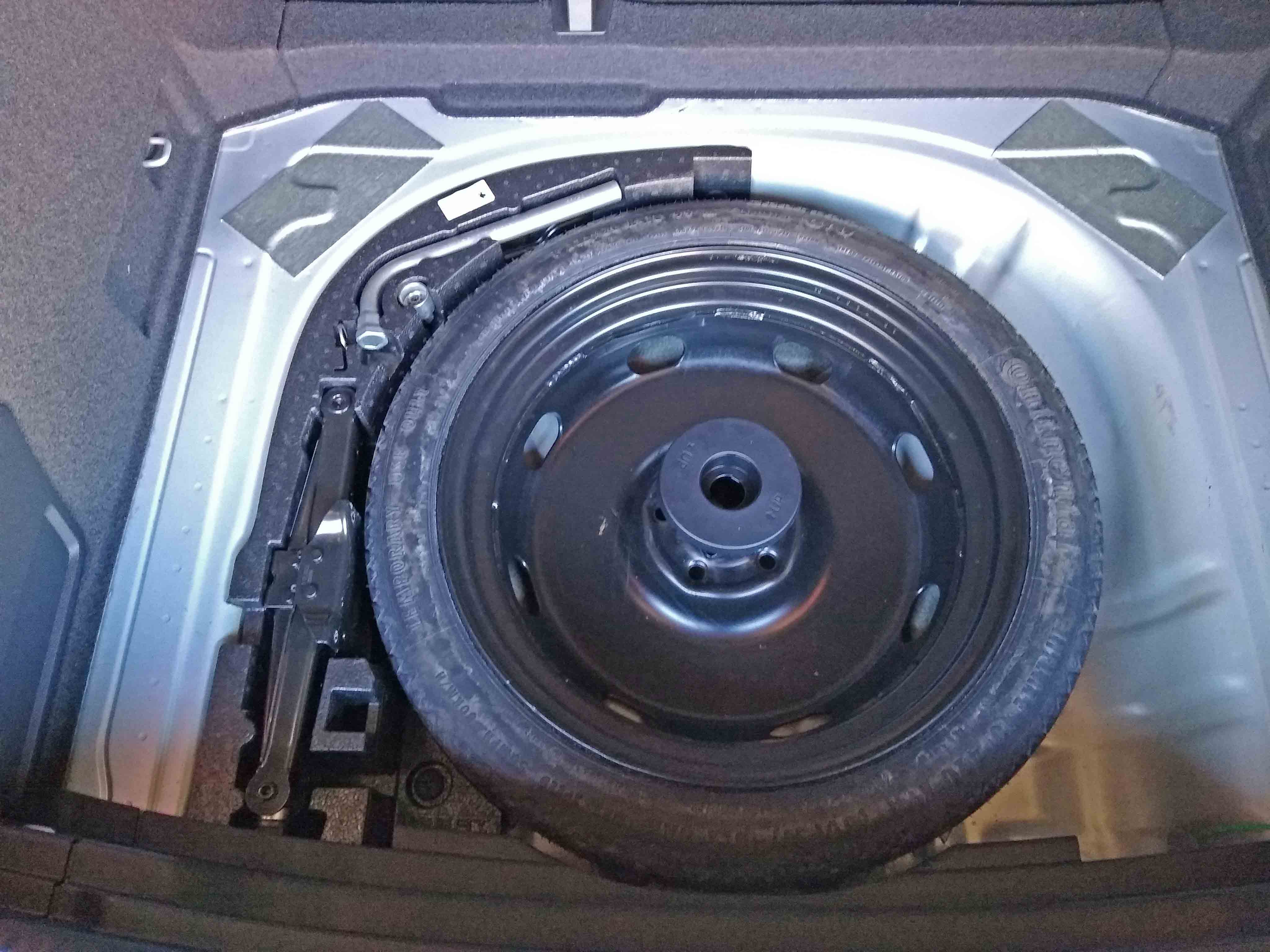

  2. Project update - now complete. In addition to the spacesaver wheel & tyre, I also bought a plastic tray off eBay (described as "tailored heavy duty boot floor liner mat") to provide a hidden compartment. It is arranged as follows: wheel well covered by the loose double-sided rigid mat that came with the car, then the plastic tray and finally the original boot floor - see photos. Given that the plastic tray is not very strong, I may need to put some blocks of wood in it whenever we carry something really heavy in the boot - suitcases etc. It's a pity that the Karoq doesn't come with a variable boot floor as standard as retrofitting appears to be expensive judging by the Kamiq thread on the subject. Many thanks to all who contributed to this Karoq thread and I hope that it proves useful to others.
  3. Many thanks once again Carlston for your invaluable advice. I have tracked down a suitable space-saver wheel/tyre (125/70R18 5x112) on ebay and it should arrive next week. I have also ordered one of those wheel alignment guide tools - I have never come across such a thing before and it is just what I need - every car should have one! Regarding where to put a full size wheel in the event of a puncture, our car is rarely used with more than two people in it so I would just put it in the boot. I always carry a strong plastic groundsheet in the car so would wrap it in that to keep the boot clean. I will provide a further update after installation of the space-saver.

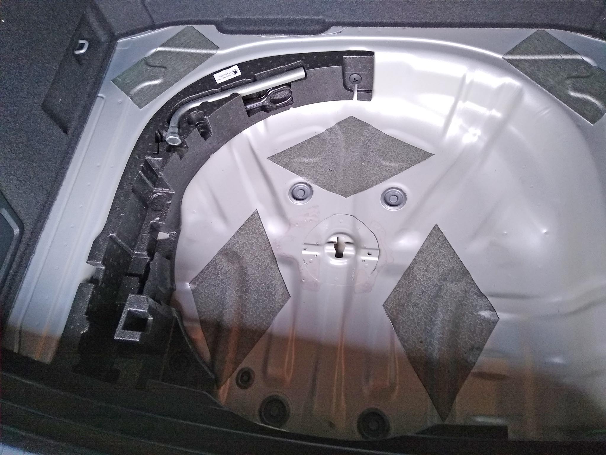

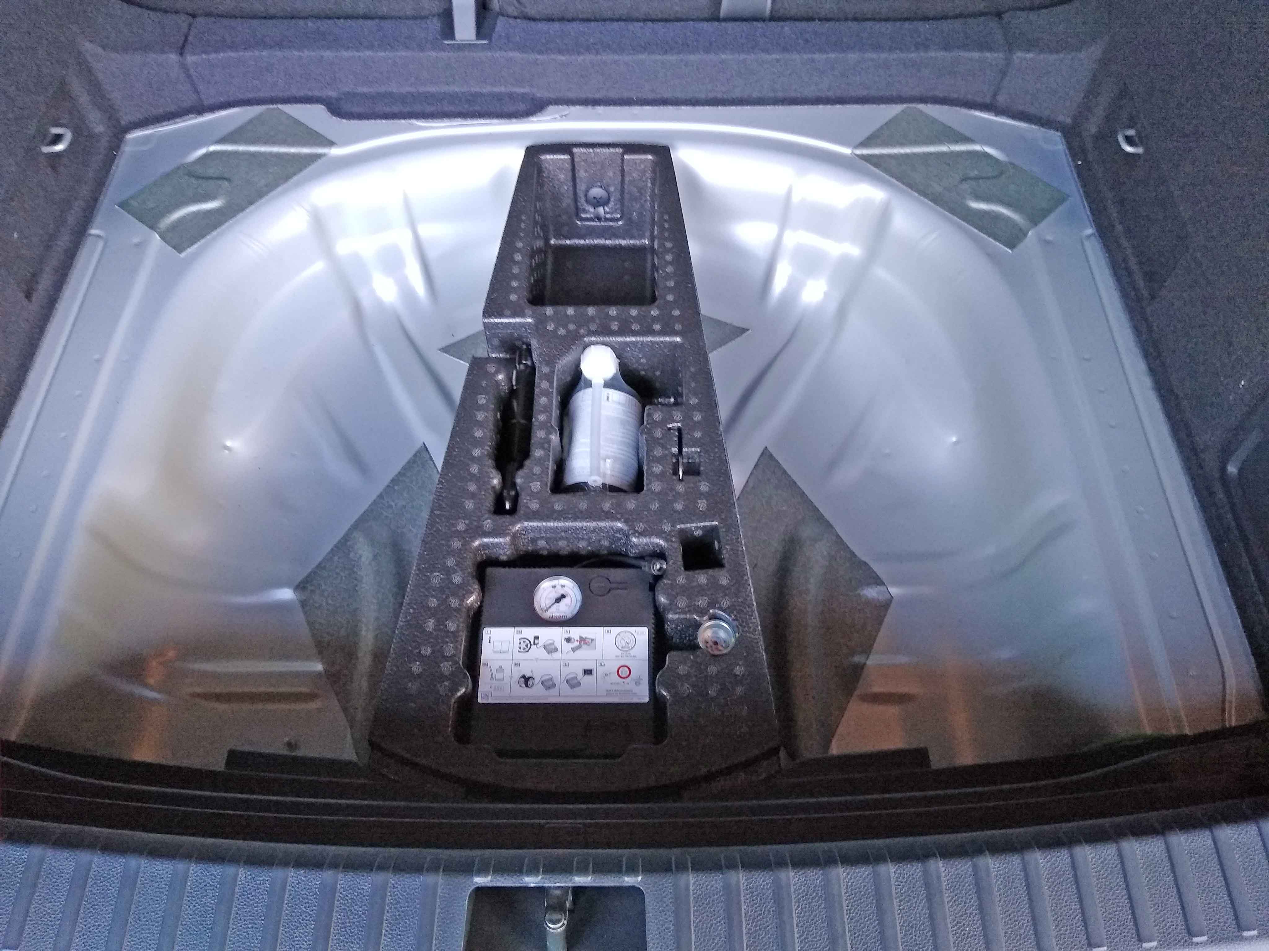

  4. An update on progress on my 2wd Karoq. I bought the polystyrene foam insert and tools kit and installed them without problem -see photos before and after. I then removed one of the road wheels to see if it would fit in the wheel well in the boot - it didn't as the diameter is greater than the space available. The other important thing, for me, is that the 17" wheel and tyre is very heavy. I am not a big burly bloke and I struggled to lift it into the boot for the size test. It was even worse when refitting the wheel and it took me ages to get it in exactly the right position for the bolts to bite. It would be a total nightmare to change a wheel by the roadside in daylight, let alone at night..... This is leading to me thinking that the best option would be to buy a space-saver tyre and wheel as a) it would fit in the boot well properly and b) should be a bit easier to change a wheel if the need ever arises. I just need to know the correct size - is it 125/70 D17 ? Any other thoughts before I go any further? Thanks for all the help so far.
