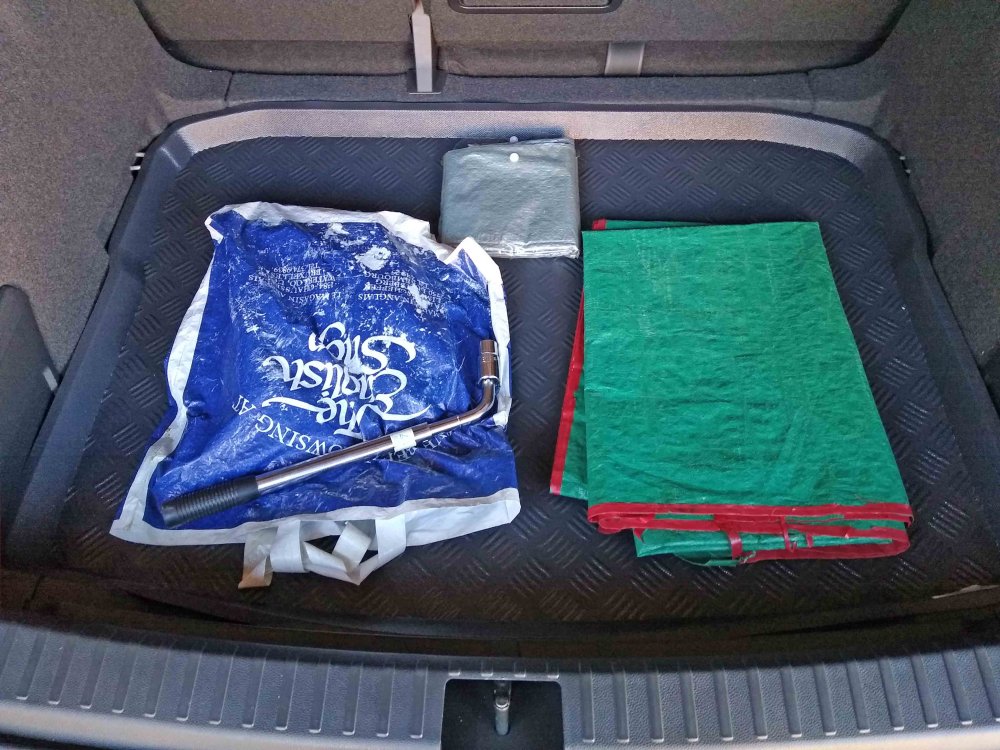

What's the part number of the luggage-compartment floor covering (the one with space saver spare wheel, with which the car was initially equipped) ?
I'm trying to convert from full-size spare wheel to space saver spare wheel :) .
Thanks !

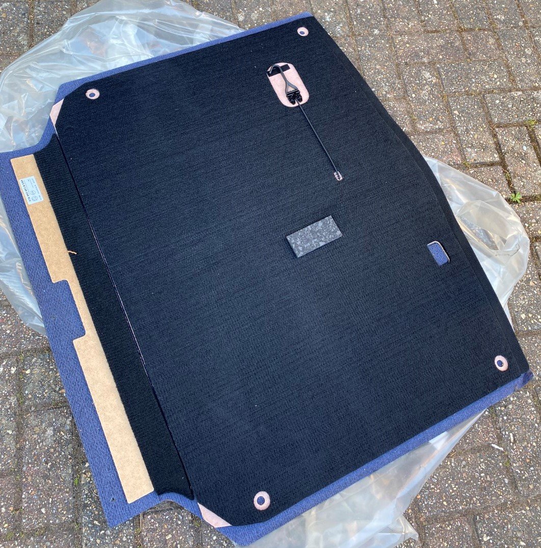

Hi RazvanRotaru.

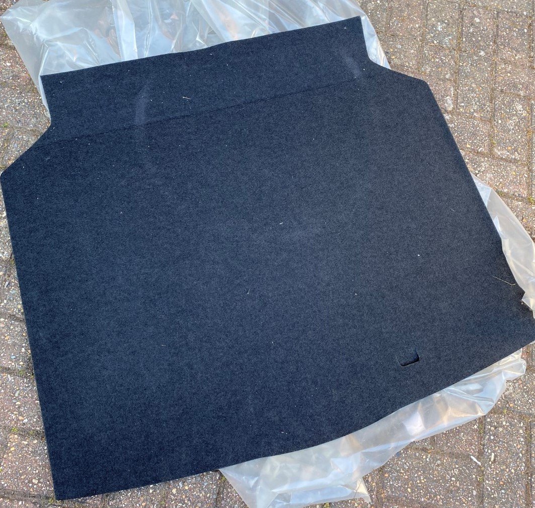

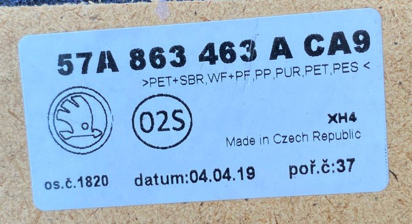

The Skoda part number for the floor covering for the space saver wheel version is 57A 863 463 A CA9.  See photos attached.

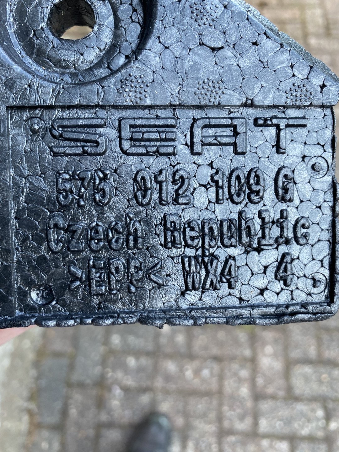

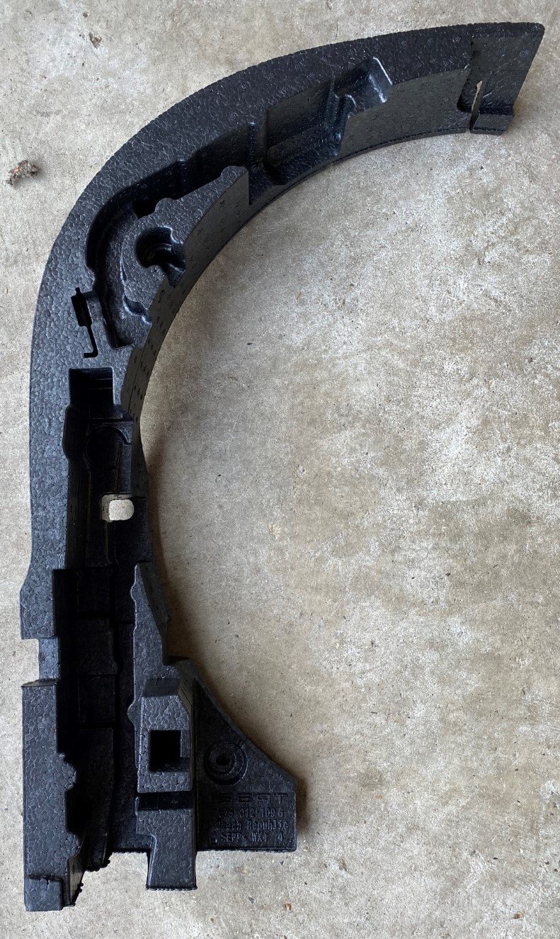

In case you ever need it, the part number for the polystyrene part which goes around the space saver wheel is actually a Seat part number, and it is 575 012 109 G.  See photos attached.

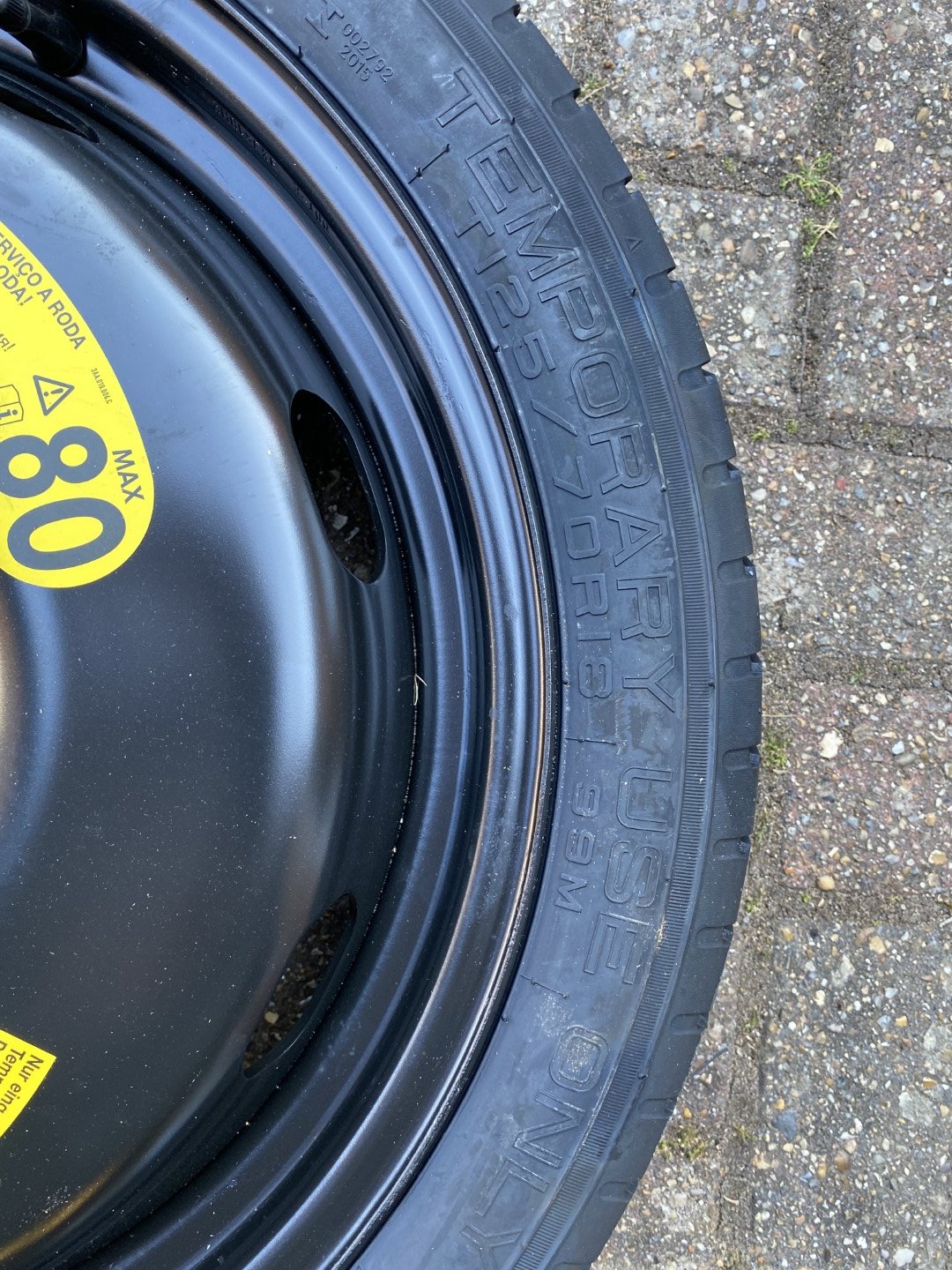

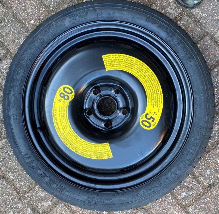

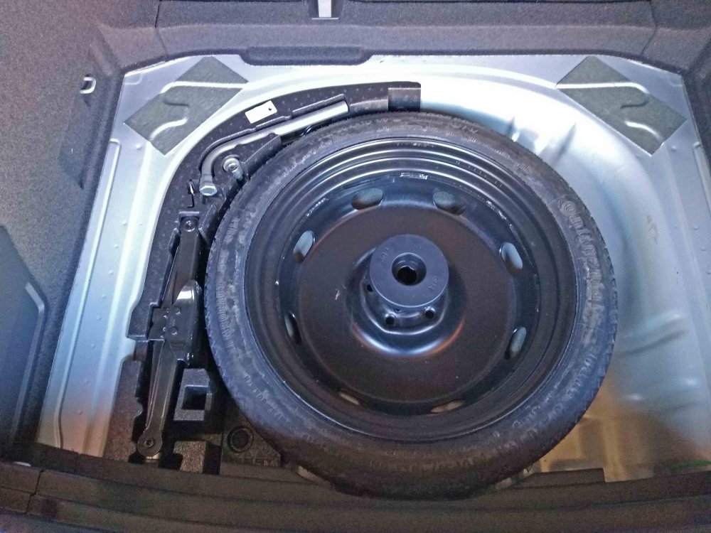

I have also attached some photos of the space saver wheel and tyre.

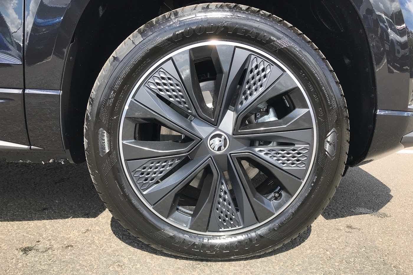

So after all that, I've instead gone for a June 2022 registered Karoq Sportline 2.0 TDI 4x4 all in black (ex-demonstrator, 7500 miles, due to collect in just over a week's time), which comes with these 18" wheels - the dealer is also supplying normal centre caps and bolt covers so I can remove the horrible 'cheese grater' plastic inserts. The Goodyear tyres fitted looked like they were a 225/50 x 18 (hard to read, the size is printed very small on the side of Goodyear tyres).
Anyone know what the name of this style of wheels is (and have any photos of what they look like without the inserts?).
In the boot it already has the kit as described in the first post for the larger spare wheel, but the spare wheel itself is a skinny 125 width thing with a 50mph limit, so I will be wanting to replace the wheel with something I can drive on at normal speeds - the dealer is going to get me a price for matching alloy, but obviously a steel wheel with a suitable tyre would almost certainly be cheaper, but again I'll appreciate any guidance on what would be a good fit, but that would let me drive without a 50mph restriction.
Thanks,
Edited by RallySimon
