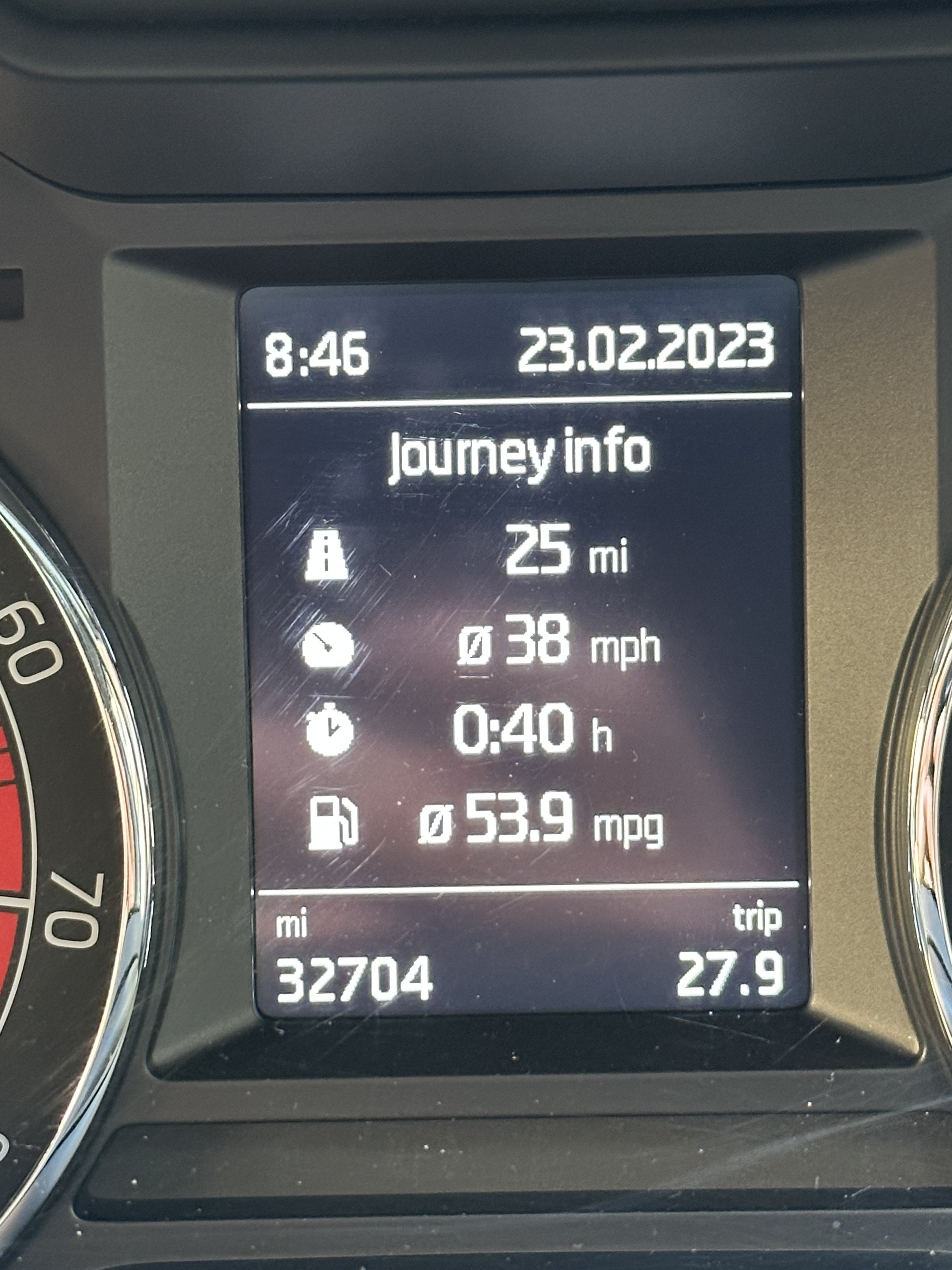

  6. Thanks for you replies. It’s a 2020 1.0 tsi manual with full Skoda history with just under 33k. Well this morning I inspected the air filter and it was absolutely filthy! And it’s obviously the original filter. I changed this myself and after a run got an instant increase in MPG. The air filter change intervals on these seem far to high in my opinion. Oh and I’m not 89 it’s the year I was born 😃 and I did raise the poor MPG with Skoda and got the usual must be your driving style and not DTCs are logged etc etc. You’d think inspecting the air filter would be a basic check and I’m 100% going to be raising this with the service department at my local dealer. Once again thank you all for your comments and input 🤙🏻👌🏻

  8. My Octavia 3 1.0 tsi is getting around 40mpg around town/city driving and about 44mpg on motorway runs. Is it me or is the fuel gauge on this car designed in a way where you can actually see the gauge move slightly? 🤨 I think my mpg is way off what I should be getting after reading through the forums! Or am I paranoid after owning a Megane 3 1.5 dci that returned an amazing 60mpg? Or is something else going on like injector leaking or some other fuel issue, and by the way I’m using E5 right now. Thanks
