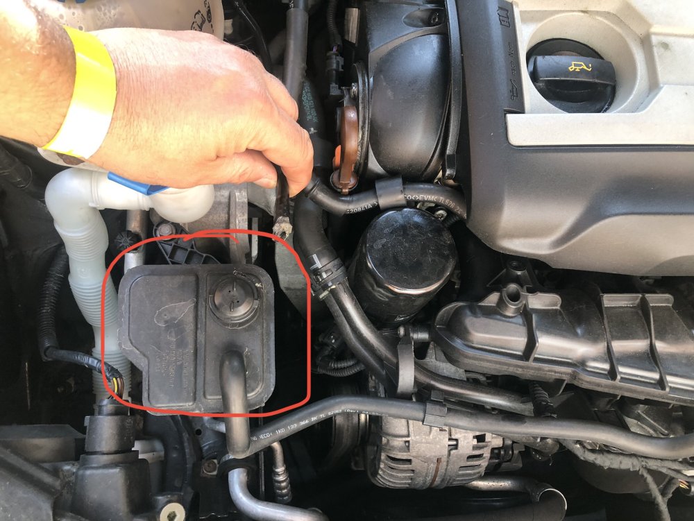

  15. Ok, I've looked up the part number now, and found it's an activated charcoal canister. Clearly I need to replace the broken hose, but should I be replacing the whole thing?
  16. Found the hose on one side had been glued, and has come off at some point. Any idea what it is so I can get a proper replacement? Thanks.
