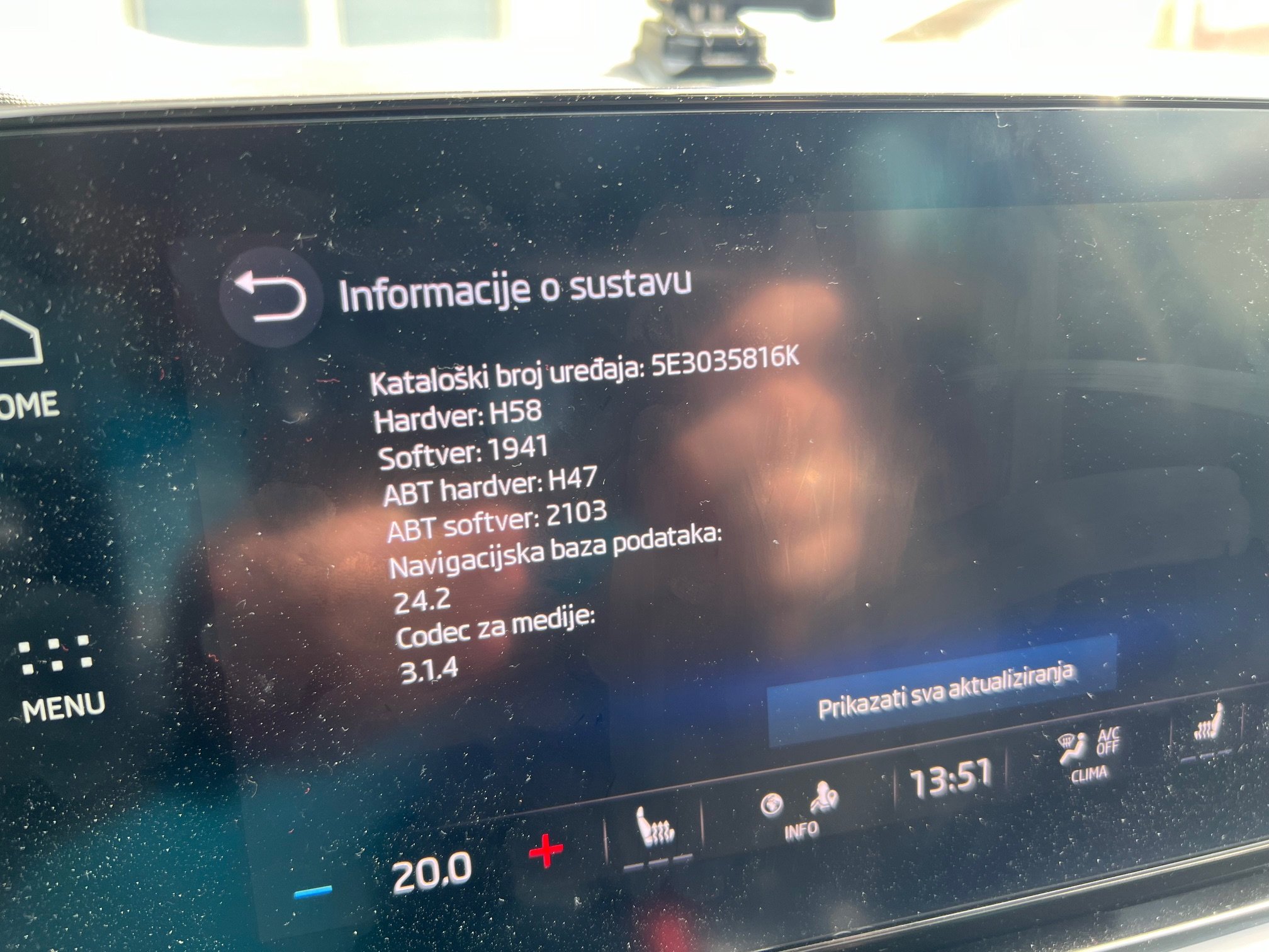

  4. Tnx for reply... I have download package for my country from skoda portal, no luck, because there is no uploading logo from external media. Also from this forum the whole db latest version 1.30.50 , but infotaiment dont give any message Start to update. (i have usb c which is ExFAT and with 7-zip unpacked, i mean conditions as they should be) As I understand if radio dont download logo over DAB/RDS info...no chance to make the infotaiment do it anyhow...also limited function from prior mib-s mine is 5E3035816K just as info for other users to know if they loose some logo, after update, that its not big deal...and i also belive that they will appear or because of radio station, or some OTA...
  5. Also update went normal without any issues, after it, I only noticed that radio station logos for some radiostations that I had in favorite list were missing. And as i understand this will be new adventure to sort out

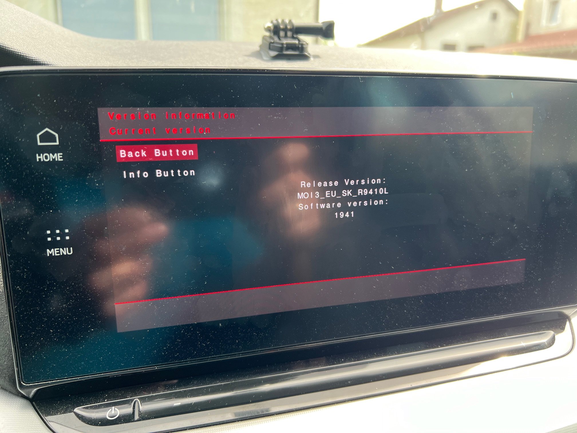

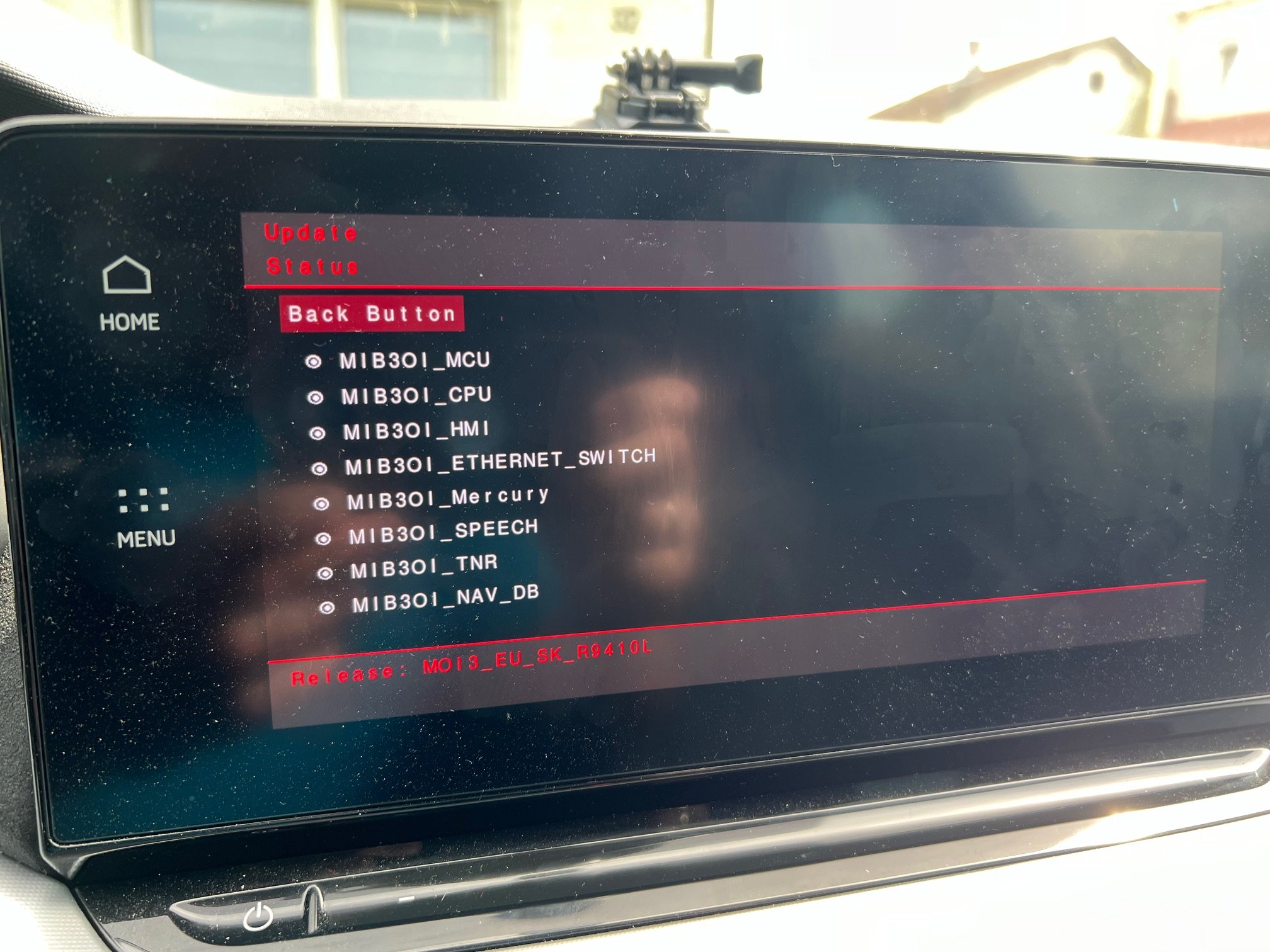

  17. I guess that you have tried to press Power button for more than 10 sec... I dont know did the new sw installed correctly, let say it did, but as you get NOK status, if its applied new files over old files but they did not match...maybe the infotaiment is on some half floating mode, where it cant boot properly, or it cant because the files from update are not matching file system or cant be read, or corrupted.... Hope that 10sec on power button makes some reboot to working mode. Did you try to plug usb back to pc is it readable and do list of files and folders look as before you update the car BR Djadjo
  18. Hi, Can you shutdown the car, lock it to force to power off infotaiment? What was your idea to gain with new update....the guys who update say that they dont see any difference or new stuff... Checksum error means that there is problem with data that its been read from file, so problem can be downloaded file itself, usb drive, bad block on drive. First check file, clean download new, unpack as it needs to be, and be sure that you have decent usb c drive, not some cheap device. If you you use adapter from usb a to usb c it can also be a issue with that... What version was previously installed on infotaiment that worked normal? On your place i would restore to old working version...if this works fine...great, because you have restored functionality of your mmi. Possible you need to upgrade version by version on steps,1-2-3, not from 1 to 3... Mind that not all infotaiment are the same, so be very sure that new update will work on your device hardware. (because it would come OTA by default for your car) i have on octy IV 2023 sw version 1941 and still thinking about wait a little bit to see if the 1969 is issue proof or nest of new bugs...
