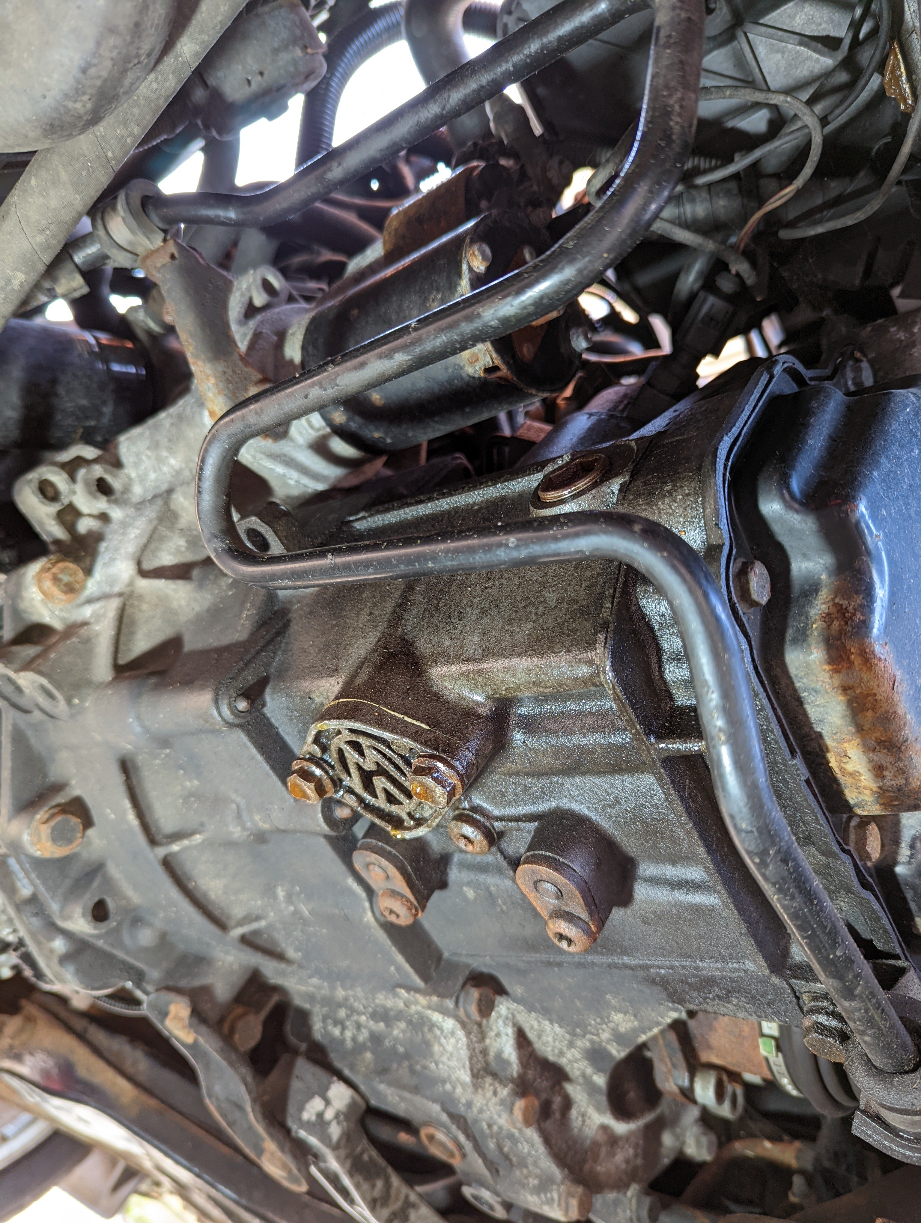

MK1 Octavia vrs gearbox query
a1topdog replied to a1topdog's topic in Skoda Octavia Mk I (1996-2004)
Thanks Mike. Do I need to drain the gearbox oil before pulling the plate off? -
Thanks for the reply 👍🏼 I tried looking at a parts diagram I can't find one showing that plate/cover as a separate part. -
I have a leak on my gearbox and it looks like it's coming from the plate on the bottom that's embossed with the be logo. I removed the 2 bolts but the plate won't budge. I didn't want to force it. Can someone confirm if the plate is removable?
