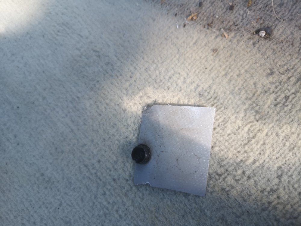

  1. Believe it or not this is my replacement carpet 😂 It was local and cheap and better then the original in my car.

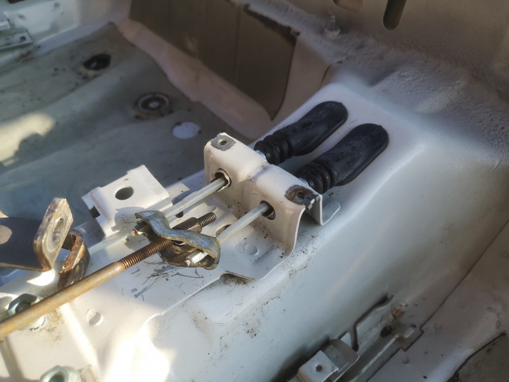

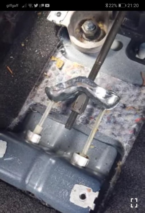

  2. Swapped out the handbrake cable guides for a good used set. Luckily the cables looked to have been replaced fairly recently so pulled out no problems. In a earlier photo I posed a pic showing the the rib on the guides infront of the support bracket inside the car. This was not correct. (I think photo was from a golf). After checking a photo that deanvrs posted I could see the rib sits behind the support, as per my second photo.

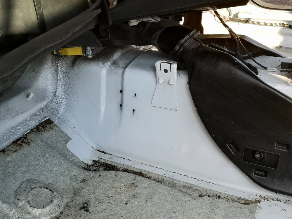

  7. While the arch liners were out I discovered what I think is the mounting point for the siren. I don't believe these two holes in the front n/s chassis leg are factory can anyone confirm?) , also there is a spare white wire cut into the cars horns while would make me think the went to the siren

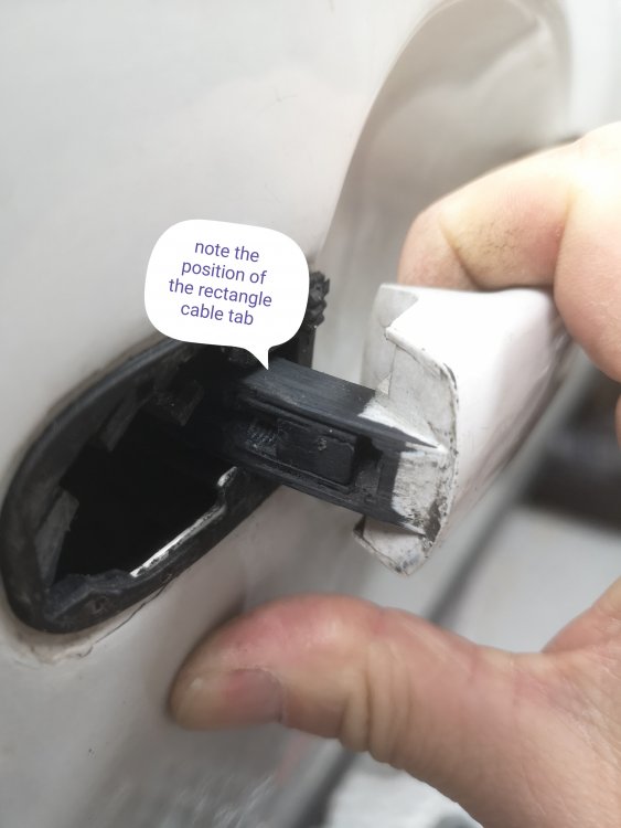

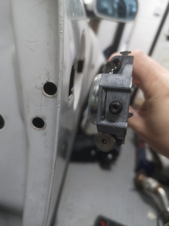

  10. With the cable removed half of the internal mechanism dropped into the door. Somehow it had managed to snap in half. So that was the cause of my problem. You are supposed to be able to slide the outter handle backwards to remove it. I just couldn't do it. As the internal mechanism was broken anyway I just got the Dremel out and cut the metal mechanism. I later realised that the hangle has to be on the closed position to allow it to slide back. These photos show where I had to cut and also the broken mechanism next to its good replacement
  11. One of the many little jobs to sort on the car was the drivers door handle. Sometimes it wouldn't spring back into the closed position. I decided to take the whole handle mechanism out to investigate. The door glass has to be removed first so that you can remove the inside part of the handle mechanism. Next I popped off the two grommets in the side of the door to get to the screws olding in the door lock and retaining ring. These do not need to be remove completely, just wound back a bit. With the lock removed pull the handle open and make a note of the cable position and pop it off.

  13. Just for reference this is what the cable guides should look like

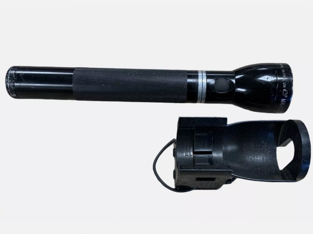

  15. I'm busy researching the cars police history and have been liaising with some officers who remember these from new. They have been invaluable in advising me what equipment it was fitted with. An example of this was a mag light and charger in the passenger footwell. I have found the original mounting point and sourced the correct light and charger.

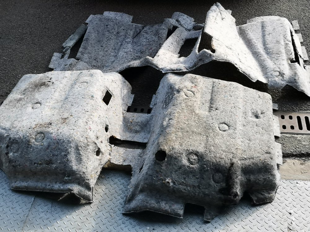

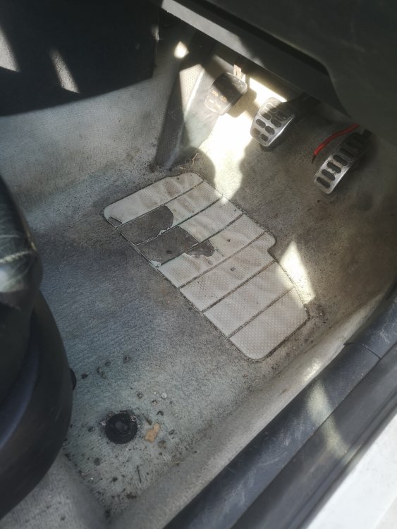

  16. Carpet shot, heal pad worn out, so will source a better example. Cant believe how heavy the underlay is, it must weight 20kgs
  17. As if I didn't have enough to do I discovered the handbrake cable guides have been butchered, leaving rough edges and snagging the cables. I'll have to change both guides.

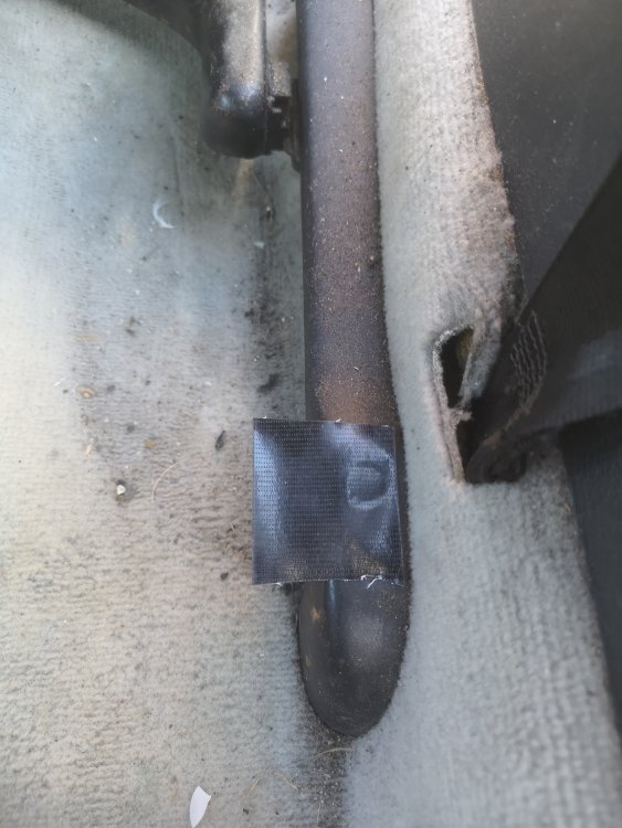

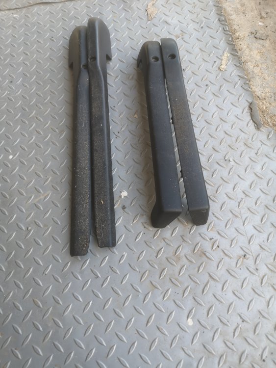

  18. These runner covers give you an idea of the filth. I always use a bit of gaffer tape to remove the plastic bungs over the screws

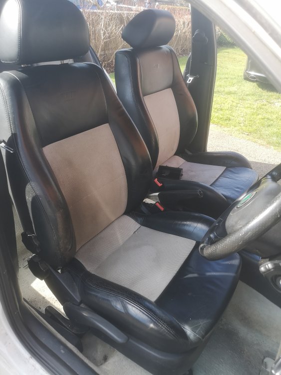

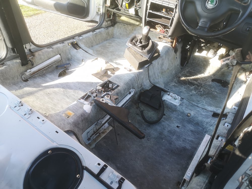

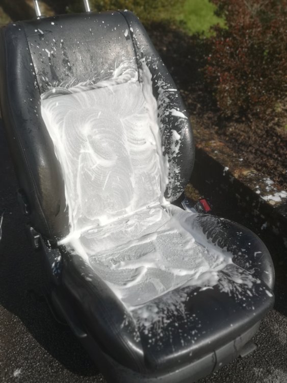

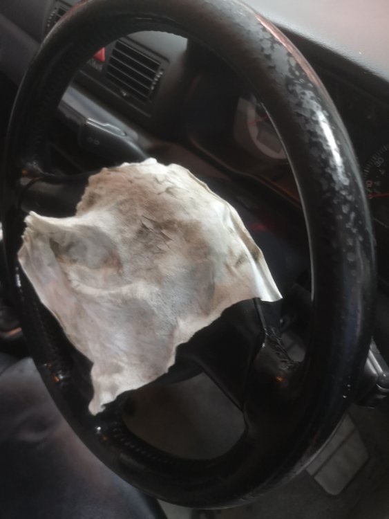

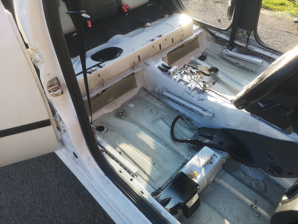

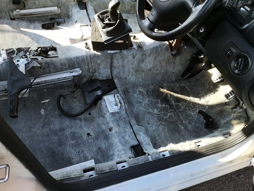

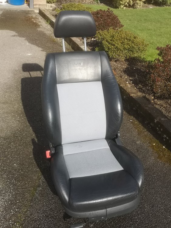

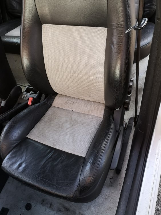

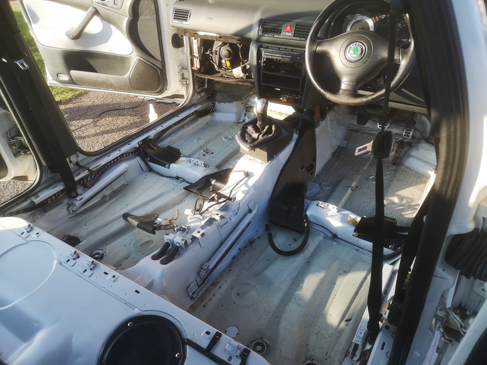

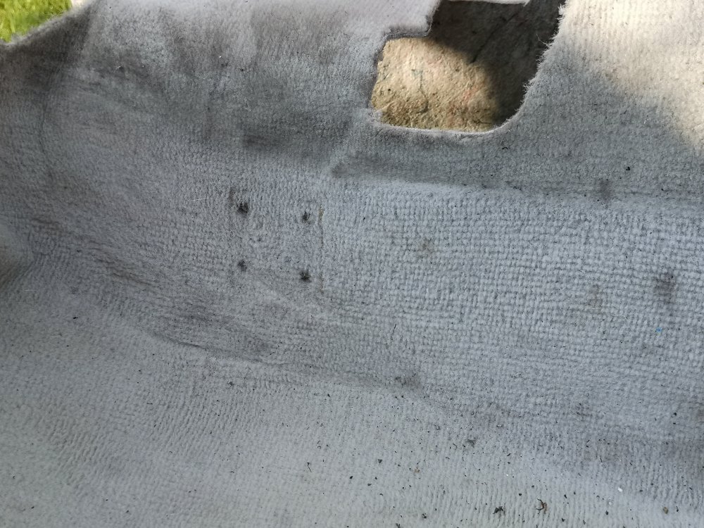

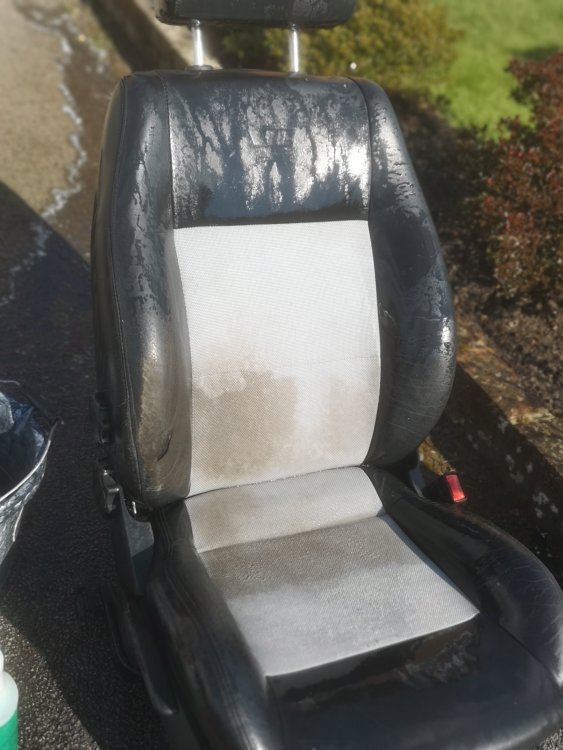

  19. Started the interior decontamination today. Seats out and scrubbed, then removed the carpet and underlay as damp. I will look for replacements so didnt bother cleaning them. The seats not in great condition, but I will look at getting them repaired later. I have a better steering wheel so will swap it, but look at the dirt on the old one 🤮 Some before shots
