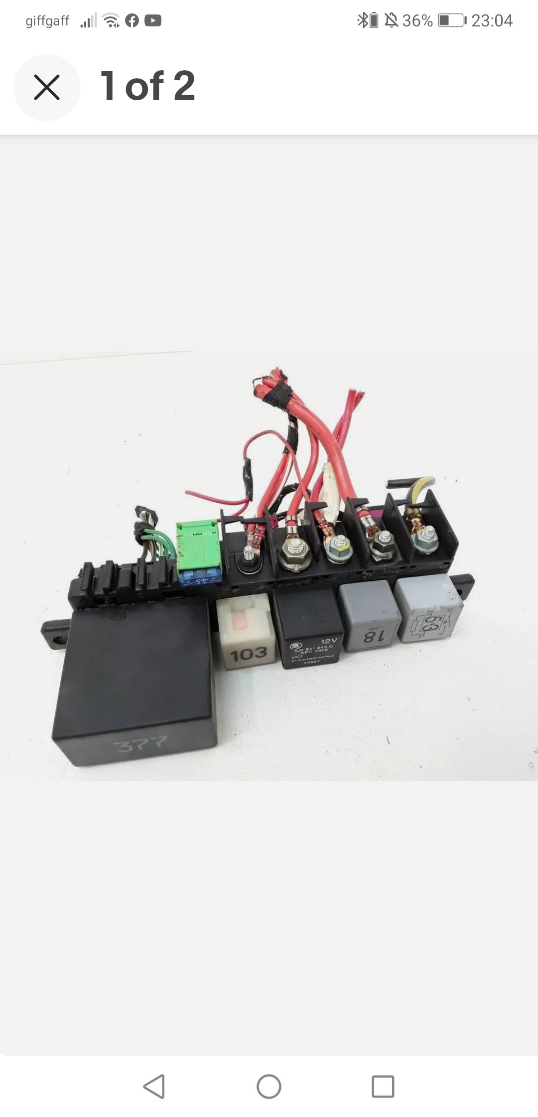

Thanks, I don't have electric seats, so must be for the windows.- What's this fuse for?
What does the fuse in the green holder do, as seen in this photo. It located behind the dash on the drivers side, just above the pedal box. Also what is the correct size fuse for this?- door card fabric bit
